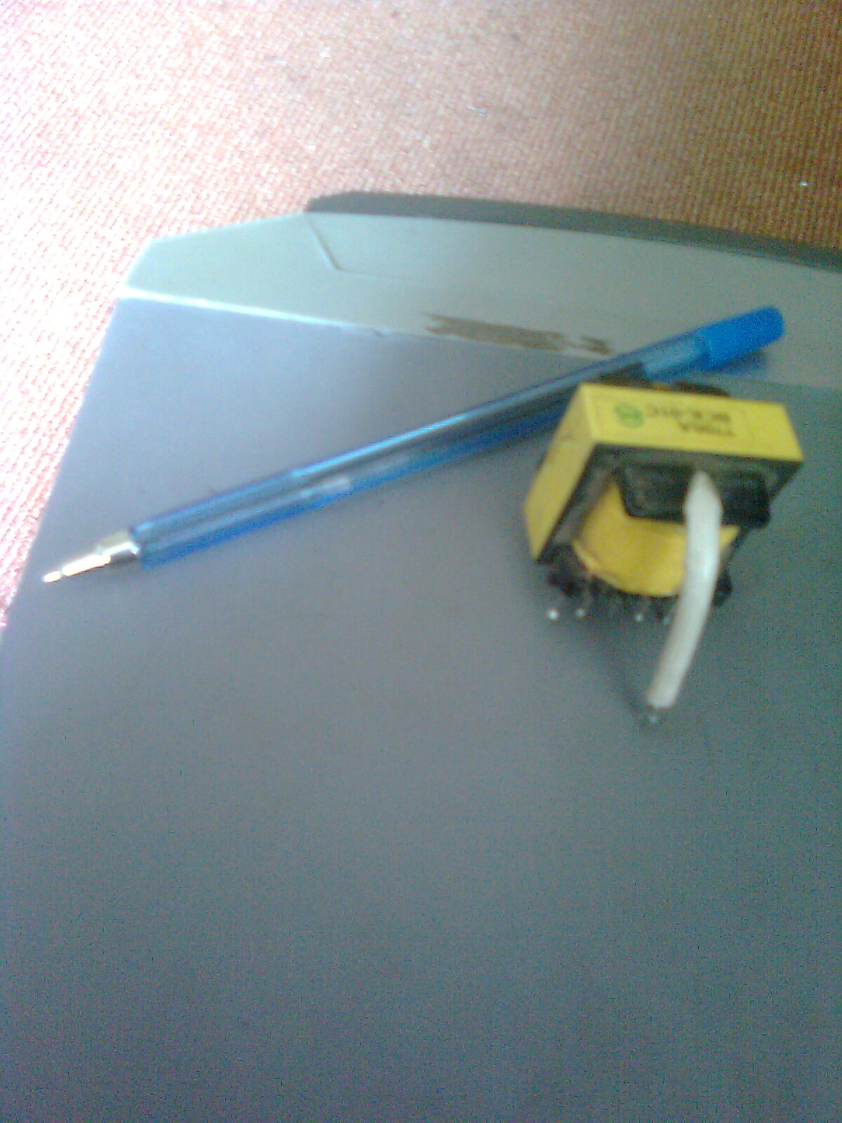

I think I will rewind trafo. I should left primary untouched right? And for secondary count how much windings there were for 12v rail, then use 12*2,7=32,4V. It means that I have to make one centre tapped winding for secondary, and there have to be 2,7X more turns on each "half" then it was before[for 12v rail]

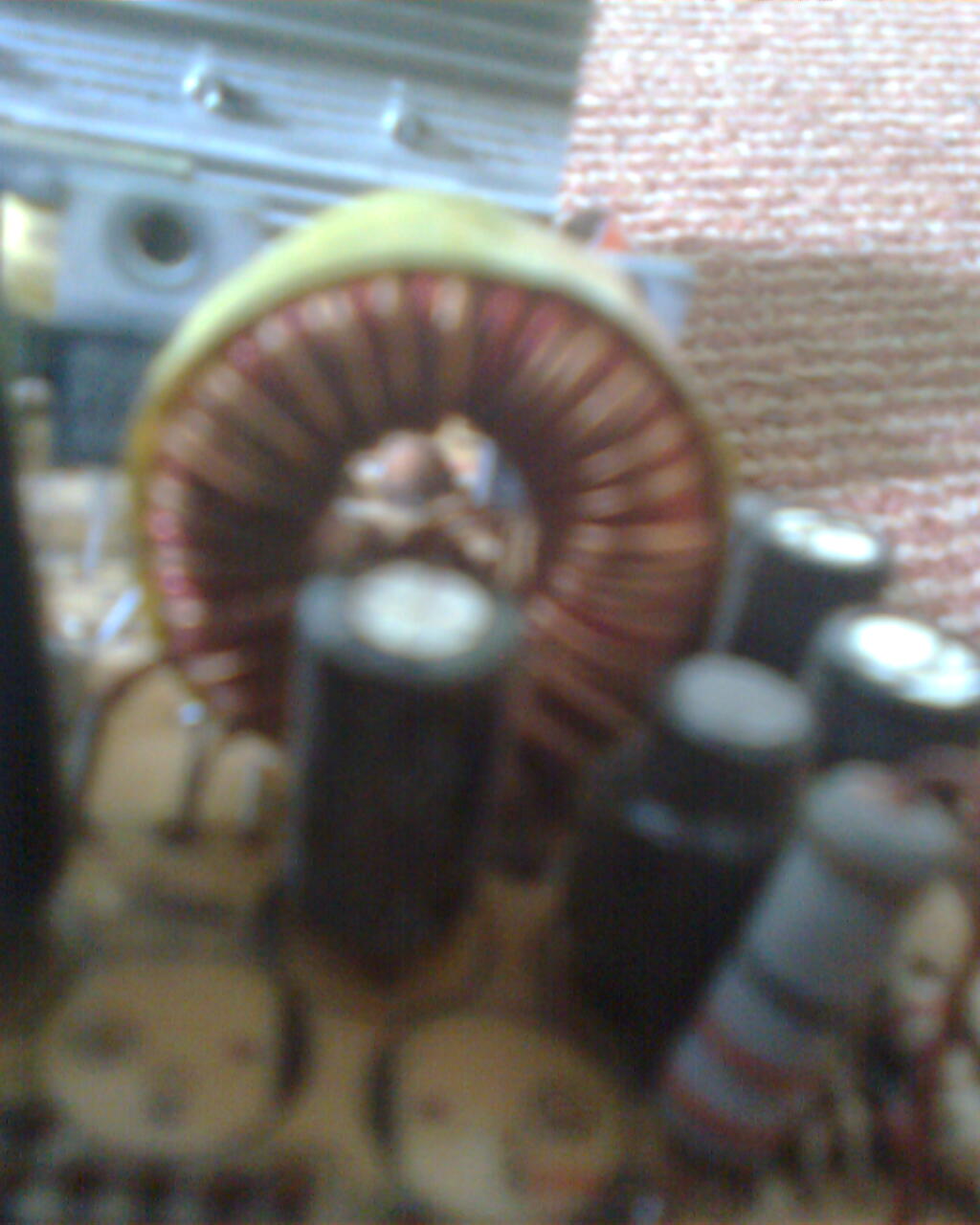

luka: that inductor.. will it be ok if i remove all windings, and will use better wire and the same thing as trafo - previous turns*2,7?

If the inductor is from powder core, I can't substitute it with EE type core? Or maybe this variant: original was yellow-white, but I have some yellow from other, 350W PSU. Maybe this suits for substitution
for primary use same number of turns and how they were put on (1/2+1/2)
for 12v I think you will find 4turns so use so much that you will get 35v or more if you will have regulation... you will need around 11-12 turns for each sec
for inductor, take all of them off, and wind two wire in same direction as many times as it will be needed to core whole core and then some... that you want to make is coupled output inductor
