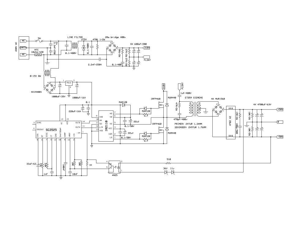

.... So now I have (in concept) 2x 35v and 2x-35V. I want to use two LM338 To regulate output for -30v.
But I am not sure about output inductores. They should be before first caps.
Here are my idea: Rectifier->Inductor->Caps->Regulator->->Joining and - for GND->some more caps
Should I use two,two dual or four inductors?
If you place the inductor (aka "choke") after the rectifier your get a DC voltage about equal to the AC voltage. Placing a cap first gives you a DC voltage of about 1.4 times the AC volts. So the choke input filter looses some voltage but solves the in-rush current problem nicely. What you are proposing is an "LC" filter before the regulator. Using two chokes would create an LCL or LCLC filter. The way to decide which to use is to first know how much ripple voltage you want going into the regulator. o decide on this look at the regulators drop out voltage and make sure none of the bottoms of the ripple will go under that voltage and then apply a "saftey factor" so as not to cut to close. An capastior input filter would give a larger voltage come not even close to dropout voltage but then the regulator will have to drop more voltage and run hotter.
Think about CLCRC, basically using a resistor in place of the second choke. Choose the resistor to drop the voltage to something the regulator can handle easy. a 25W can take some of the heat off the regulator.
Two secondaries not CT,because the LM338 is positive reg, and I dont want to search equivalent 5A negative regulator. So if I have no problems with 1.414x I can bypass these inductors? But how about noises then? I guess traditional RC snubber wont help.

AP2, yes. It is modified pc psu. Regulated with 2 LM388s. For LM4780 or 2xLM3886. Just wondering about output inductors.
I give you my help, but frankly it is not clear.
PC already has the SMPS PWM (for regulation). Why do you want to put a linear regulator at output?
(This will dissipate a lot of power into heat).
it is easier to modify the transformer to obtain the regulated voltage (PWM) you need, I think.
However, if you refer to the filter output can wrap a cylinder ferrite 6mm diameter 30mm long wire with 1.24 mm (get about 10 uH), 220nF before and after the filter (this is p.greco filter).
Or buy one PSU true for audio, perfect for compact LM3886 amplifier, noise-free.🙂
AP2, Thanks for suggestions. So why linear regulators? I want to make another PCB for rectifiers, and disconect smps trafo's secondary from original SMPS board. I dont want to mess up voltages with pwm regulation, so I rewound trafo's secondary for higher voltage at the same 33kHz freq.
I agree, thats a waste of power, but as I have lm388s and heatsinks.. And I want to remove fan from psu but add bigger heatsink to igbts and diodes.

AP2, You mean rewounding trafo? Yes, thats what I want to do. And regulate voltage with tl494s pin1+resistor. Only that HF filter. . LCL? What are the calculation for proper values?
Regards
C-L-C (10uH) 10A: filled all surface of cylinder (6x30)mm.with wire 1,12 mm
this block HF residual in very wide range of spectum. normally not necessary
applied formula.(this refers to suppressor filter (not for replace toroidal block inductance as original in the smps).
For trafo I mean simple modify (not rewind).
Also...for your modify said beefore, toroidal block is not necessary because you use fixed pwm,then only suppressor filter is necessary.

I think it's a good idea, if you use a linear reg. - like you said- it acts like a load for the SMPS unit. I f I got it right your "chain" looks like this(approx.);
SMPS--CLCRC(i.e. as LP-filter)--Lin.Reg---RCR(last res. to gnd)
The last "filter" after your regulation don't need to be "well done", 'cuz if you use big capacitors just before you pull out the regulated voltage and amp's, you increase the risk of blowing up your linear regulator, if it becomes in reverse or short circuit...
So always use twice the current power diode to protect your equipment... Now I'm back on "capacitance multiplier" again, since it's a linear way to regulate and increase the capacitance(for less the €10 you can build a "cap. multi." that is equal to a 1F(!!) capacitor).
I wrote that one could use them with an AB-stages, but then you need to have a "battery" at the output, if the amp switch to B operation or just jump up to twice the power... So you need to have "juice" to feed it with, but a rule of thumb is to not exceed 4700µF, so you're not able to drive a 100W AB-amp with a simple cap. multiplier. To the point... look at some "capacitance multiplier", it might give you ideas. I would probably use a adjustable regulator, like LM317T, and beef up the power with MJ15003 or "the old workhorse" 2N3055(max. 3A 40V per unit, MJ15003 can handle 5A@40V), or a power op-amp like LM12CLK(or plain LM12), it can handle 80W, 50V, and comes in a TO-2 casing with four pins.... LM12 have some very good application hints in the datasheet, and a hookup for volt/amp adj. The drawback is the price, they cost in Europe €30 - €40 each, in China €5 including shipping....
LM317 have a 3A sort, that also comes in a TO-2 casing... and good application hint and diagrams... Active components suppress ripples better the a LC/RC filters does.. LM317T have >80dB noise reduction i.e. But if you use a BJT and feed it with ripples... well you'll get bigger ripples.... trail and error, it can only go wrong 😀
