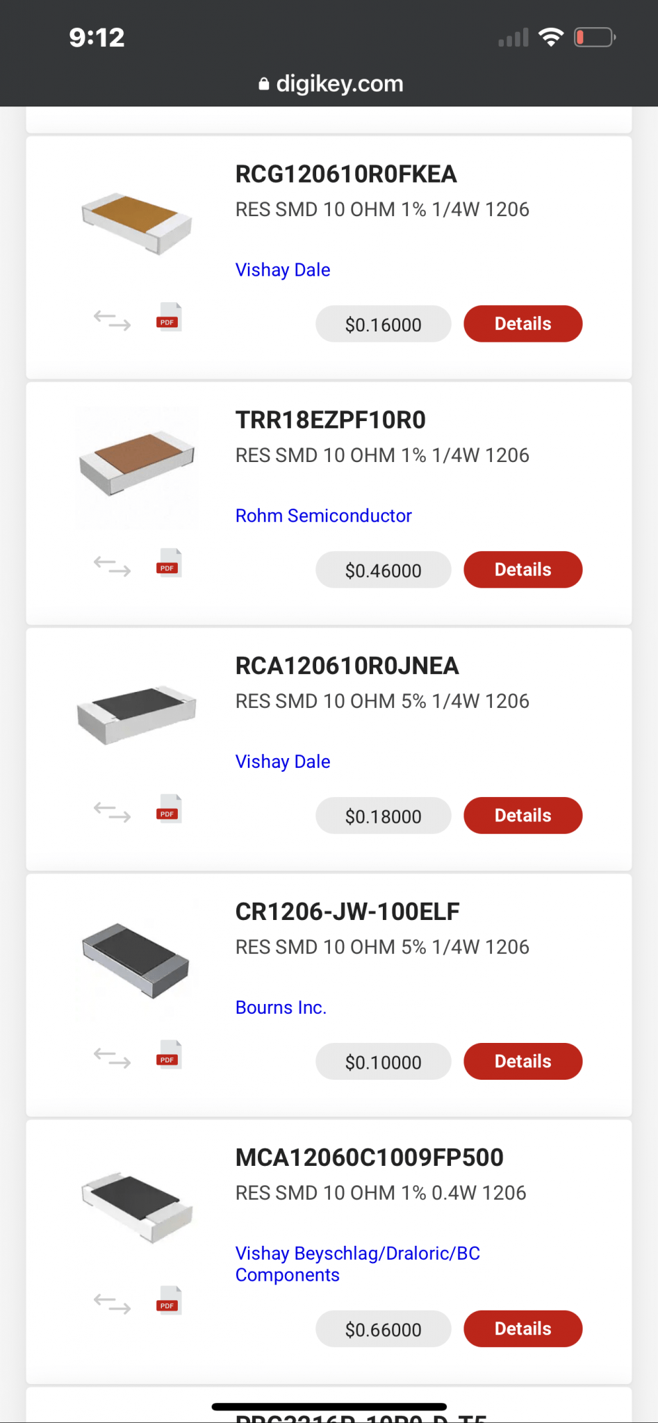

Ok, I’ll check the output mosfet attached to the 100 resistor with no reading, thought I did and it was fine but I’ll double check, the 104 attached to it is reading full value of 100k. And here’s a pic of the digikey SMD 1206 10ohm resistors with diff wattages, maybe I’m not searching right? Searched for “SMD 1206 10 ohm resistor”

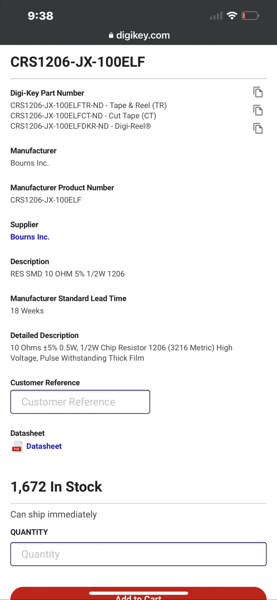

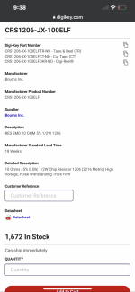

Also in digikey search I just noticed you can search by wattage also, just brought up all the smd 1206 10ohm resistors with .5 wattage. Would this be suitable for specs I want? Everything looks kosher, to a layman anyway 😅 the diagram you posted is showing same output fets and gate resistor ohmage as the amp I’m fixing so I’m assuming the .5 wattage is also what I want.

The power rating is based on the amount of heat that they can withstand and the physical size, which determines the surface area. Virtually all are made of the same basic materials so they can withstand the same maximum temperatures. The same physical size means that they can all dissipate the same amount of heat.
For the way they're being used, a 1206 of any rating will survive.

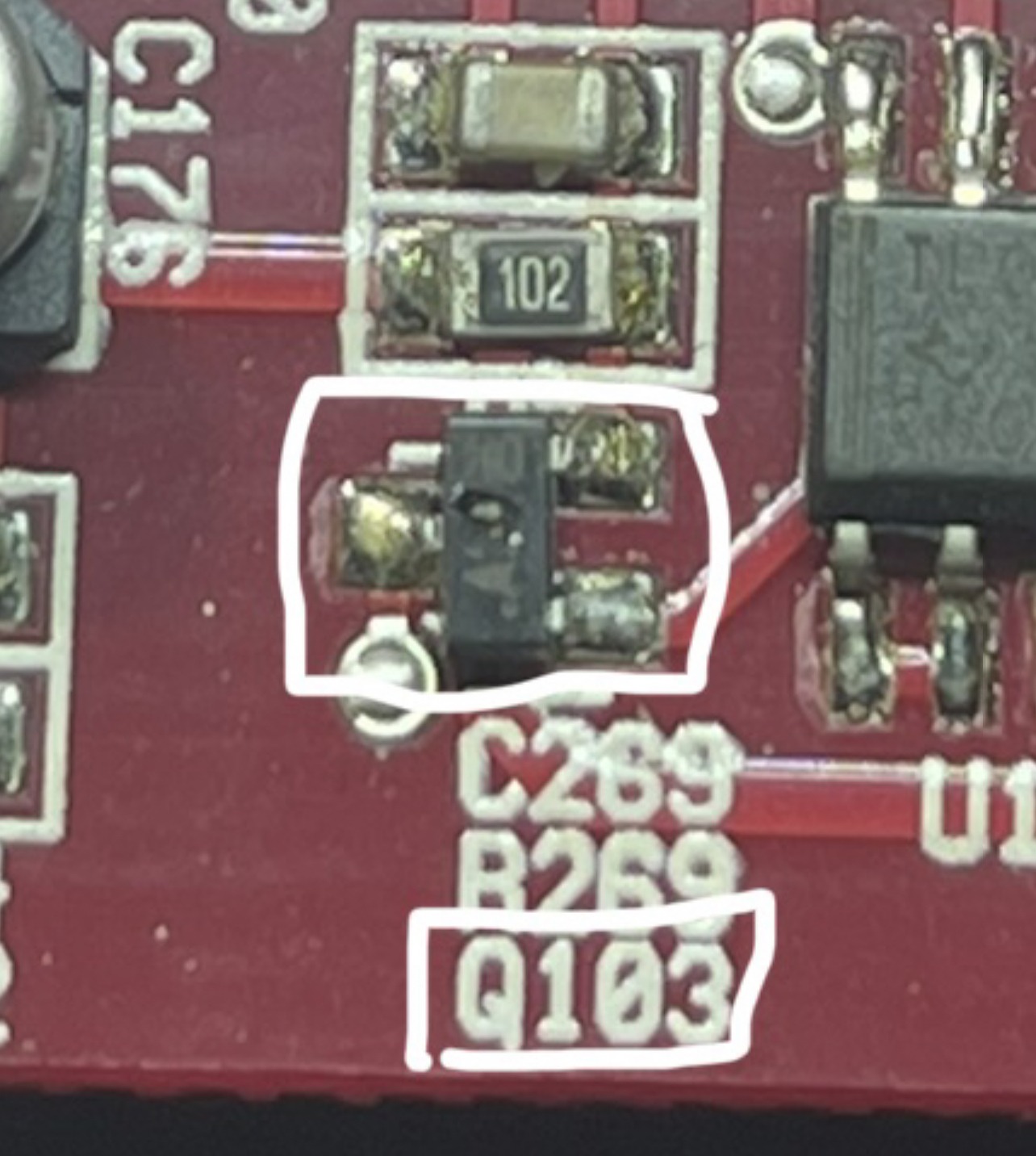

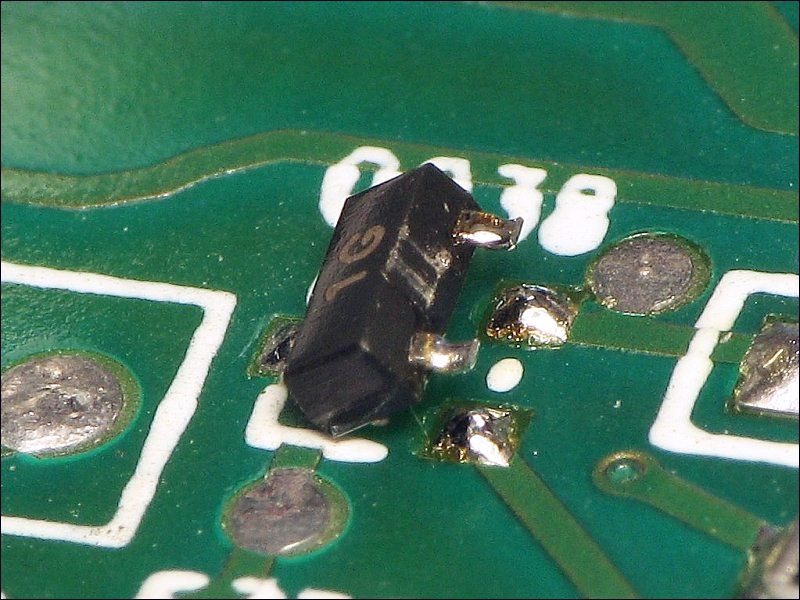

So I’m going through the board and noticed a hole in Q103, Q100 looks to be same type (markings ASG DH?) regardless what leg I touch to what leg with my DMM in beep mode it shouldn’t go off correct? I was watching a repair video of same exact amp with same problem and Q05 & Q11 had a hole in them on his amp, so I tested mine and Q05 didn’t set off my diode tester but Q11 did when I touched both the legs on same side, assuming it’s bad? Q103 (one with hole) beeped when I touched the single leg on on side to bottom leg of double legged side, Q100 did not beep at all regardless what leg I touched to what leg) going through board for other physically damaged looking parts. What type of component are each of these? They look the same just diff markings and diff sizes, ty for any additional help 🙂

Great info at the beginning of this thread, going to check links, etc and use that info as well, this is becoming THE goto page for repairing zx 750.1 Power Supply side lol 🙂
Malak debating changing the good gate resistors on the PS side from 100 to 47 ohm ...must be a reason they changed it, recommended while in at it anyway? Going to start probing everything for shorts near the bad ones I found in pics above. Ty for all your help Perry 🦾
