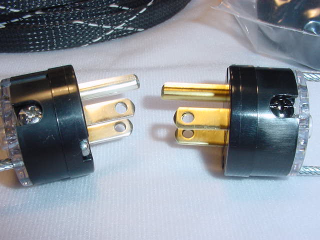

I'm not asking for donations so why would anyone care about the cost?
As for gold plated mains plugs. If you want the best sound then you need to silver plate them.
Here's one plated and one still gold.

I think Tom is making a point for the many many Noobs that surf this forum long before they build.
I don't think he was criticizing you. Everyone has the right to spend or do whatever he thinks might improve the sound.
