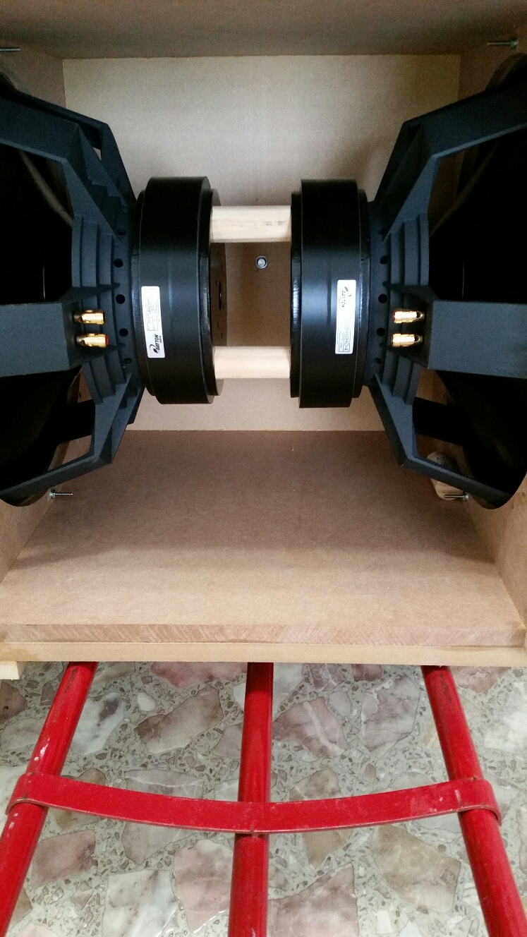

... use of a vibration-canceling mounting technique, where by each action is canceled by an equal and opposite reaction.

Most OB fans seems to enjoy the "boxless" sound, but to me, the notes never fully develop. I really don't want to go any further into this, because my own
personal tastes and observations about OB design, are usually met with some degree of hostility. As has been mentioned previously, 2 watts operating power for an OB is really not realizable. In comparison though, 2 watts for horn loaded mid bass is almost enough.
The attached picture shows one of the possible mounting schemes for what I was describing. This picture DOES NOT show the complete bass system, just the mounting scheme.
