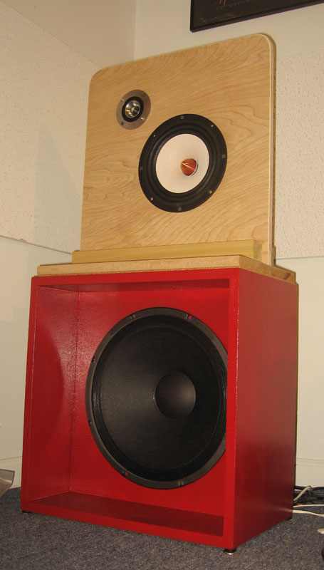

I started with a very crude (drywall!) JE Labs style OB and through on some drivers from an old Grundig console. WOW!!!
Next, I cut on old solid door in half and made another JE Labs style OB. This time I found much larger drivers from an old RCA console. Wow all over again!!! Bass, percussion (particularly tympani) even better. But, not as well balanced are natural sounding in the highs as the first OB experiment. I tried some driver mods out. A learning experience. Did both some good and bad. I have no idea just what these drivers (specs) are. I just had hope that they would work because the consoles they came out of were not sealed in the back.
Anyway, I want to try another diy OB that will be better than the first two. Honestly, I think I will have to wait to do the really "good" (expensive) stuff that I would really like to try (Lowther drivers etc.).
Prior to posting on Audio Circle, I was thinking along the lines of a better (materials) JE labs with a "better" driver. I had considered the Audio Nirvana 15" alnico as one candidate.
I am close to choosing the more economical Hestia project of the two Hestia OB projects that were suggested to me over at AC.
I am also thinking however, about Godzilla's various inexpensive drivers over an H frame with an Eminence 15A in it.
Apparently those doing two way OBs are bi amping. Unless it is advisable to employ my Cary in bass duties, using passive filtering and attenuation etc., it looks like I should get an inexpensive plate amp instead. Would 100 watts be enough? Better to use one 300W plate amp, or two 100W ones? Recommendations?
Obviously, the driver(s) powered by my 45 SET amp need to be pretty efficient. Is there an OB suitable driver out there that is sufficiently efficient, with a decent frequency response, that does not cost an arm and a leg?
Realizing that everything is a trade off, do you guys recommend an inexpensive two or three way, over spending the same amount of money on some one pair of drivers, and putting them in another JE Labs baffle?
I am anxious to build a pair of OB speakers that are meant to be more than a mere experiment, but will still need to keep the budget low for now. I would hope to improve on my last two experiments. I guess I just want to get the "biggest bang" for my buck. Maybe you guys can keep me from trying something that you have already tried that you didn't like so much.

Hi, you need big membranes and little magnets, meaning high Q.
The "game" consists in having the drivers "controlled" by the crossover but easily driven by a SE amp. Making the sub as a specialized way (...active) just lifts the amp from the hard job.
Many big woofers from cheap speakers of the 70's and 80's just look for big membrane and little magnet ( the price should be around 20-50 $ for the pair )
Or you can just pull out all the speakers ( even if mid and tweeters are pseudo-fake, I mean, just there with a resistor and a capacitor ) and mount them on a baffle.

Low power, Inexpensive and Open Baffle. I hope you realize that these three things do not go together.
OB bass is very inefficient, unless you start with a very efficient (expensive) driver. Then it will be just moderately inefficient.
Yes, you can use a plate amp on the bass section, that can work well. You need horns to use a 45 SET well.

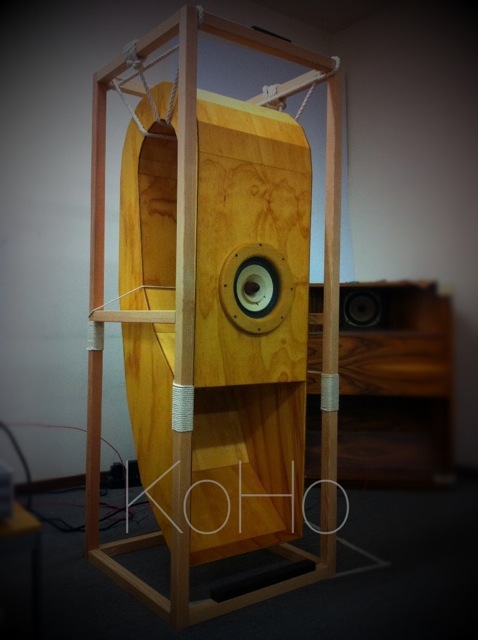

A good back loaded horn (BLH) speaker is very efficient at creating bass from the rear membrane energy so that you get bass out of a small full range driver. The Zen Acousta is not a "flat" response speaker as it uses Lowther and BLH's tend to not be flat. However, they generate a big warm rich sound. They sound very nice and this is an extremely large horn. There are other BLH designs, like the FHXL, FH3, BIB, and many from Scottmoose (look at Woden Design), and HM's website. When you don't have a lot of watts, a high sensitivity driver plus a BLH can actually get loud. 1watt into a 97dB Lowther is uncomfortably loud. The horn will get you bass down to about 55 to 60Hz at circa the same SPL as the upper range.
