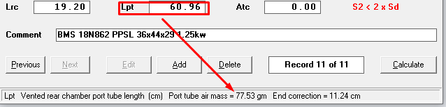

Thx BP1, hadn't caught on to that yet.Put the cursor in the Lpt field to see the box tuning at the bottom of the HR input screen.
I've always found Helmholtz with the Loudspeaker Wizard, looking at the Chamber.
The HR 55.20 version I'm using shows Helmholtz when cursor is on Ap.
On Lpt, cursor gives 'Port tube air mass', and "End correction" in cm. What is end correction?

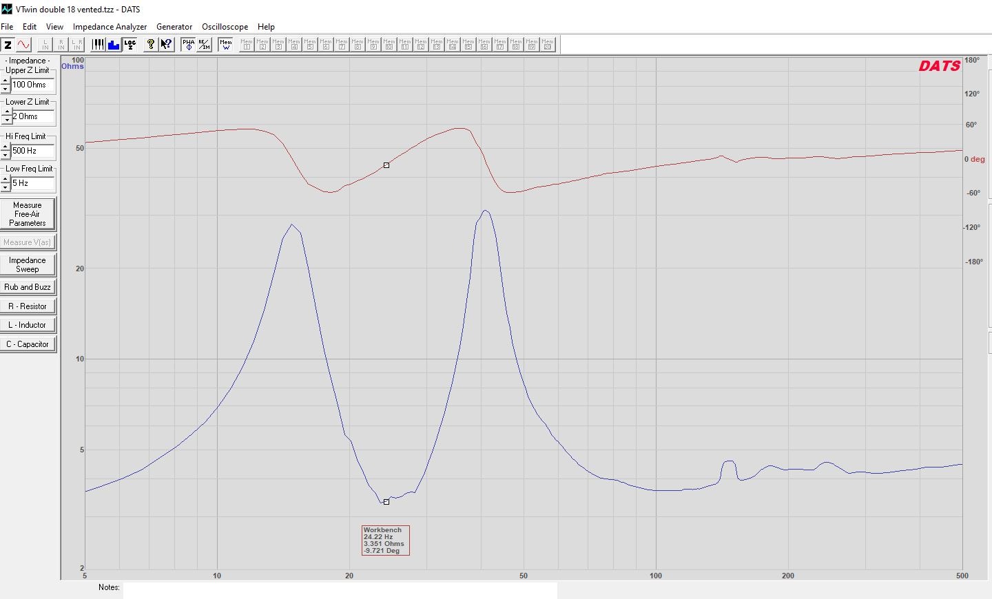

Hey Art, Here's an impedance sweep.
I'd call it about 24-26Hz minima.
A little roughness in the trace at the bottom, no doubt due to the bracing I tried to get in as close to the port to help with back wall stiffness, hopefully without affecting port flow too much.
Time to stress her and find out.
The port is built like a tank. Separate drop in assy that weighs almost 23 lbs.
I've become half-convinced a lot of port noise we attribute to high velocity air flow / chuffing, may well be just the damn thing resonating/rattling at high SPL.
Plus the port assy helped with bracing...I've never tried to brace one near this well before.

Actually you hover over the Lrc ,Vrc or Ap field but not the Lpt fieldPut the cursor in the Lpt field to see the box tuning at the bottom of the HR input screen.
Lpt gives you the below
I know. I was on my phone when I typed it. I knew it was either Ap or Lpt. LOGIC made me think it was the Length of the PorT since you determine the diameter of the port 1st then the length to get to the frequency number. This situation is another reason why I wish HR was an app.Actually you hover over the Lrc ,Vrc or Ap field but not the Lpt field
