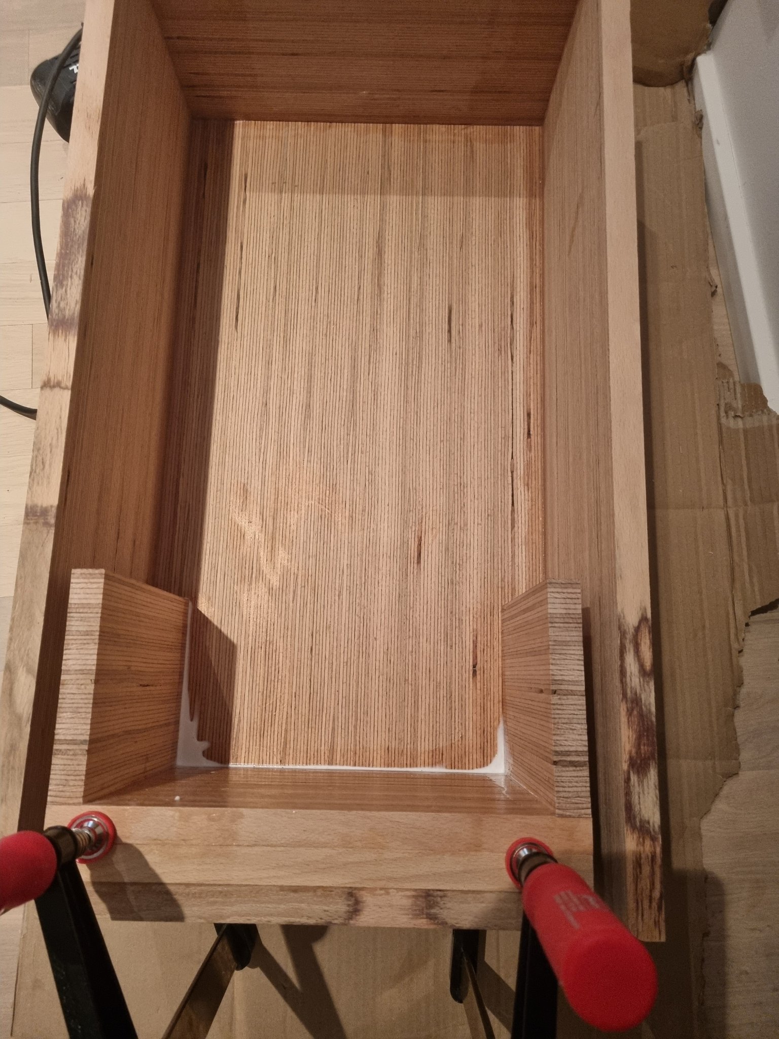

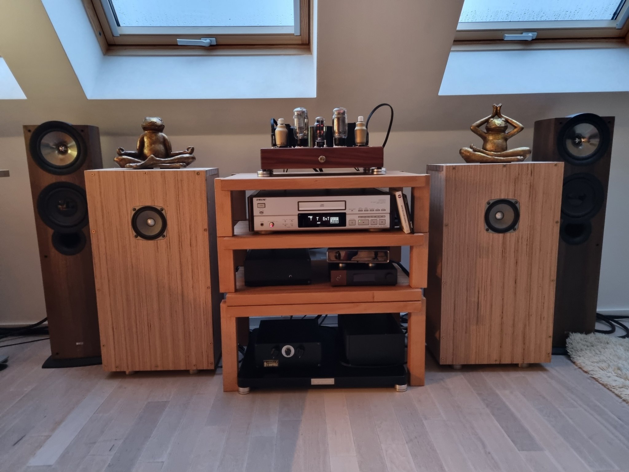

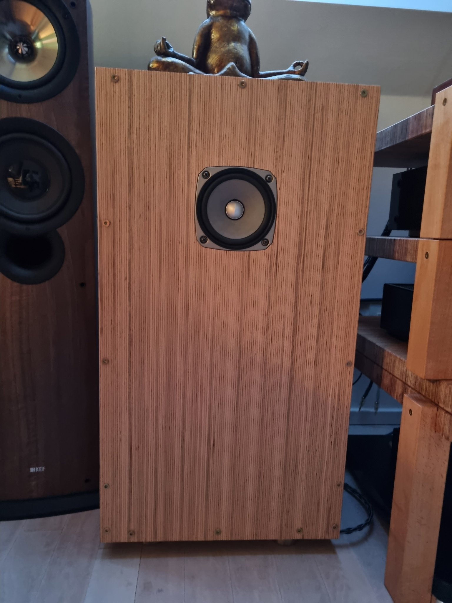

I've built the Le Petit with FE103NV2 and now Janos La Grande with FF125WK.
I'm a newbie in DiY speakers, but would say I dove have some decent (commercial) chains at home for serious comparison.
La Grande (slotport):
  • Tested with my lovely 2x13Watt PX4 Tube Amp, Quad 405-2 stereo fully custom with Kaneda PreAmp
  • I'm very, very impressed - soundstage is astonishing, of course not a bass monster, but still
  • Le Petit is in my opinion more nearfield and you need to sit in the spot (have listened two 2 different FE103 / FE103NV2)
  • Le Grande is the opposite, sitting in my other living room and still you can enjoy listening music from other room
.. yes, I do have in my main chain a quite decent highend (for my budget) system and still couldnt believe how good this cabinet can play.
Electro, Jazz, Classical...

1. I'd NO experience with full range speaker before & always owned some 2-3-way speakers (horn, bass-reflex - listened at retailer to Cube Audio and Pearl Accoustics)
2. Those speakers are special and not a replacement for the average mass-consumer 3-way or bookshelf speakers
Le Petit: (FE103/FE103NV2)
  • you'll be surprised how precise (high/mid) it plays
  • Bass is limited, but still better than average (unmodified) bookshelf (don't forget NO crossover - pure chassis + cabinet design)
  • You should play around with bass reflex pipe (don't mount it fix, play around with it, makes a difference, depending on your room)
Le Grande: (FF125WK)
  • Much bigger soundstage (of course cabinet is bigger)
  • Slot port instead of bass-reflex, therefore in my case with putting them closer to the floor, low frequencies are surprisingly good
  • Speaker cable (Kimber 8VS) directly solded, spades are from WBT
  • They are different and if you try to start to build, I'd recommend to go with Le Grande if you are looking for a fully-fledged speaker.
  • Le Petit is still pretty good (I'd not go too crazy as people describe, what's the best Fostex/Tang Band etc for it, start simple & stick with the dimensions)
  • In my opinion, they amp-matching, if you have tube amps and 6-8Watt per channel is enough - for average listening (they are not high efficiency ;-) My PX4 with 2x13Watt is pretty perfect match. Quad/Kaneda way overkill
Hope this helps
Gerald

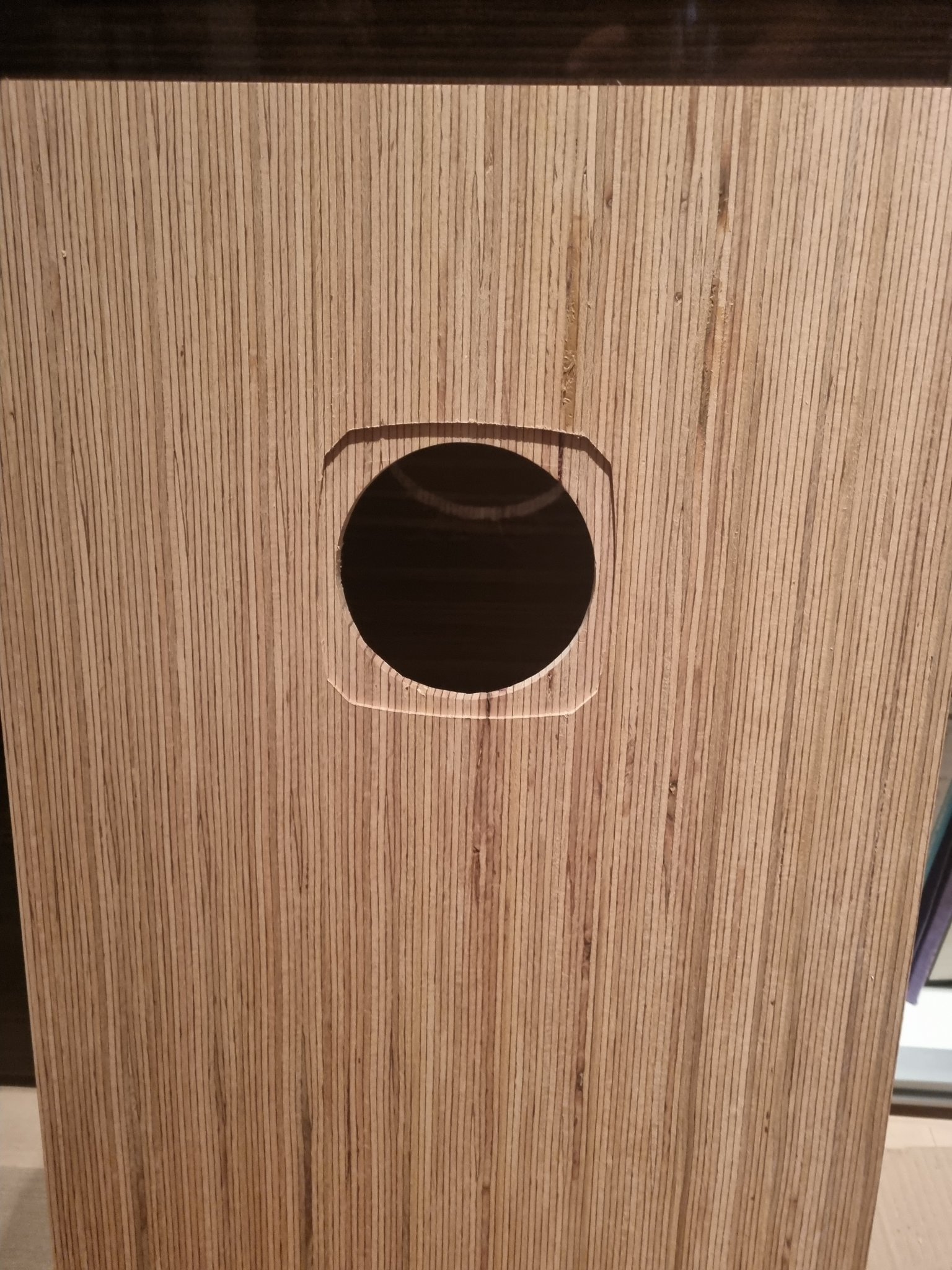

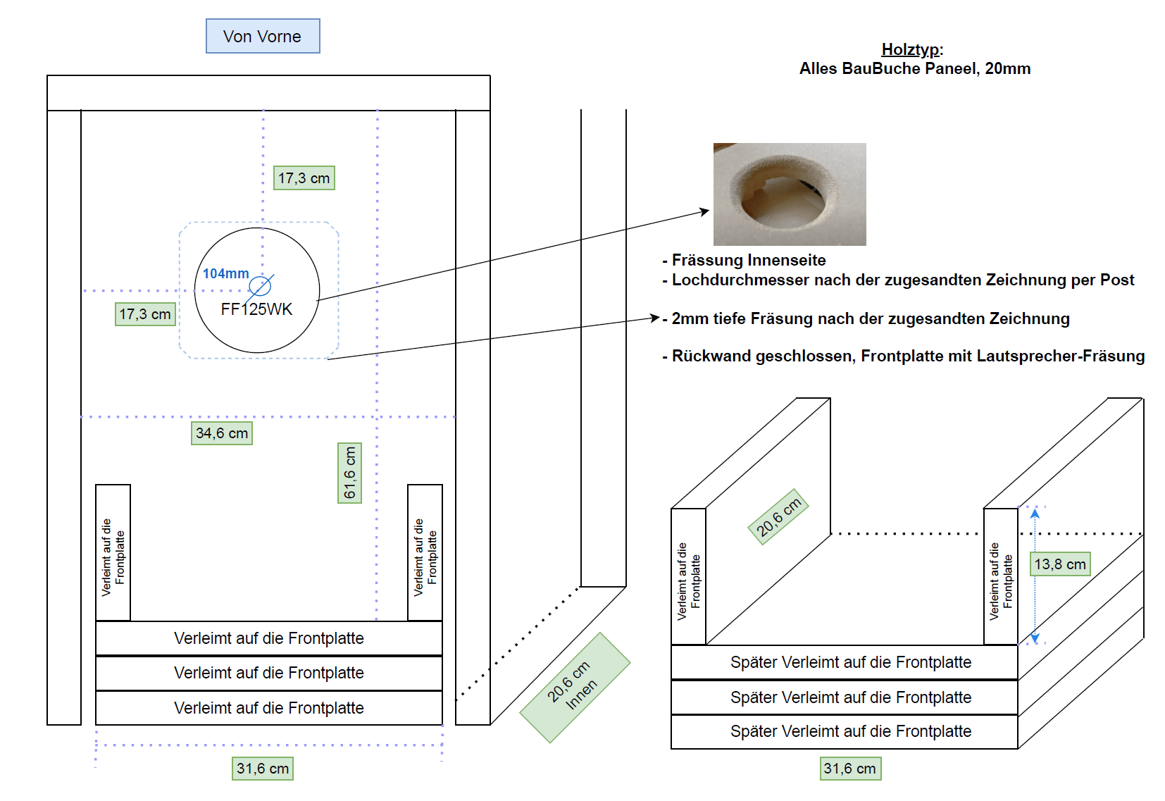

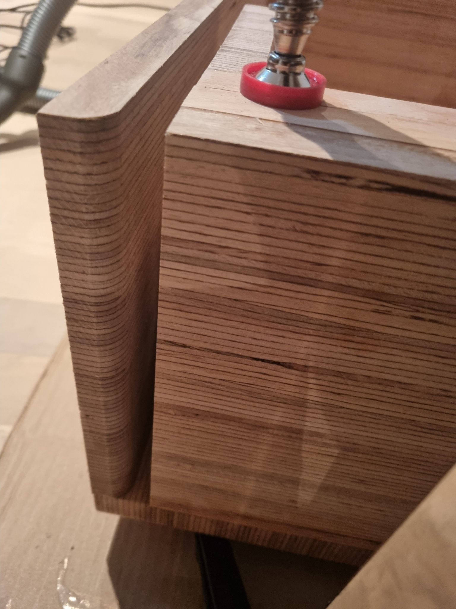

I DO NOT measure, I just listen - i'm not chasing the best full range speaker. This was a project less €500.
Sizes: sorry, German ;-)...all internal dimensions
  • Milling behind the drivers I did quite a bigger area as shown here on the picture, go give enough air behind.
  • Rear mounting I didn't like, because wanna have bigger/wider soundstage filling the room
