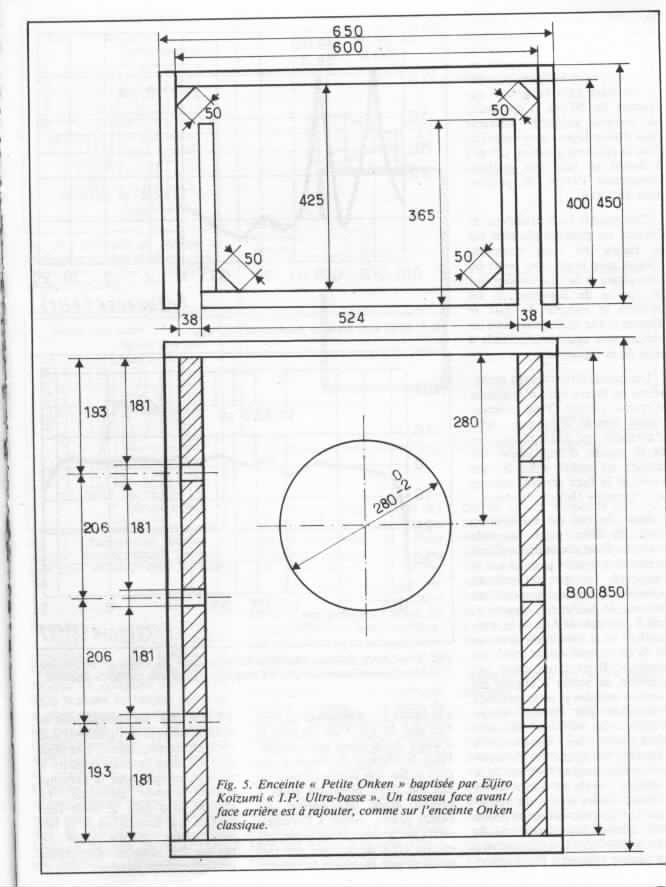

it was performed by Jean HiragaThis Box was called :
L'Audiophile LePetit
Inside a Fostex FE103Sigma.
https://www.dropbox.com/s/8lxuhi2vhfpoxt8/Le magazine audiophile -Le Fostex FE-103 Sigma.pdf?dl=0
close to golden ratios on that box ( 1 : 1.618 )
and almost a cubic foot of area ................
seems waaaaayyyyyy too big, but I like wide baffles.
I think the idea was to make it as much a true fullrange as possible - wide baffle to support the lower midrange, the big volume and port being tuned low, leaving a dip in the midrange in favour of low extension.close to golden ratios on that box ( 1 : 1.618 )

OK new b here. Hi. So I had a double-shot of the Koolaid. I have a few tools and I've been wanting to build a speaker setup for ages, but not some simple basic box kit. The le Petit looks like a great jumping in point. Something clean and pure. I am going to build them over the holidays. I've chosen the slightly upgraded Fostex FF125WK that Janos on Real World Audio youtube recommended along with the slightly enlarged cabinet. I'll post as it comes along.
You want to build an enclosure for the FF125wk, not some semi-random box from the past because you like the looks,

If the above is the box you propose, it will work pretty much as an infinite baffle, it is WAY to big for a reflex — the optimal miniOnken for the FF125wk is 9 litres, this box is 161 litres. And as drawn woefully underbraced.

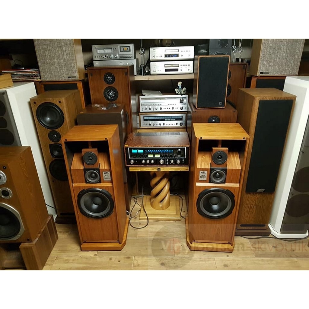

A bit off topic, but...I've had a pair of refreshed Hans Deutsch ATL 312 S speakers (from the 80s)for a long time. They're designed by the Bozendorfer piano engineer. They have a really interesting design that seems to be alive. The transmission line port opens out a the front top and the tweeter is on a bridge across the middle of the port. The first time I fired them up Al Green materialised.Hi Thanks bridger, yes I've been checking all those videos out. A lot of them feel like they are referring back to some documents or info that is never fully illustrated, but I guess there's enough to get it built. Esp. since there's no crossover!
Peerless K040 midrange?
dave

Cool. I found my first pair on the street one rainy night here in Essen Germany. A bit rough. I found a guy named Horst Wenzler in Bonn at Acoustiperfekt who hooked me up with a pair he rebuilt.
The woofers were swapped out to monacor. I'll take a look at the mids and get back later. Night.
HI, yes I was referring to Janos' video where he summed up all the drivers that might be feasible for the le petit build he talks about that driver having a longer excursion and a half-inch wider cone. A lot of info leading up to the 20 minute mark. He says something to the effect that it would be his choice for a new build. He mentions a slight enlargement of the cabinet that could improve bass response and give some dimensions as well-but that might be in a different video. They're all starting to run together - lol.
