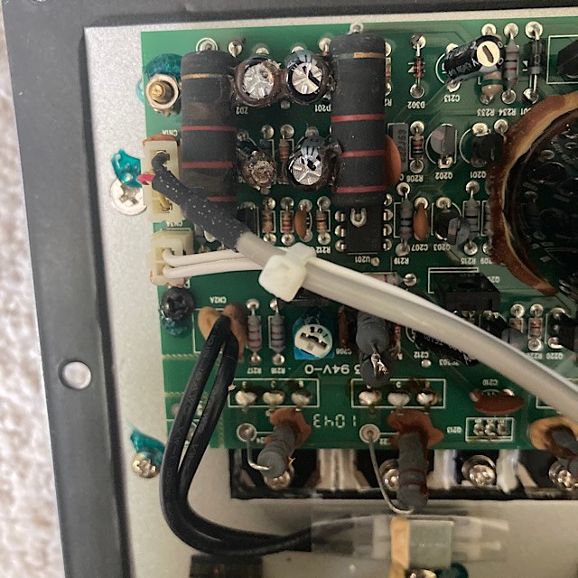

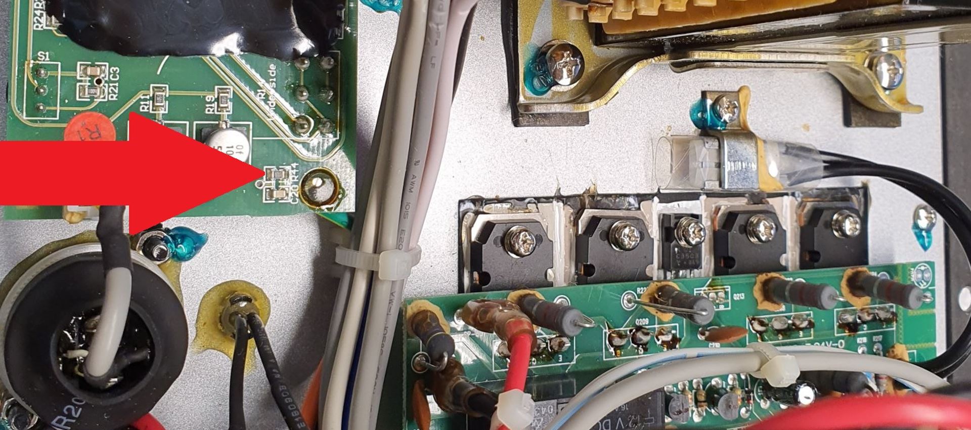

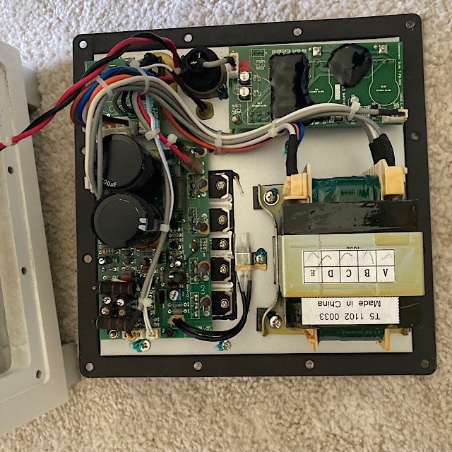

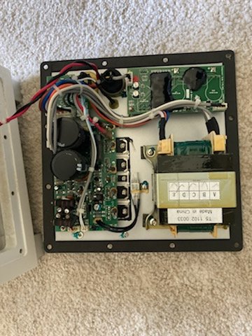

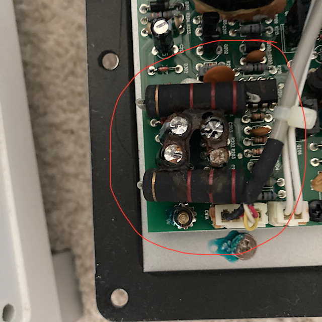

I have purchased two REL T5 subs from a guy locally. Don't ask but I was unable to test them since he had no power cables and he was at his work so I just grabbed them. Came home and both dead. No power whatsoever. Changed the fuse, still nothing. I opened the amps and saw both amps same spot with leaked caps and resistors got bad too looks like. Talked to REL and they said "looks like those need to be changed". I have some soldering skills but not for small spots like this.
Can someone help me in South Florida (zip 33326) to fix this or at least direct me to a place with fair prices? I don't want to pay more than $50 (both) to get these fixed. Otherwise, it is not worth it for me.

First mistake:
Second mistake:
Plain visuals tell you little to nothing.
Just replacing those parts will not repair your amp.
Third mistake:
Minimum bench fee runs around $60 , that repair won´t cost less than $200.
Bonus points for the extra gooped processor section :yikes:

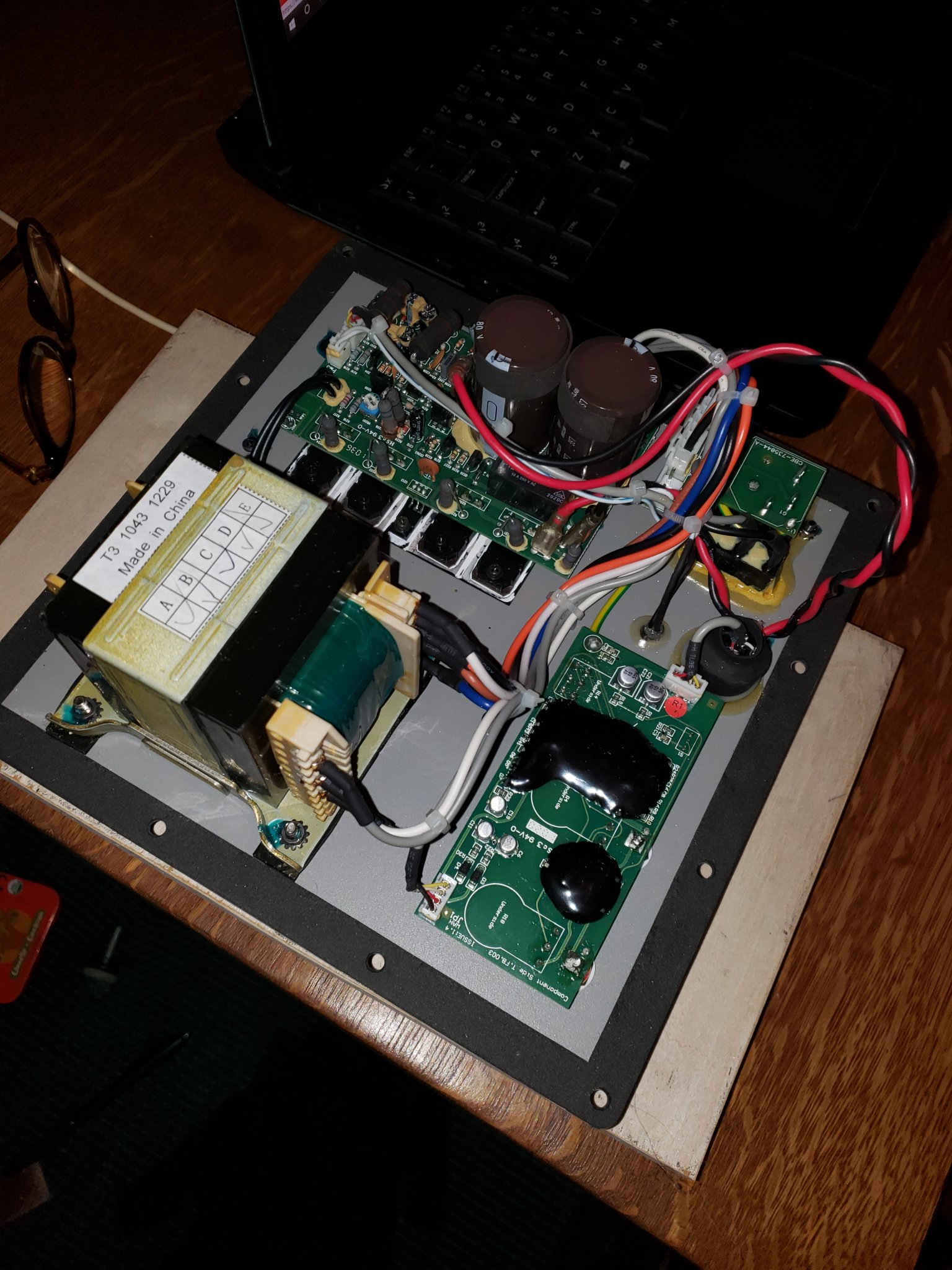

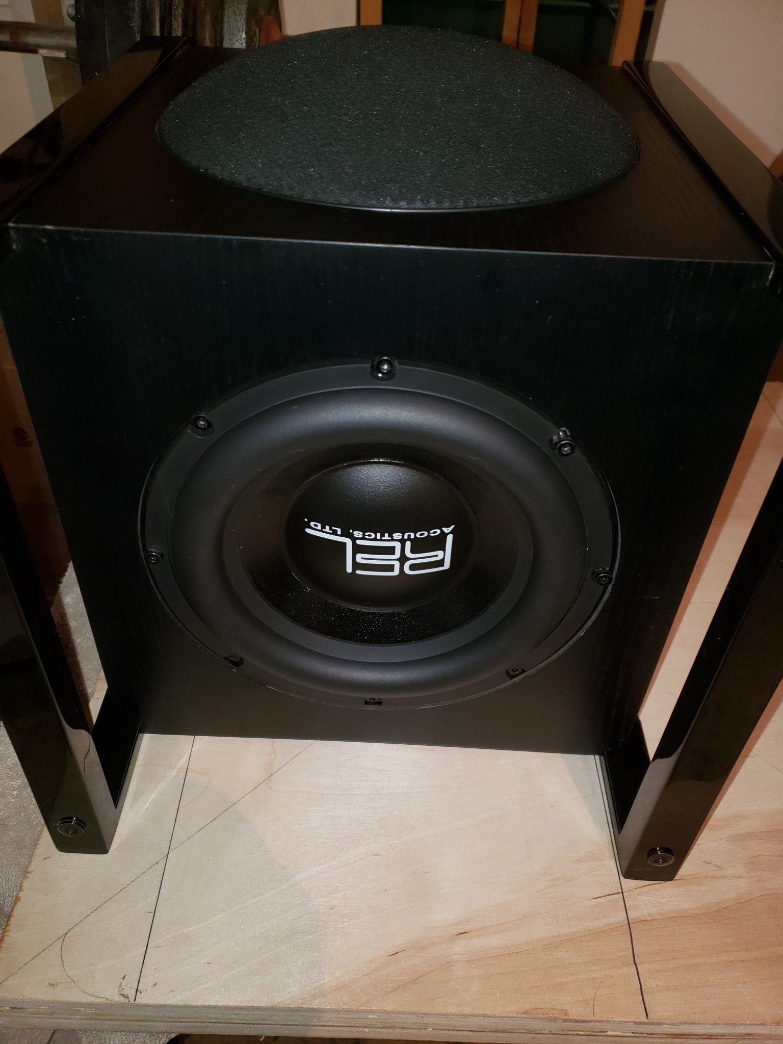

The drivers and passive radiators are decent and extremely well tuned to the factory boxes. I think the T5 has 10" with PR. I'd gladly take them off the op's hands for a few hundred bucks. Rels sound wicked. I wouldn't tamper with them I simply find a new suitable amp. This is a T3 and the plate that quit. The t3 is one of the best sounding factory built subs I have heard in some time. Regardless of cost and size. I suggest keeping them together just grab a better amp $0.02 and dsp.

@wasabii I have a T3 that needs repair. Keeps blowing the fuse. Did you replace the plate or repair it, and how?
Don't replace the original plate amp, they are cheaply made and bound to break on you.

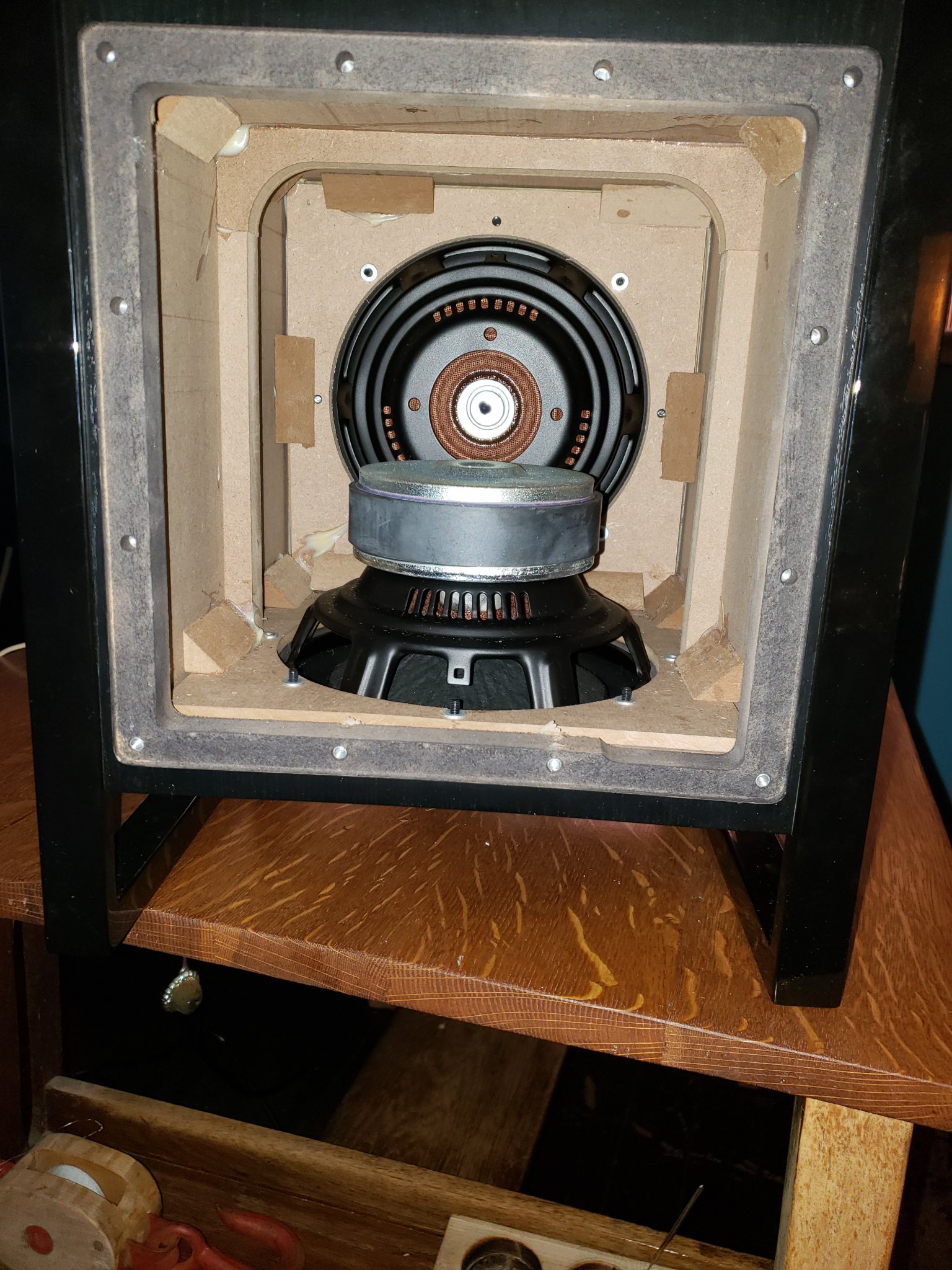

Turns out that the root issue was that the driver was seized. I'm not putting anymore money or energy into it. It's going into the trash. Thanks for responding, though!
Do tell us more about the seized drivers - how did you check and what do you think caused it. Repairable or not? Did a large excursion like a switch on thump push the coil too far and now it's stuck there?
Regarding the amp, at first glance that section looks like the class D amp output filter. If so, this is a common failure due to the very high ripple current in the capacitors. Replace them all with same value, better quality capacitors.
