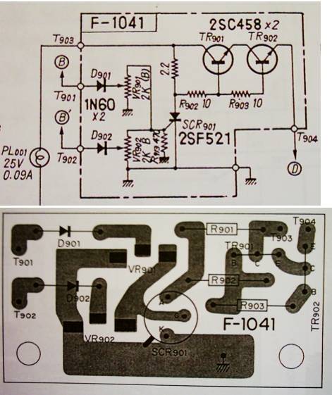

I found something.
The first power related board you had me look at powers one of the Stereo Light wires. There is another board labeled F-1041 that powers the other wire for the Stereo Light. Both of those Boards are also bringing power to the MPX board (F-1006). The F-1041 board is called the "Protector" in the manual. I tested that board and found the following. (Important: See attached photo).
D901 & D902: Both sides dead
VR901 & VR902: All poles dead
SCR901:
K = Dead
A = 24
G = Dead
Note: Holding probe against G for anywhere from 2 to 20 seconds causes a spark, with a loud pop in the speakers, and then the Stereo light comes on very brightly. I'm not sure if the brightness is correct. It looks too bright to me. However, after the Stereo Light comes on, G then reads 0.7 volts. Also, at the same time all sound goes dead (total silence) *including* AM Radio which was previously working fine. Switching the unit off resets it back to the previous condition of no Stereo Light, and normal volume everywhere but FM Radio.
If you look at the Block Photo, *all* of the components to the RIGHT of SCR901 have current. What I don't understand is that *every* contact point reads 24 VDC, (with the contact points on the other side of the resistors reading 23 VDC). The same is true of the Transistors. The difference between Transistor Base poles is only + or - 1 volt.
Keep in mind that for me to read the 24 volt range my meter must be set to 60, the next step up is 300, so looking at a difference of 1 volt is difficult at a setting of 60, (i.e: 1 volt becomes the midpoint between each line on the dial), and it is impossible to see 1 volt at a setting of 300. And the lower setting of 15 can't be used at 24 volts. (My options are 0.6, 3, 15, 60 & 300).
However, *all* circuits (all contact points) to the LEFT of SCR901 are completely dead.
When the Stereo Light comes on, *all* contact points to the RIGHT of SCR901 (which were previously reading about 24 volts), drop to about 1 volt (+ or - about 0.35, depending on which side of the resistor I test). I can take more exact readings if needed. And *all* contact points to the LEFT of SCR901 are still dead as before.
Note: I tried my best to give you enough information to draw conclusions as to what is going on.
Am I buying SCR901 yet, or is something not right about the readings I am getting from the circuits to the RIGHT of SCR901?
I anxiously await your answer...

Hi Gregg,
That is a protection circuit to shut off the amplifier in case of a fault. When you touch the gate, you induce a charge that fires the SCR. It will stay on (in protect mode) until the power is turned off and on again. This circuit kills the 24 V supply which also may provide the tail current for the diff pairs in the amplifier section.
D901, D902 come from a fault detect circuit. Either one going positive will trigger the SCR. I don't know what is sourced by TR901, TR902. They may feed the amplifier section. The current is limited to 90mA or so by the lamp PL001. The voltage at T903 (from the lamp) should be at T904 less about 1.5 ~ 2 volts. If there is no voltage, test for a short to ground (power off) or any of the 2R2 or 10R resistors open. An open B-E on either TR901 or TR902 will do the same thing. I don't know what's going on with the stereo lamp. You should measure the voltage across it when it's on.
SCR901 is fine.
-Chris

Hi Chris,
I'm stuck. I've been poking around for 8 hours and all I'm doing is poking around. I don't know enough to know where to look or what to look for. It's not a simple matter of "the shin bone's connected to the knee bone," because I don't know which bones are connected where.
If you can't tell me "look at this (specific thing), and check for that (specific voltage)..." I can't do it. I really can't. I'm quite willing, as my entire lost day will attest to. I just don't know what I'm doing.
SCR901 is proof of that. The 6 hours since then nails the lid on my diagnostic coffin.
Gregg

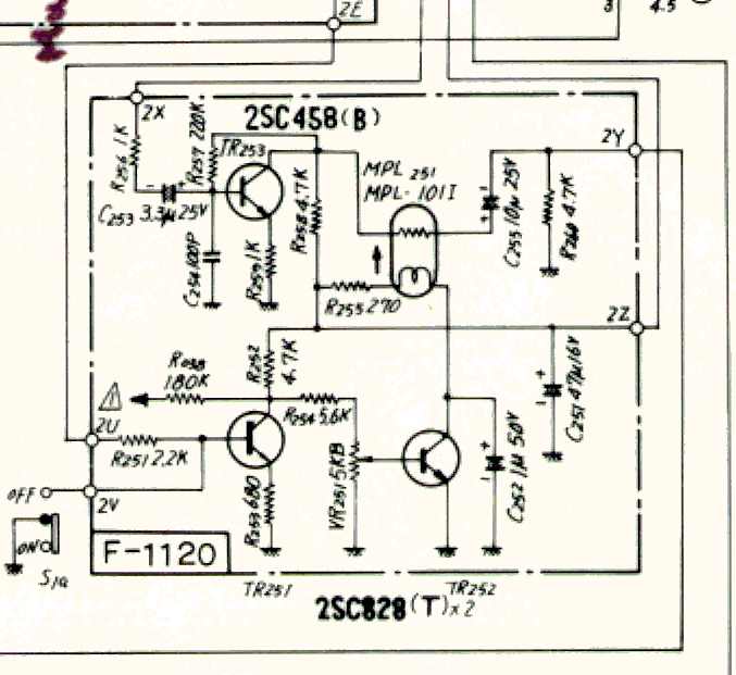

It has been years since I worked on one of those, but has any of you thought about how the mute circuit in a Sansui 5000 really works?
One version of the Sansui mute circuit in their early transistor receivers used a crude optocoupler: a phototransistor encased with a light bulb. When the light bulb illuminates the phototransistor UNMUTES the tuner. The mute switch on the front panel turns that light bulb on all the time; otherwise it goes on and off according to the signal strength (adjusted by a potentiometer on the tuner board). So when the light bulb goes the way of all light bulbs (and remember, that light bulb is about 25 years old at least), the phototransistor NEVER UNMUTES. So the tuner is in mute all the time.
As near as I can remember, the component looks like a black cylinder with wires coming out of it. As I said, it has been a long time. Many years ago Sansui ran out of those replacement parts (even before Sansui itself crashed and burned and wound up in the hands of the Turks, before being sold to its current owners). I remember that we used to just bypass the muting function to get those sets' FM working again. Sorry I can't help with telling you where that thing is, underneath the chassis. Brain fade with age, you know.
Now, back to the Garrard A70 turntable that's on the kitchen table this afternoon...
Very nice tip. If indeed the lamp of the MPL251 is broken, the signal coming in from 2X will not show up on 2Y regardless of the position of S1a. Here's that little nifty diagram.
/Hugo 🙂

Hi Hugo, (and GP49)
This is a very interesting development in that the whole point of my post (besides seeking any help I can get), is my suspicion that the problem has common cause. The reason I have been assuming this is because I keep hearing of this exact same problem affecting many of these units.
That "ebay ad" we discussed has resulted in numerous requests from people asking me for the Sansui 5000 Manual and Schematic, and *every* request has been accompanied by a plea for any information I can offer regarding this very same problem with no sound when using FM. (The best I can do is forward the Manual to these people, and also refer them to this thread).
In fact, the problem is *so* common that a bad light bulb makes perfect sense.
I have been looking at this image of the MPL251 circuit for about an hour and I am once again hobbled by my inability to fully understand a schematic. Can you (or anyone) tell me how to test this circuit, and also explain how to bypass it? If not, then all I've got is a nifty diagram.
For example, you stated "the signal coming in from 2X will not show up on 2Y regardless of the position of S1a." That suggests to me that it is not a matter of running a jumper. It sounds as if a specific measured "something" must be produced by that circuit. Yes? (No?).
I (once again) apologize for my ignorance regarding schematics. It's a problem that "short circuited" a career in electronics 25 years ago.
