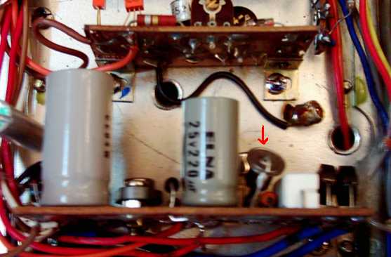

Hi Chris,
Okay, now I'm getting somewhere!
I tested that board. Keep in mind that I am essentially a blind man just probing for voltage readings. The bottom line is that I am satisfied there is voltage getting to the board. There are several wires all leading in at the same spot, and I get a reading of 24 volts DC.
I remembered that Hugo mentioned it looked to him as if the circuit with the resistor that had no voltage (R426?), appeared to run through the Stereo Indicator light. So, I followed the red and orange wires. Each wire leads to two separate circuit boards underneath the unit. The Orange wire leads to Circuit Board F-1041, and the Red wire leads to Circuit Board F-1137. Needless to say, *neither* of these boards are shown in that worthless "Service" Manual I bought.
When I try to unscrew the bulb from the socket, there is VERY LOUD popping noises coming from the speakers. (Note: The bulb is not blown, but it doesn't light). Since the wires from this socket only lead to those two circuit boards, I began checking the boards.
The F-1137 Circuit Board which the Red wire goes to has two Zener Diodes, ZD001 and ZD002. One of them (ZD001) has been replaced. The wires were cut above the circuit board and the new part was soldered onto the old wires. This part is different than ZD002, in that it is made of metal. It looks like a "can" with a wire coming out of the bottom (the dead side), and another wire coming out of the top (the "arrow" side). There is no voltage on the end of this part that is NOT the "arrow" side. I did tests as follows:
ZD001 (the replaced Diode in question - metal "can" type)
On the side with the arrow the voltage is: 24 VDC
On the other side the voltage is: 0 (dead).
Note that when testing on the side with the arrow, if I get too close to the "can," it arcs between the can and the test lead.
ZD002 (Original part - color black)
On the side with the arrow the voltage is: 12.5 VDC
On the other side the voltage is: 4.5 VDC
Note that those voltage readings go up "slowly" (incrimentally) to those readings listeded above, when connecting the test leads.
I have attached a photo of the board, with a red arrow pointing to the part in question.
Now what?

Hi Guys,
NEVERMIND
I removed the part, and by sheer coincidence I happen to have a NEW spare. It made no difference, and the test results are identical.
When I test the old one against the new one, they both show the same measurements with regard to resistance (one way), etc...
Whatever the problem is, it is *NOT* the ZD001 diode. That part was definitely replaced at some point, but it is good.
The arcing I saw was the test lead touching the can which is essentially the same thing as touching the wire on the other side of the can. The new part did the same thing.
Oh well, back to square one. (No, square *ZERO* is more like it).
-Gregg
What you measured on the diode is normal.
In simple terms, the anode, which you call the dead side is connected to the AC wire of the transformer, enventually via a fuse and/or a safety resistor.
The cathode, which you call the arrow side, carries the DC voltage and that is your 24VDC.
/Hugo 🙂
Hi Gregg,
There is still another voltage feed to the MPX board. There is the feed through the lamp to terminal 4i, the power feeds to 4j. You still have a power problem.
BTW, the schematic does not match your layout at all. Your MPX PCB seems to be newer than the schematic I found. Hopefully someone can help out here.
-Chris
