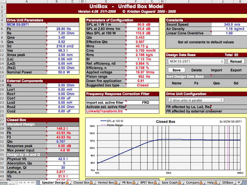

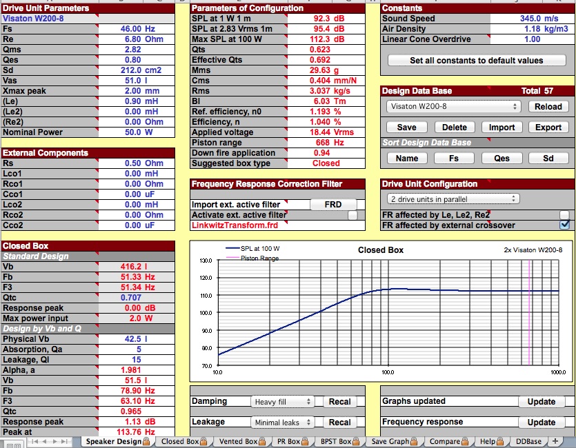

I checked the frequency response graphs of several speakers. It looks like the MCM would be best up around 3khz. How it will sound, I don't know, but it responds reasonably well at higher frequencies and rolls off smoother. Most of the others I look at got flakey fast above about 1khz. By the way, it is an $18 speaker being sold for $8.
The VISATON W200 doesn't have a frequency response graph but it is claiming response up to 8000hz, where as the others I saw only claimed response up to about 5khz. That could imply it might do well up near 3khz.

No way that box is getting modified without destroying it. And I'm a cabinetmaker. Besides, I prefer the bass of acoustic suspension.
The Dayton DC200 models a lot smoother. But the recommended enclosure size is 2/3 of mine.

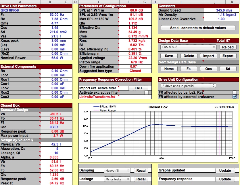

One thing that occurs to me, there may be a hump in the GRS drivers, But it doesn't look that bad. And I'm wondering if this UNIBOX doesn't account for Baffle Step loss? If not that hump may actually be occurring right below where the bass starts to drop off due to the narrow baffle?
I don't know about unibox, but the stepped woofer crossover is probably an attempt to compensate for the baffle step effect.
How wide is the baffle, it shouldn't be that hard to get an estimate of the Baffle Step Frequency?

You raise very good points and I came pretty close to your calc's on the crossover points. of 2500hz for the tweeter and upper woofer. And, 500hz for the lower woofer. That's just me struggling through the numbers though. Please don't ask me to reproduce them! (LOL)
-The baffle is 11.5" wide (although the Black part of the baffle is inset by 3/4").
-My budget is not set in stone. However, I want to stay pretty cheap. Say less than $100 including shipping. Preferably less depending on goal.
-My goal is to really just get them running nominally close to original spec. I know they weren't breaking any technological barriers when new. They will be put into my living room system which is all 70's vintage, so I'll be looking for that 70's coloration. Maybe it's best to stipulate that I'm not looking for upgrades at this time, just to repair or replace the bad components (missing driver) in the most cost effective way without negatively affecting the original sound. Going deep on the bass is not an issue for general listening in the living room.
-Of course, the above statement is relative since I don't really know what the original sound was like. How's that for subjectivity!
-I have 3 of the original woofers. But, like I said originally the speaker tech told me they are rubbing. But for light duty use they might last a while yet. So I could just replace the 2 lower woofers and probably get really close to the sound. However, if the drivers are cheap enough (in the range of those MCM or GRS drivers) I could buy 4 and start by replacing just the lower 2, and trying the uppers as well.
-I might also like to budget in enough to order up some decent quality caps to try out as well (I would be iterative about replacing components rather than shotgun approach). The existing are 8uf film caps of import origin. Say $10 at PE would get me a pair of Jantzen Cross-caps or equivalent.
-Overall my expectations are, I believe, realistic. I have no illusions of these being "audiophile" grade. I have a pair of Acoustat electrostatics with servo amps in my listening room (put together before I decided to go back to school, thankfully) for that.
-Down the road I may decide I like the cabinets enough to start from scratch and build a really good speaker in them. But, I'll cross that bridge when I come to it.
Hope that helps. Everyone has been very helpful with suggestions.

Ok, so between the GRS (4 for $37) or the MCM (4 for $28) they both look like they could work. And the price is low enough that I'm willing to take the risk. Further down the road if I really felt like putting more into the cabinets I won't be heartbroken over having spent the money on temporary drivers.
Think I'm leaning towards the GRS.
-Despite the hump, I have more confidence in the specs from PE. I noticed the hump lessened when I switched to "heavy fill".
-They have 1.5" VC's.
-The slightly lower efficiency will probably be a better match for the Peerless tweeter, which is either 89 or 91db depending on differing sources for the spec. And, it would be easier to pad the tweeter down than visa-versa. If I only use two new woofers I have no idea what the efficiency of the stock ones are.
