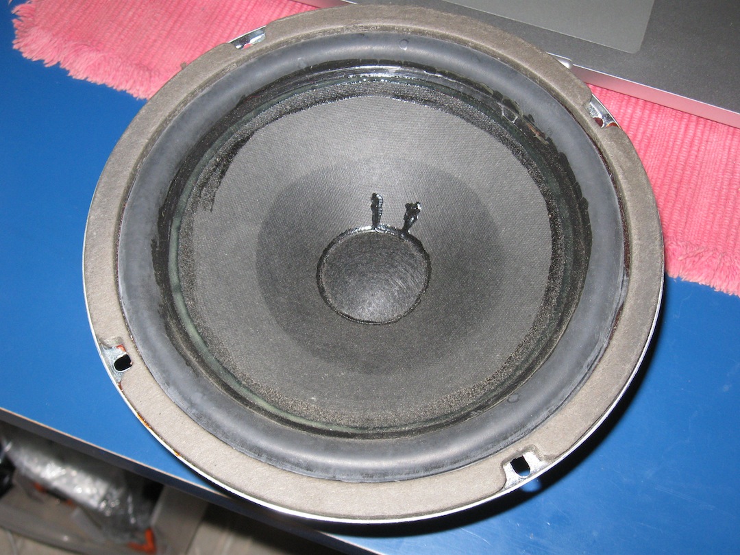

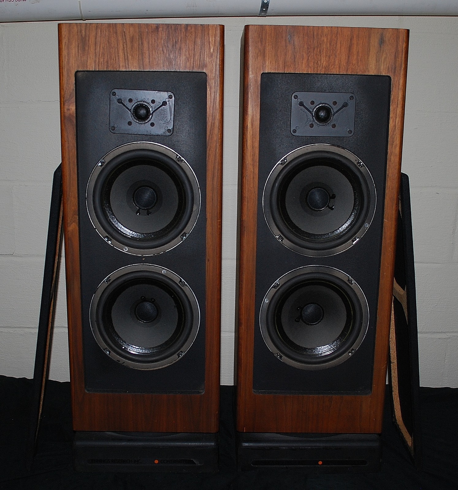

I recently picked up a vintage pair of Jennings Research towers. They are 2-1/2 ways with 8" woofers and Peerless tweeters. When I grabbed them one of the woofers had been replaced with an inappropriate driver. Thought it would be no big deal to find a suitable replacement in a pair.
Well, it proved impossible to find spec's or even manufacturer of driver. So, I took the remaining 3 "good" drivers to my local speaker repair place (the one everyone says knows what they're doing) to be tested so I could get some baseline parameters. They declined to run them, as they said the VC's are rubbing and it would be pointless. They did seem to play fine though when I tested the speakers with the weird RadioShack 8" full range driver in. The original drivers are paper coned, rubber surround, and 1" VC's. They feel very compliant to me.

The boxes are 1.5 cubic feet inside (42 cu. ltr.) inside dimension. They are 11.5 inches square and 30 inches tall.

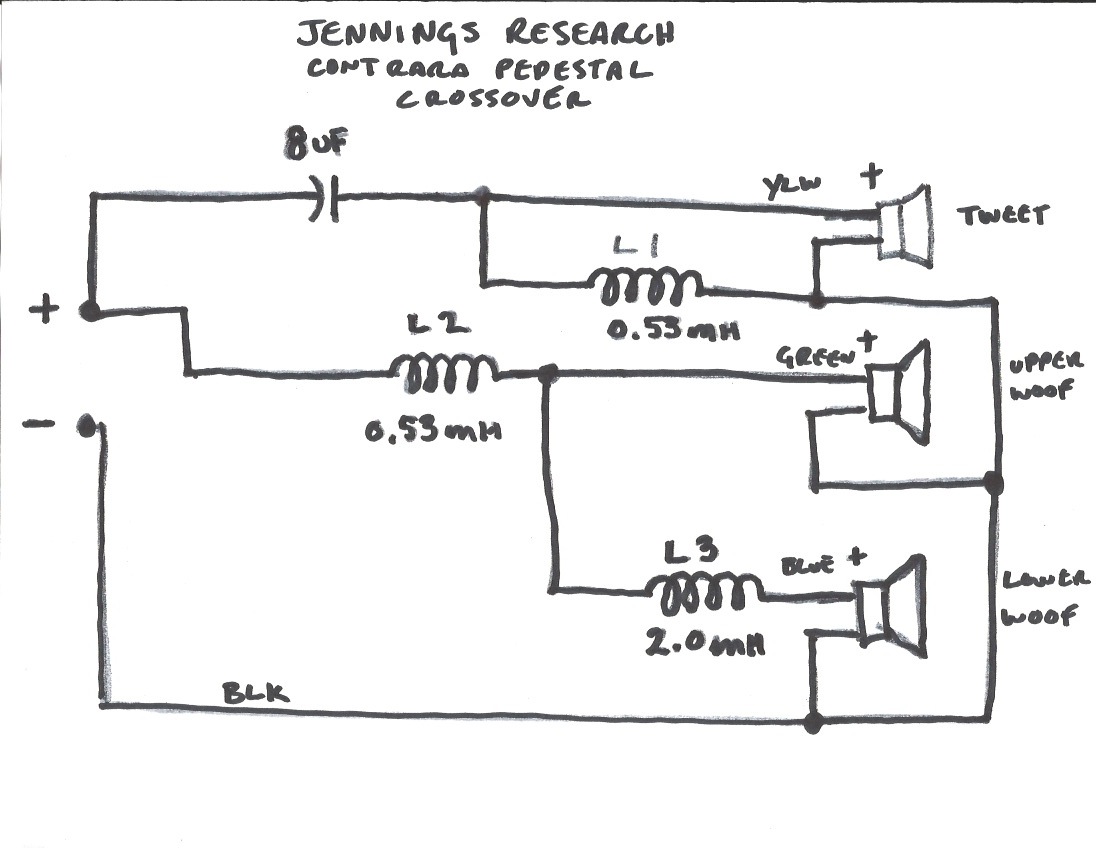

I've also attached a copy of the crossover schematic. It's pretty simple. All drivers are 8 ohm. Using online calculators I came up with the tweeter being crossed over on a 2nd order at 2500hz. The upper woofer also crossed at 2500hz on 1st order. And the lower woofer crossed over at 500 hz. as baffle step compensation. The speakers were originally rated at 75 watts max.

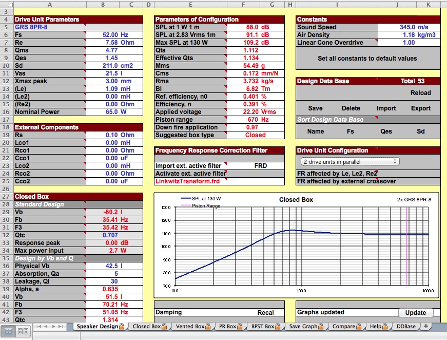

I'm thinking about using these drivers.
GRS 8PR-8 8" Poly Cone Rubber Surround Woofer 292-428
Without any T/S parameters for the originals, I'm just going on the recommended sealed enclosure volume, the rated wattage, and frequency response. The price is right, especially if I just wanted to replace all 4. I did download UniBox and plugged the parameters in for my box size and from what little I know it looked like it could work? Hopefully without too much adjustment to the crossover. If I ordered 4, I could get the discount.

I'd look for a driver with a lower Qts (.4-.6???, perhaps the Dayton), to avoid that hump.
Sim a few more to see if you can get a flatter response.
If you're happy with the midrange sound spend a bit more on the woofers.
Personally, with a box that small, I'd be inclined to make a new front baffle and replace the 8" drivers with 6" drivers, and vent the box... but that's a bit more work...
No way that box is getting modified without destroying it. And I'm a cabinetmaker. Besides, I prefer the bass of acoustic suspension.
The Dayton DC200 models a lot smoother. But the recommended enclosure size is 2/3 of mine.
One thing that occurs to me, there may be a hump in the GRS drivers, But it doesn't look that bad. And I'm wondering if this UNIBOX doesn't account for Baffle Step loss? If not that hump may actually be occurring right below where the bass starts to drop off due to the narrow baffle?
I think you are on the right track. I wouldn't spend a lot on the woofers without also replacing the KO10DT's and the crossover. The only thing I would look for is to make sure that whatever woofer you buy, it should be an 8 ohm nominal speaker because the crossover runs them in parallel at low frequencies. Those GRS's are just fine.

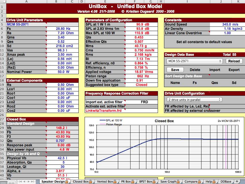

Sreten, do you have any experience with the MCM drivers? I'm always suspicious of super cheap generic stuff. At least with the Parts Express they have a reputation to uphold and I trust them to pick their budget import products well.
The magnet doesn't look that pathetic at all for 7(18) bucks.
http://www.mcmelectronics.com/content/ProductData/Spec Sheets/55-2971.pdf
The numbers and graph look excellent for a very budget driver.
I'd buy and use in the bottom of the 0.5 way, but also try at the top.
