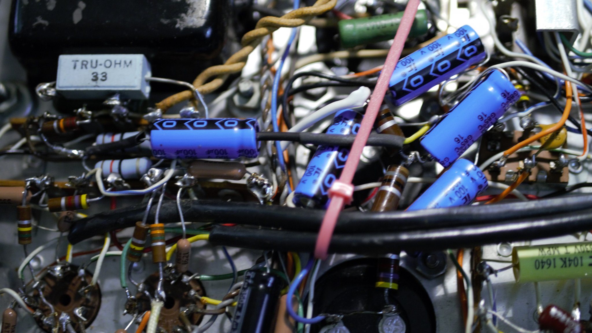

I would recommend restuffing the bias and filament supply filter capacitor if you are motivated. These are common + (backwards from standard cans) and were custom made for HH Scott. It will be tidier..

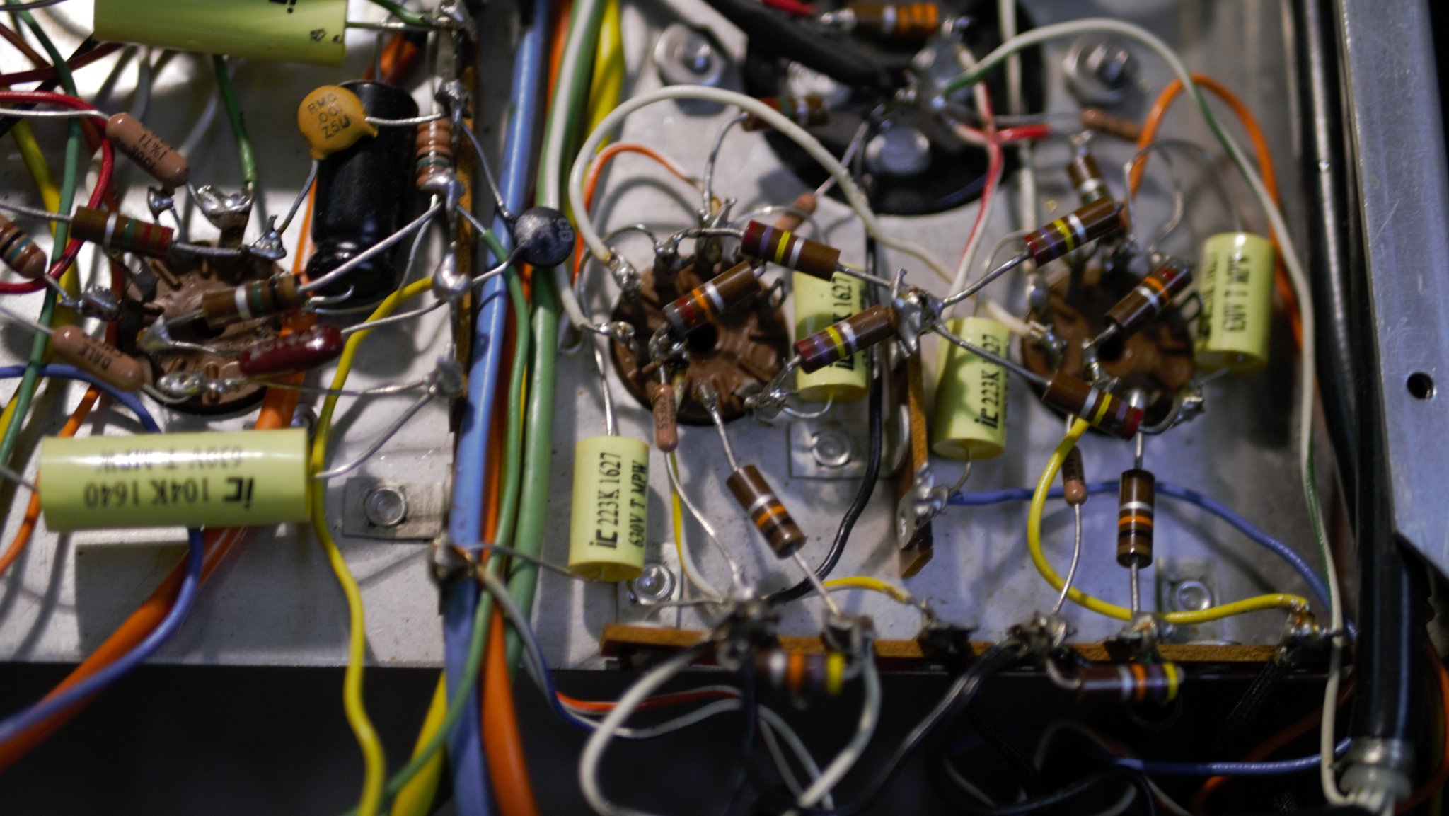

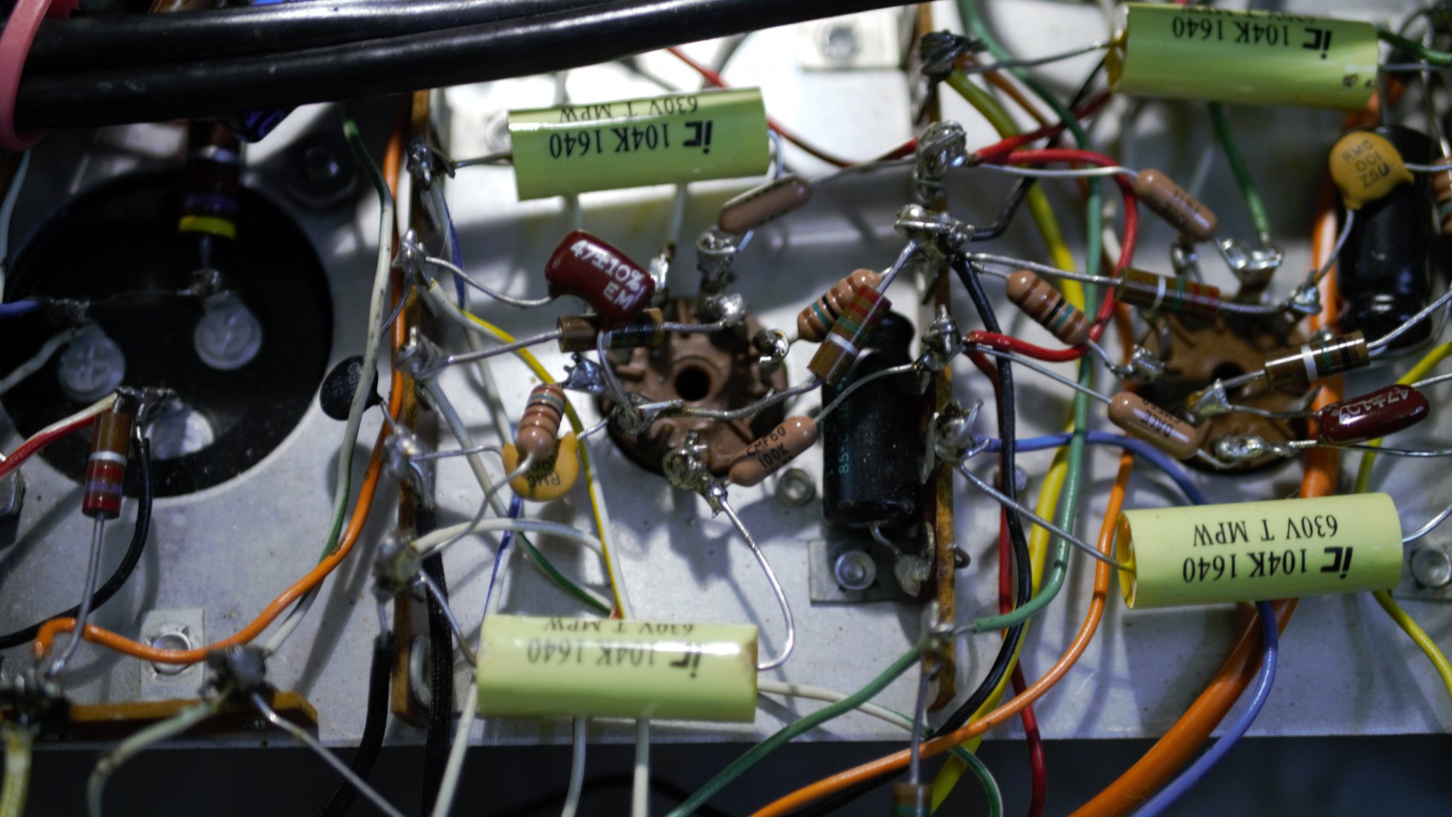

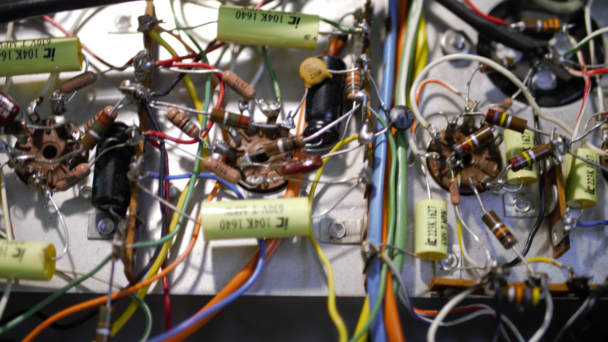

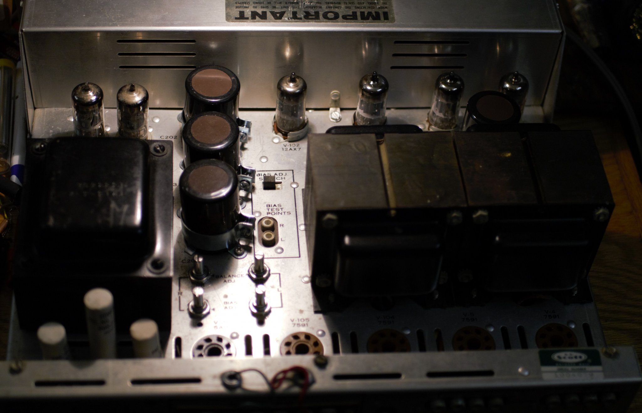

Greetings and salutations! I'm still alive and working the problem. I've restored it to "stock" as best I can tell with some caveats. One bias pot was damaged so replaced all 4 with 10 turn 20k ohm units and added 14 ohms resistance after 33ohm 5watt resistor (R205) in bias supply.
I haven't tested anything with 5AR4 installed but here's where I am. I set all the pots at midway (5 turns) and have -18v more or less on pin 6 of 7591a's. My 6U8a's glow, 7591a filaments are good but my 12AX7 string is dark and cold. Measuring DC, I read -42volts between pins 4 V1 and 5 V102. I reflowed and checked again the connections and correct me if I'm mistaken but shouldn't I have some glow even with 10.5 volts per tube? I pulled each 12AX7 and tested the filaments for continuity pin 4 to 5 and all tests good. I missed something obvious didn't I? I'll check back but first I must look through my stash for 4 more 12AX7s. Thanks in advance for your help!

Series heaters make it a bt more difficult since just one dodgy pin connection would impact all 4 tubes. Not sure if this is the right approach, but I would leave the tubes out and temporarily fix an equivalent resiistor across the start and end of the chain so I could verify the supply was OK. The current is 300mA, and there are 43v across the 4 heaters, so the resistor should be 43/.3, so roughly 120R, and power rated 0.3 x 43, so 15W as a min. Maybe you could build up something with higher wattage resistors linked together, parallel and series? It is probably an over the top way to do it, but it allows you to divide the problem in half.

If it was a new cap then that is OK, but did you nte the earlier comment that the Scott caps were reversed to normal caps with a positive case?
interesting idea, thanks.
