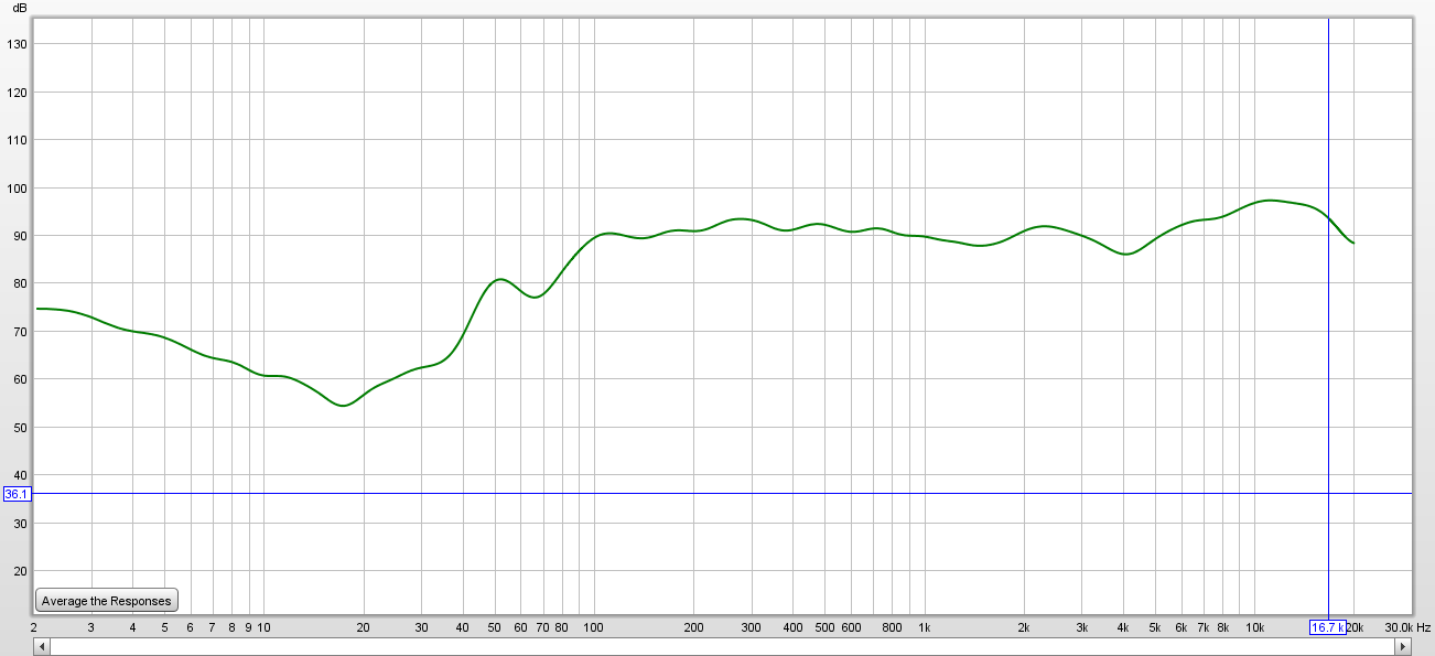

And a pic of the REW graph without any attenuation. I know I have to pad down the CD but don’t know what to do with the slope. If the CD was flat I could just pad it down, but, I think, the horn is making the CD response into a slope.
So, what would you do?

Here is separate woof (Blue) tweet (Green) and both (Red)

ok, I am happy now. So, I used a Linkwitz-riley (spell) 2nd order crossover then L-pad with 8ohms to + and 1ohm across negs, with a 4.7uf cap in parallel with the 8ohm resistor. The graph shows a good bump at 10khz but it gives these little guys a bunch of air and don't scream at all.

Your new response looks great - are you still using the Dayton 3.5k XO board but just adding the 8R and 1R padding plus 4.7uF lift? Or is this a brand new custom XO you threw together?
Congratulations on the new speaker - must sound nice.
Btw, a trick to lower bass extension (at expense of sensitivity) might be to raise the woofer Q by putting maybe 1.5R in series with line from XO to woofer. Or add mass to the PR (as you are considering in another post). You can also add mass to the main woofer cone (a loop of 12 ga copper wire glued to interface of dustcap and cone).
Still using the Link/Riley 2nd order. Yes, just added the 8/1/4.7
