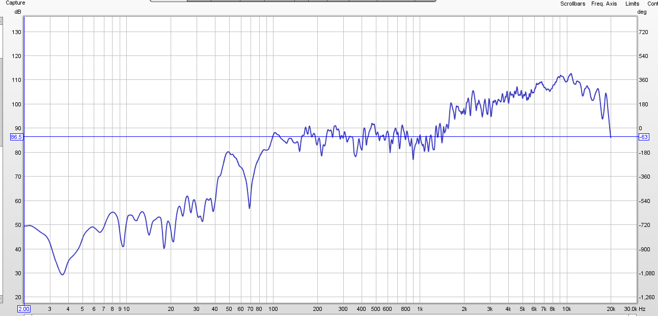

I could use the help of the crossover experts. I got a wild bug last week to build a pair of speakers. I got one done and don’t know exactly what to do with this crossover.

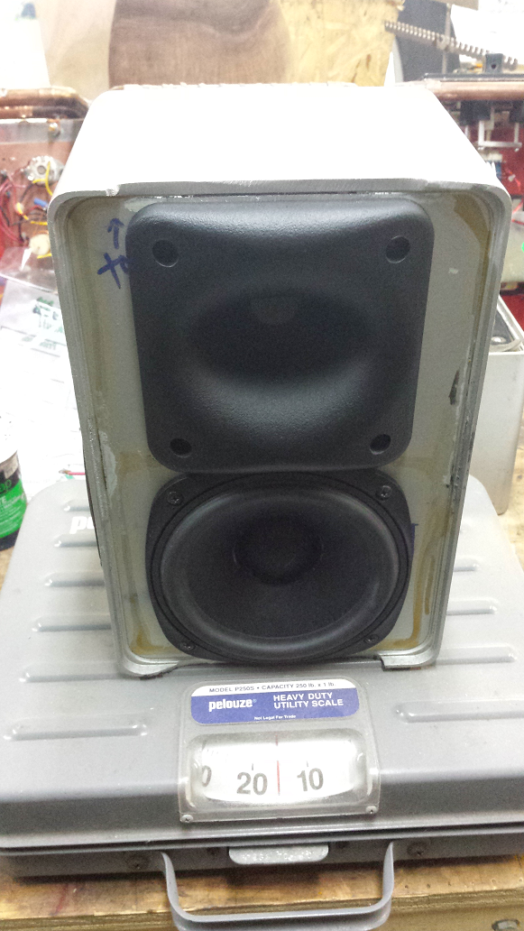

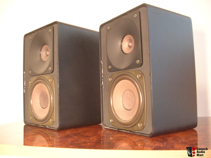

I started with an old beat up pair of RS Minimus 11s. I gutter the cabs an started sizing parts for the empty cabs. They are REALLY well built cast aluminum so are making a great starting point.

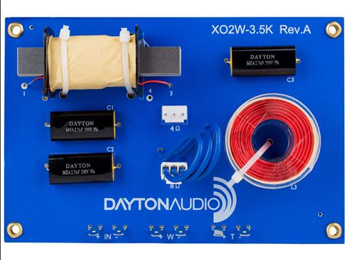

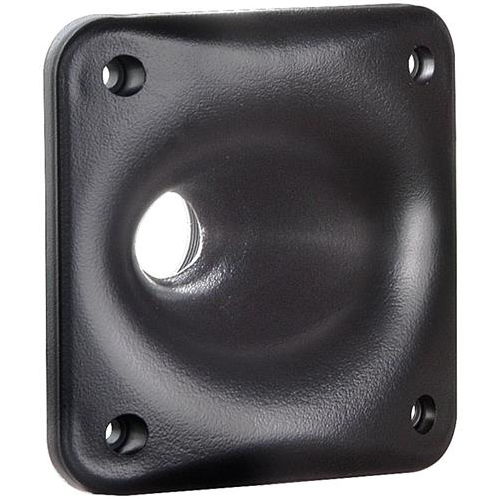

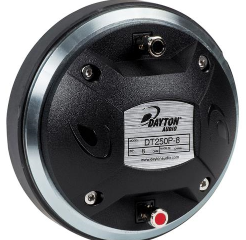

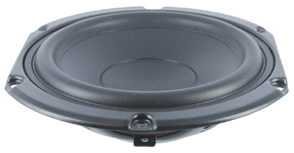

I installed the H45E horn, Dayton DT250P compression driver, SB Acoustics woofer, Peerless passive radiators (one on each side), and the Dayton 2 way crossover. I had the crossover, which crosses at 3.5khz which is the low cross point of the H45E horn.
It has been an exercise in stuffing 5 lbs into a 2lbs bag and the little bugger is heavy. I don’t have pix of the actual speaker but will post that today. But here are pix and links for all the parts.
And a pic of the REW graph without any attenuation. I know I have to pad down the CD but don’t know what to do with the slope. If the CD was flat I could just pad it down, but, I think, the horn is making the CD response into a slope.
So, what would you do?

Woofer
https://www.madisoundspeakerstore.c...b-acoustics-sb13pfc25-08-5-paper-cone-woofer/

Dayton Audio H45E 4.5" x 4.5" Elliptical Waveguide 1-3/8"- 18 TPI

Dayton Audio DT250P-8 1" Polyimide Compression Horn Driver 1-3/8"-18 TPI 8 Ohm

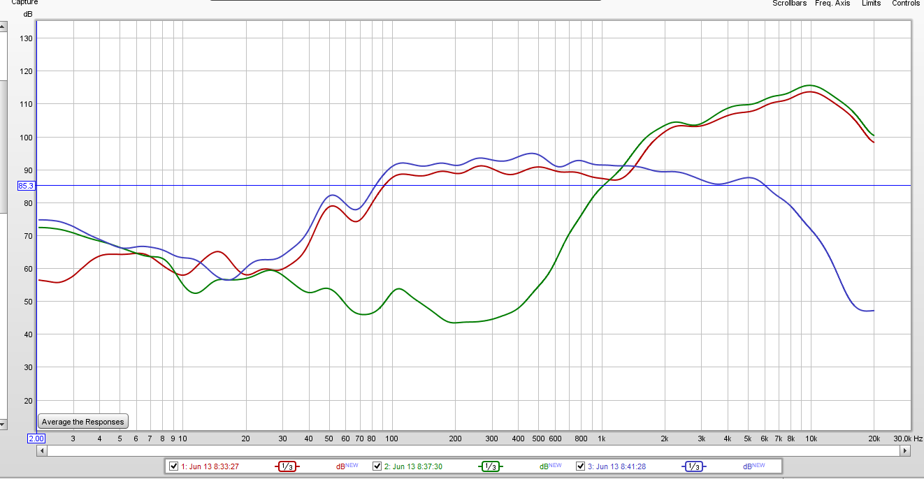

Here is separate woof (Blue) tweet (Green) and both (Red)
Does the woofer not being broken it affect this at all?

Anyone work for hours then slap your head??? I did. Yesterday I gathered a bunch of caps, resistors, and coils and started experimenting with notch filters and step filters in an attempt to tamp down the horn peak so the high end roll off would be less giving the speakers more "air".
WELL, I worked at it for a couple hours and was getting strange readings. I had to see and think about it for a while then realized the day before I did some EQ to see what they might sound like and I left the EQ on!!!!

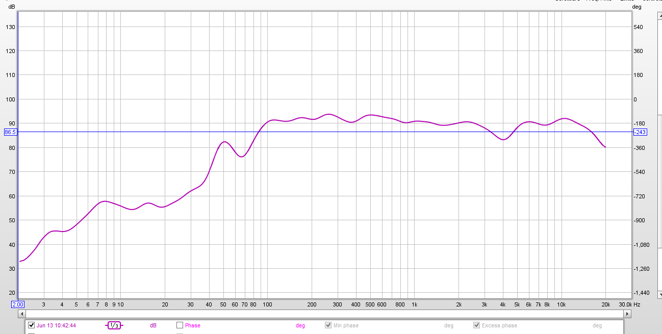

ok, I am happy now. So, I used a Linkwitz-riley (spell) 2nd order crossover then L-pad with 8ohms to + and 1ohm across negs, with a 4.7uf cap in parallel with the 8ohm resistor. The graph shows a good bump at 10khz but it gives these little guys a bunch of air and don't scream at all.

I know how you feel, I was getting these strange bass peaks at 50Hz and mid bass cut at 300Hz for months until I discovered my new laptop had a resisident background SRS sound processor that applied this crappy EQ on everything.
Your new response looks great - are you still using the Dayton 3.5k XO board but just adding the 8R and 1R padding plus 4.7uF lift? Or is this a brand new custom XO you threw together?
Congratulations on the new speaker - must sound nice.
Btw, a trick to lower bass extension (at expense of sensitivity) might be to raise the woofer Q by putting maybe 1.5R in series with line from XO to woofer. Or add mass to the PR (as you are considering in another post). You can also add mass to the main woofer cone (a loop of 12 ga copper wire glued to interface of dustcap and cone).
Still using the Link/Riley 2nd order. Yes, just added the 8/1/4.7
