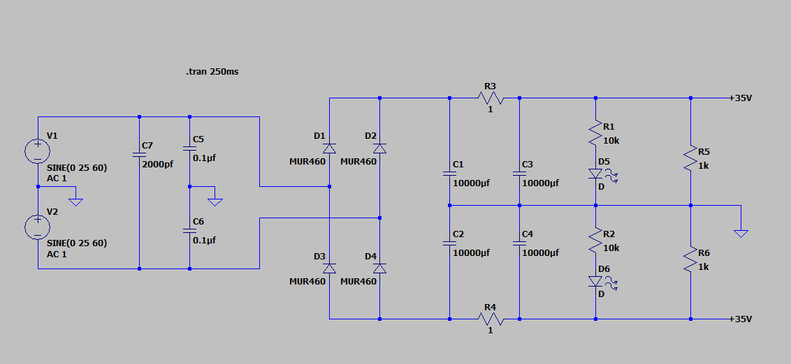

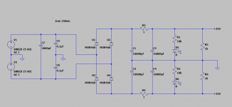

I am trying to see the effect of the DC voltage filtering if I were to use CRC filter. I have drawn the simulation, but it does not seem to be working. I also wanted to check on the effectiveness of the snubber capacitors right at the transformer AC secondary coils.
Any help will be greatly appreciated!

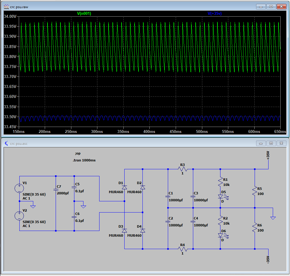

Wow! - adding 1 ohm resistor reduces ripple by a lot! Unfortunately it also drops the voltage....
Before the R the ripple is between 33.97V and 33.72V => 0.25V or 250 mV. After the R, ripple is between 33.505V and 33.480V => 0.025V or 25mV.
I wonder how to calculate the current flowing thru the 1 ohm resistor? What power rating should I choose? I am using this psu to power LM3886 based amp.

A CRC power supply is probably not the best for a LM3886 amplifier as its current draw varies. At rest the current is very low and at maximum output the current is very high. For instance the 1 Ohm resistor in your LTSpice simulation drops 0.05V if the quiescent current of the amplifier is 50mA, but if the maximum current is 7A (I don't know if that is the maximum for your operating point) then the resistor drops 7V.
Ideally you would not want any power supply voltage drop at all during the operation of the amplifier. The simplest supply when constant voltage is required over a wide range of current draw is to have an adequately sized transformer and enough capacitance to minimize ripple. So no CRC but only C.
Reactions: pbilous

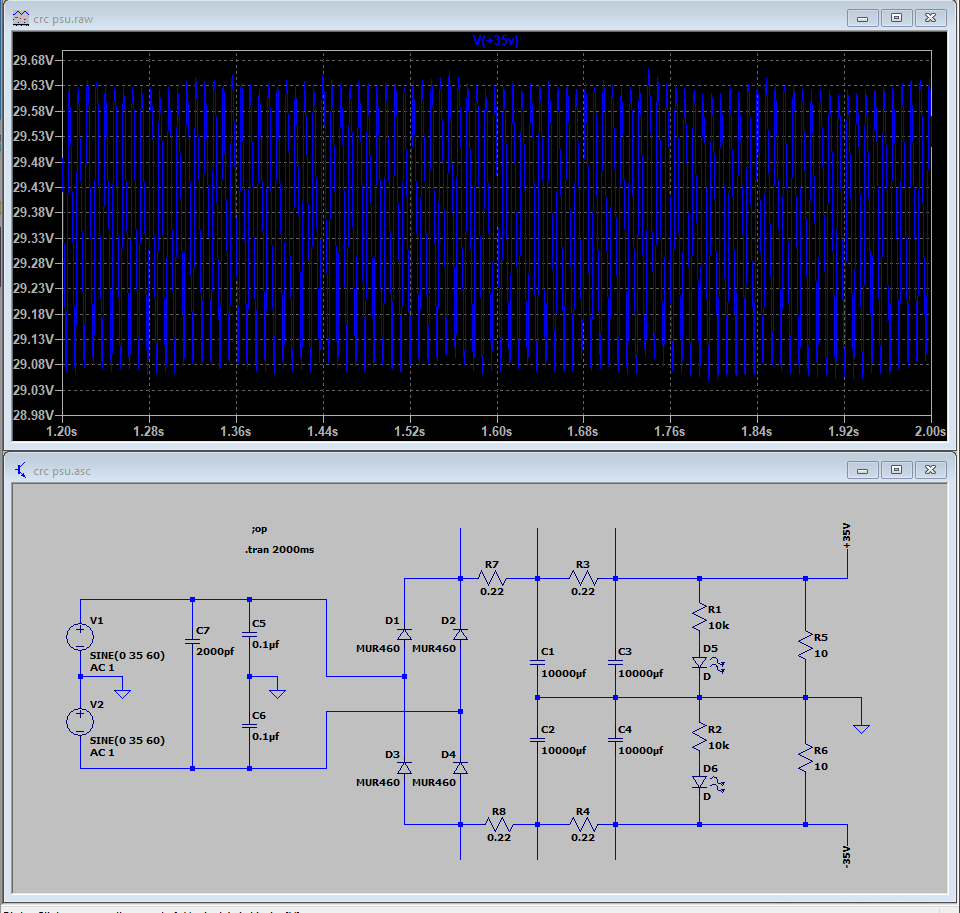

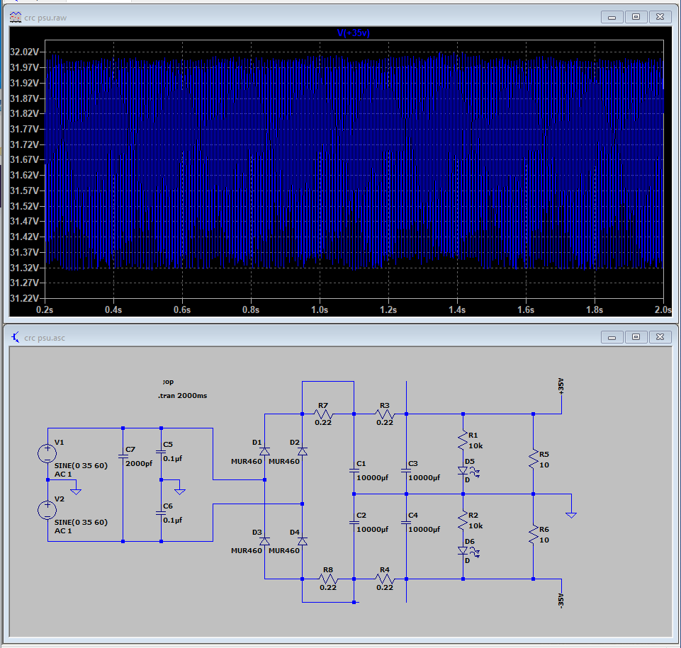

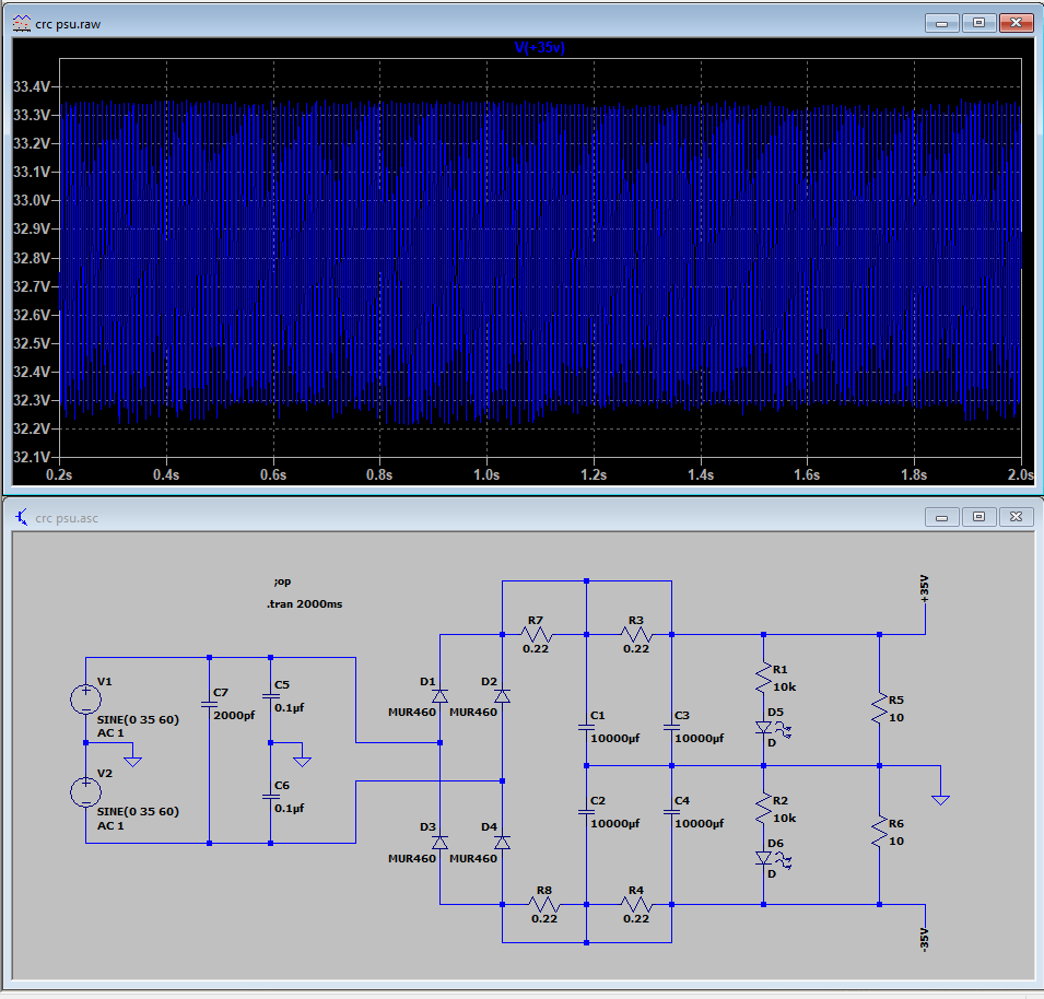

Two 10,000uF capacitors give voltage in the range from [32.3V to 33.3V] - that is 1V difference.
Adding four 0.22R resistors (RCRC filter) reduces the voltage variation to [29.08V to 29.63] - that is 0.55V difference.
Adding two 0.22R resistors (CRC filter) reduces the voltage variation to [31.32V to 31.97] - that is 0.65V difference.
DC current max for 0.22R 5W is I = sqrt(5/0.22) = 4.7673 Amps. Since chip consumes AC we convert by RMS ??? - 4.7673*1.41= 6.7419 Amps per rail?? Is that correct?
I don't think that adding resistor to the filter is making much sense for my particular application of the power supply. Any other opinions?
After simulating multiple scenarios, I think that you are right and I don't need that R in the filter.
I wouldn't be too worried about adding the "R" in the filter, the LM3886 has a PSRR (Power Supply Reject Ratio) for 120Hz of about 95dB for the negative rail and about 110dB for the positive rail for +/-30Vdc rails, refer to Page 16 Fig.47 of the TI datasheet.

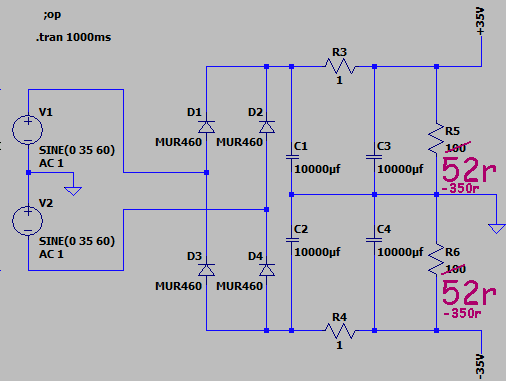

Power supply voltage +/- 35V ... Io Output Current Limit ... Typical 11.5 Limit 7 A (min)
You are never going to get 11.7 Amps except with precision abuse.
For class AB power amps, you don't even need the power draw of THIS chip. They all run very close to theory.
You can figure the loading by basic principles. The chip can deliver 68 Watts. To do so it will dissipate about half of that, 35 Watts. (Ideal AB Efficiency is 78%, but IRL somewhat below 70%.) So you have 105 Watts sucked out of +/-35V or 70V. 105W/70V is 1.5Amps. 70V/1.5A is equivalent 105 Ohms, or 52 Ohms each side of the bipolar power.
Remember the 1.5Amps is averaged over a cycle. The peak current is 4.2 Amps, but the main filter caps will average that out.
That's FULL ROAR. You typically won't play loud parts that loud long enough to matter (a few mS peaks per track). Average over a track, even rock/disco without much added clipping, is 12dB lower, So the current is 1/4th and the equivalent resistance is 4X, or 200r/rail.
You typically complain about buzz at very low level. Now you do want data on the specific chip. Except for all AB BJT stages you can wave your hand and figure 50mA-150mA at idle. (It may be 20mA just in the power-pair but there's always other stuff.) 70V @ 0.1A is 700 Ohms, 350r per rail.
BTW, the ripple at 350r will be 1/7th of the ripple at 50R, no need to beat your CPU to simulate that case.
