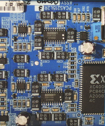

PCM1704
Enclosed photo is from LINN CD12 CDP.
