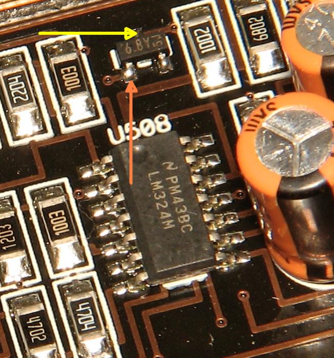

Slight setback with this amplifier. While trying to investigate the thermal light issue there was a slip of the VM probe and the amplifier no longer powers up. No low voltage supply operation either. I will post the voltages on the LM324 in hopes that the fault could be diagnosed quicker.

Is the 'yellow' terminal of the 6.8v Zener connected to pin 9 of the 324?
If so, is that zener open (does it have 12v across the orange and yellow terminals)?
