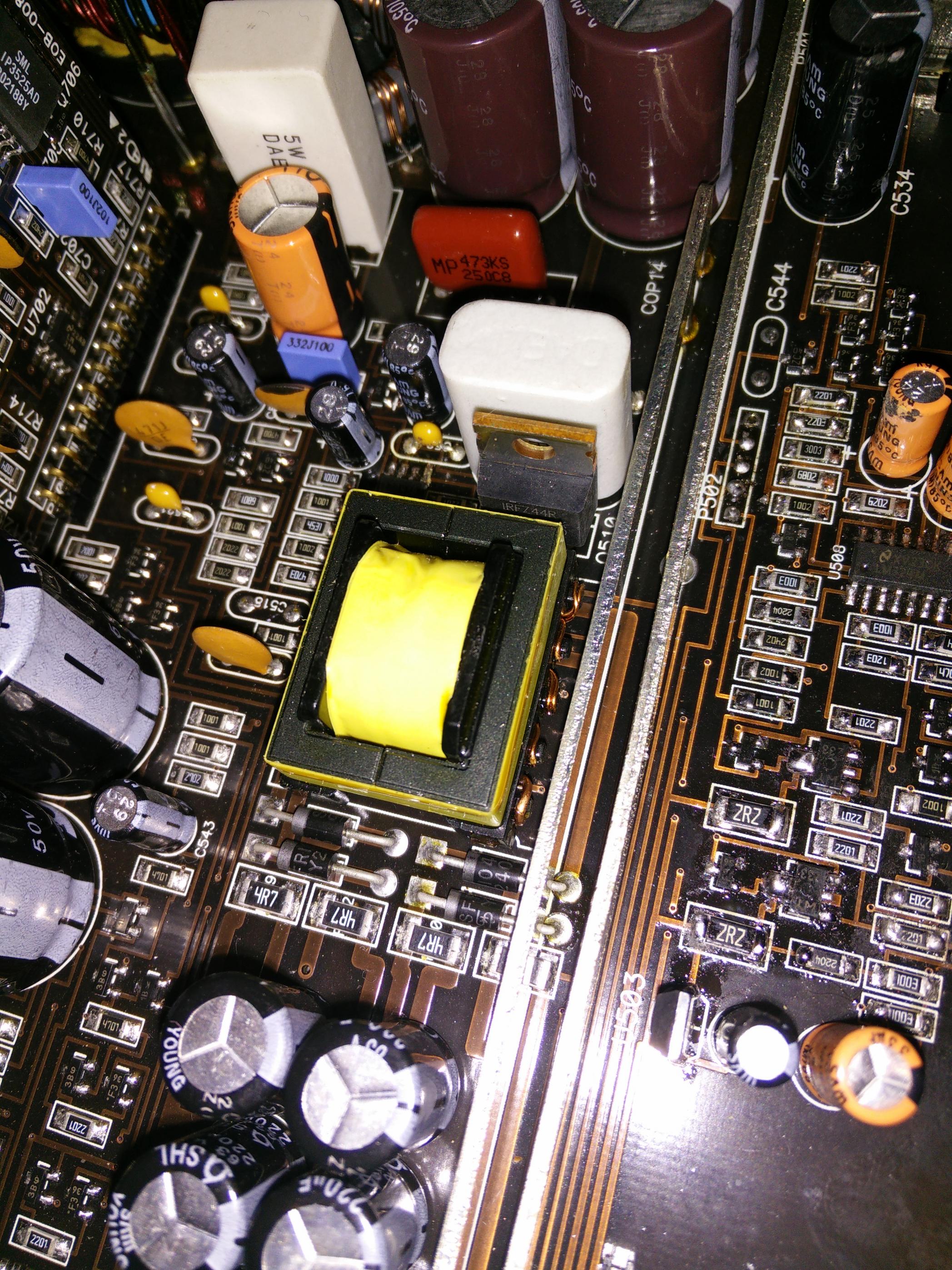

I don't have any usable voltage going to any of the op-amps for front or rear channels. I have 43v and 15v at the power supply with the yellow transformer and it is warm to the touch. I suspect the 15v is not reaching the op-amp power circuit.

There is a 5v regulator in the amp but I don't know where it is. They're generally somewhere in the center of the main board but it could be clamped to the heatsink. Find it and check it.
Can you describe what it looks like? Is it a regular TO-220 transistor? There is a transistor right next to the yellow transformer where the 43v and 15v are being produced.
Or is it one of the components that is mounted in line with the outputs, power FETs, and regulators along the heatsink?
I don't know what it looks like. The other amps of the same series have them. Some are TO-220. Others are smaller. I don't see it in the photos I have. That's why I thought is may be clamped to the sink.
The TO-220 transistor next to the transformer drives that transformer.
OK, to help me find it, can you answer these questions:
Where does the 5v regulator get its power from? The 15v power supply or the B+?
And, where does it then send its regulated 5v output?
The op-amp power that I am missing comes from where?
What pins are power and ground on the PS op-amps?
