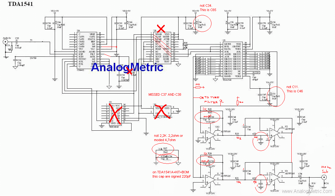

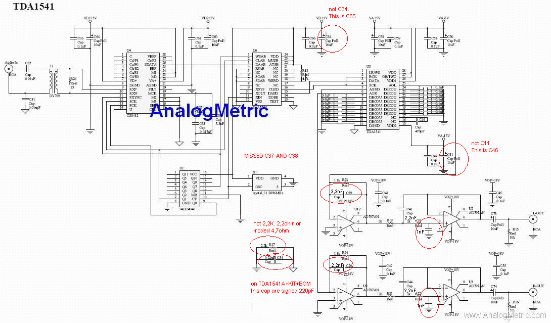

I Bought the AnalogMetric TDA1541 Board and i have the CS8412, TDA1541 for an old CD Player.
Does removing the SA7220, 7HC4040 and Clock make the sound any better, does it add extra noise?
How exactly do you remove those so it has no-oversampling or no-reclocking?
I don't want to use opamps in the signal path, i would like to use a tube filter i have 2 6n2p/12ax7's does anybody no the best circuit for this task?
in the datasheet for the cs8412 it says that pin 20 goes to 1K, 0.047uF cap to ground on the board it is not connected, is that ok?
My input to the DAC is the SP/DIF on my Mac Pro / Coax on back of TV
The output of the TDA1541 goes through the tube filter through 10K volume pot and connects directly to the DX Precision I Power Amp.

To bypass the 7220, you need to remove it and then feed the data from pin 26 of the 8412 into pin 3 of the 1541,
connect pin 12 (8412) to 4 of 1541
connect pin 11 (8412) to 2 of 1541
You can leave out the 4040 and xtal as well. The 8412 is configured for I2S out so no need to alter any other pins.

Didn't spot that M0 on pin 23 of the 8412 needs to be connected to 0v not +5v as shown, (grounding pin 23 switches FCK to output to drive the L/R switch (BCK) input in the 1541)
So to sum up:
8412 1541
Pin 23 to 0v instead of 5v
pin 26 to 3
pin 12 to 4
pin 11 to 2
omit 7220 4040 and xtal.

There is another little detail, normally there is a 1K ohm .047 uf filter to be connect to pin 20 of the CS8412, but in your schematic they connected it to pin 19, so it it should be connect to pin 20 like in the image I include.
Bye
Gaetan

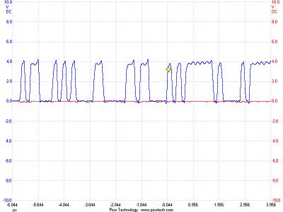

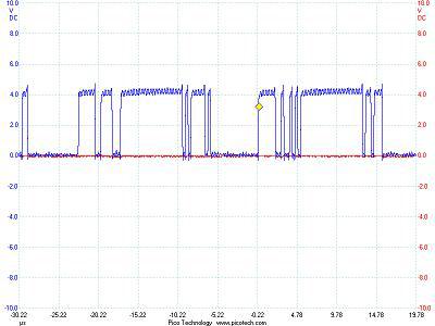

NOISE ON POWER RAILS & DAC DATA

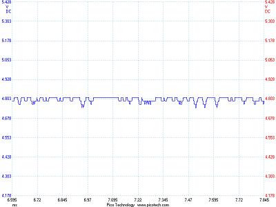

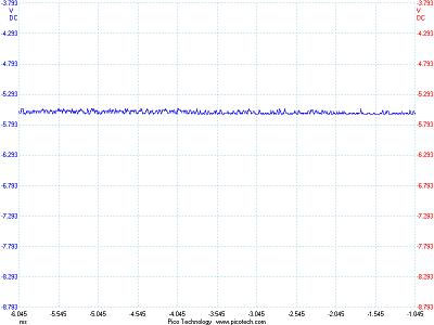

I bought a couple of old Philips TDA1541 based players off Ebay. A cd471 & cd373.
The attached screenshots from the 471 are of the + 5v and -5v power rails at the 1541 pins.
The +5v rail is only 4.8v and has about .25v of noise on it and the -5v rail is close to -5.6v and also has about .5v of noise on it.
The other screenshots are of the data, before and after the 7220 - ie before and after over sampling.
I don't intend to do anything about the noise as I only bought them as cheap transports with I2S signals for my dual differential dac with I/V transformer experiments.
When I get hold of an analogue scope I will look at the clocks as well (my Pico scope is only good for about 100kHz square wave capture).
