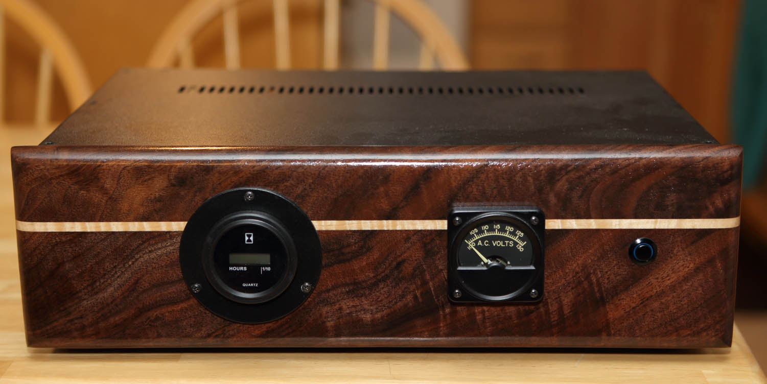

I feel like I cheated a bit by replacing a period hour meter with a new (silent) digital one, but here it is anyhow. I think it's time to call this project finished and move on to other things.
In order to make the smaller meter fit the larger cutout, I cut a circle out of some 1/8" Baltic Birch ply, made a hole for the meter, and sprayed it with some truck bed liner to give it some texture. Overall, it looks pretty decent.
