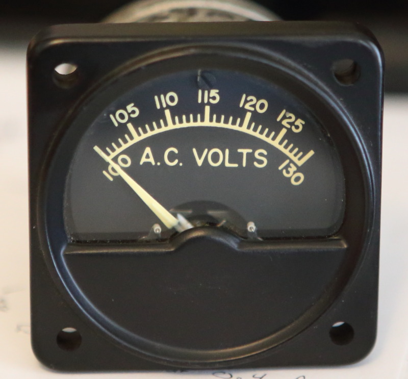

I have an analog meter that has a printed scale from 100vAC to 130vAC that I'd like to use to measure AC mains voltage. I am hoping someone can confirm my calculation of Rz which biases the zener diode in the attached schematic.
Here is what I have so far:
The meter coil measures 216R. Full scale deflection requires 87.3mV at 0.4mA.
I'll rectify the 120vAC mains voltage to DC, so the 100v to 130vAC range printed on the meter faceplate translates to a range of 141v to 183vDC, thus I have a 42vDC range to work with. I have calculated the value of Rmult as 42v/0.4mA = 105k ohms. For adjustment, I plan to use a 100k fixed resistor in series with a 10k pot.

This is the meter that I have. It has a nice AC scale on it, but obviously, runs on very low levels of DC voltage, this I need a simple circuit to make this read (semi) accurate AC voltages.
My plan is to use it on the face of a small box that will have a bucking transformer for a pair of tube amps I've built. The tube amp power transformer is wound for 115vAC primary whereas my household mains provide 122-125vAC mains. Thus, the power transformers are running a bit hot (75c - and it still pretty cool here in Pennsylvania) and I'd like to reduce the voltage and the heat so they don't burn up. The meter is just a "because I can" type of thing to go on the front of the box that will hold my bucking transformer.

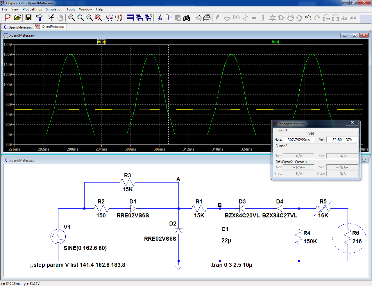

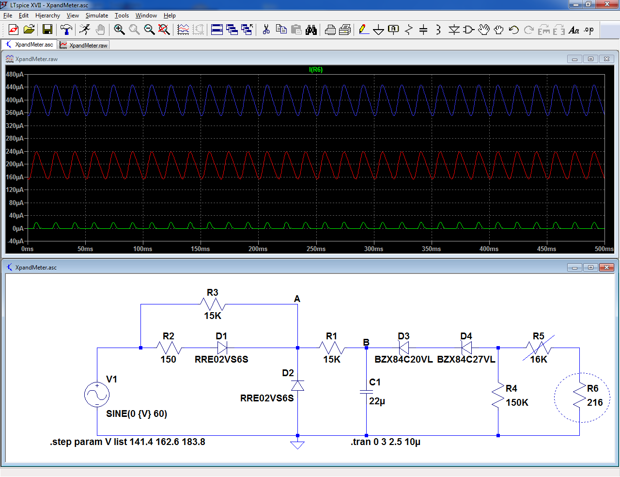

Here is a possible example, among many others.
In the simulation, the input voltage is stepped between 100, 115 and 130V.
You can see that the output current varies between practically zero (heavily pulsed, but the average value is negligible) and 400µA (FSD).
attachment.php

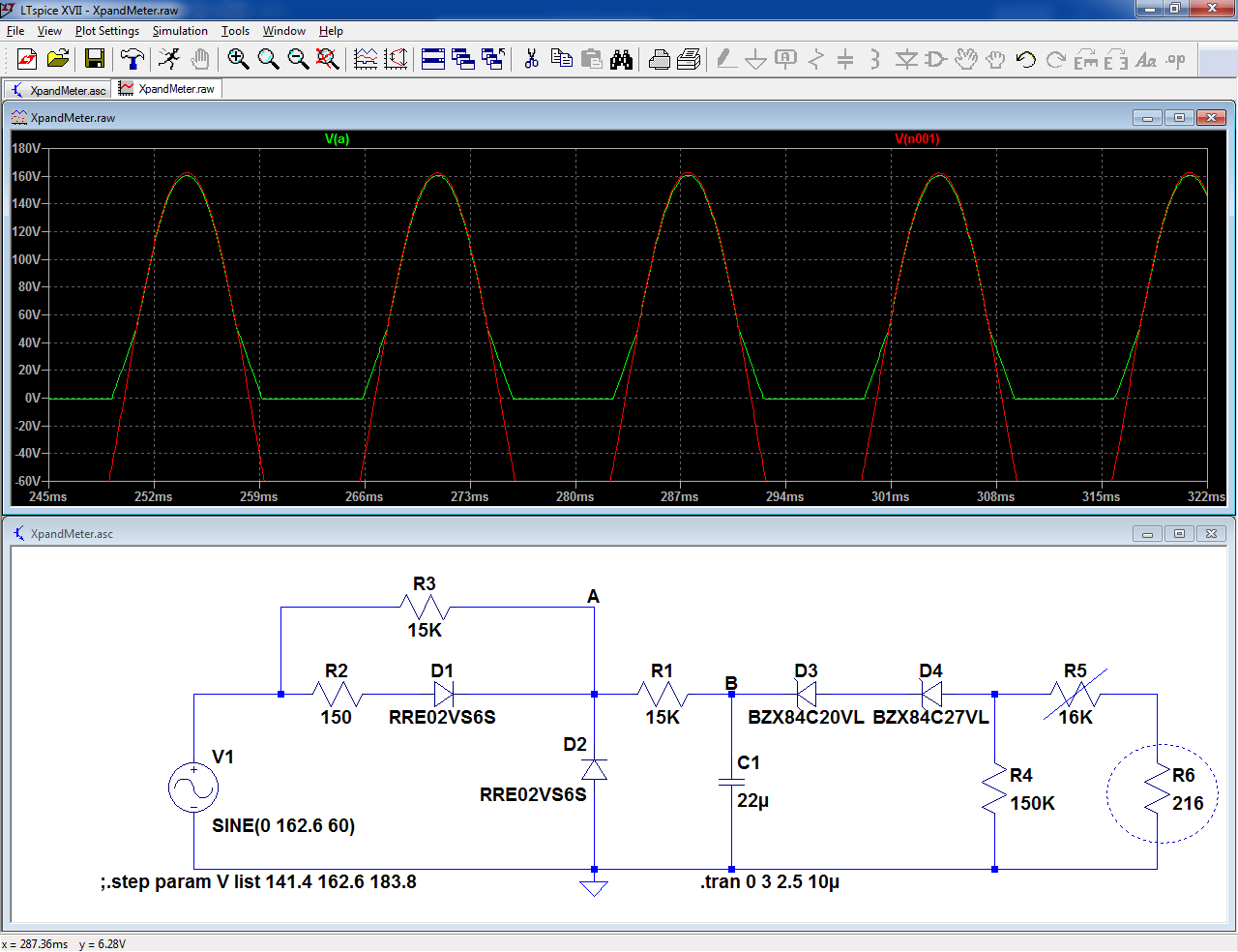

The diodes/resistors arrangement ensures that the voltage at the node A reflects the halfwave average value of the incoming waveform:
attachment.php
This sim shows the node A against the mains waveform.
You can see parasitic "skirts" on the green waveform, but their effect on the output is small, and anyway the size of the skirts depends on the filter cap voltage, which itself reflects the average value.
The effect is thus minimal.
It would be possible to eliminate them completely by making R3 smaller, but this would increase the dissipation over 500mW. Currently, a 1W resistor is sufficient.
Neglecting the output current, the voltage on the node B is the average value of the halfwave waveform for 115V: 115*√2/Π=51.77V:
attachment.php
You have to use a zener having a knee voltage in this region. I opted for a total of 47V in the sim, but depending on the actual components used, your mileage may vary. You can use R5 for the final calibration.

Since I have no experience with spice, I have a question about this circuit that you so kindly developed.
The diodes you specified are 250mW surface-mount variety. While these are readily available from Mouser, I'm not confident that I will be able to reliably solder to these tiny devices without cooking them. Can I substitute 1w 20v and 27v through-hole zeners (such as 1N4747A and 1N4750A), or do I need to stick with the 250mW variety? I could always order plenty of extras in the event that I cook them with my iron...
No need to worry: all the components are generic, and you can use your favorite 0.4 ~0.5W TTH type.
If you use larger types, like 1.3W, you may need to use a slightly higher voltage.
You can tweak the exact voltage by adding diodes or LEDs in series.
R3 is the only resistor that needs a 1W rating. The diodes can be 1N4007.
C1 needs a 63V or larger rating.

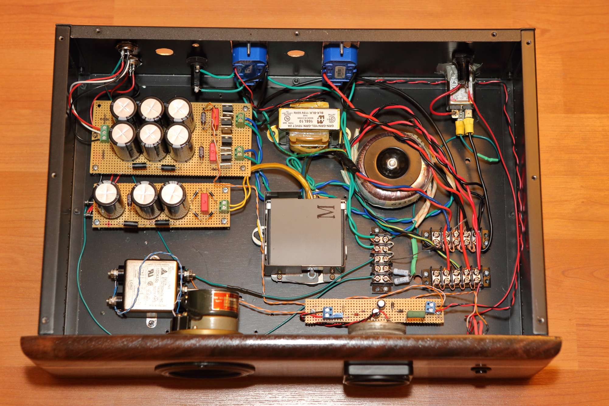

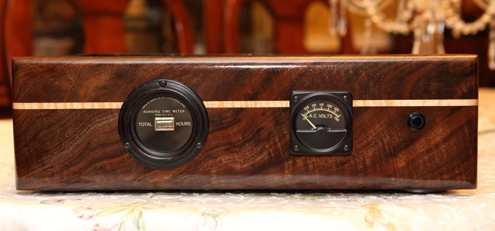

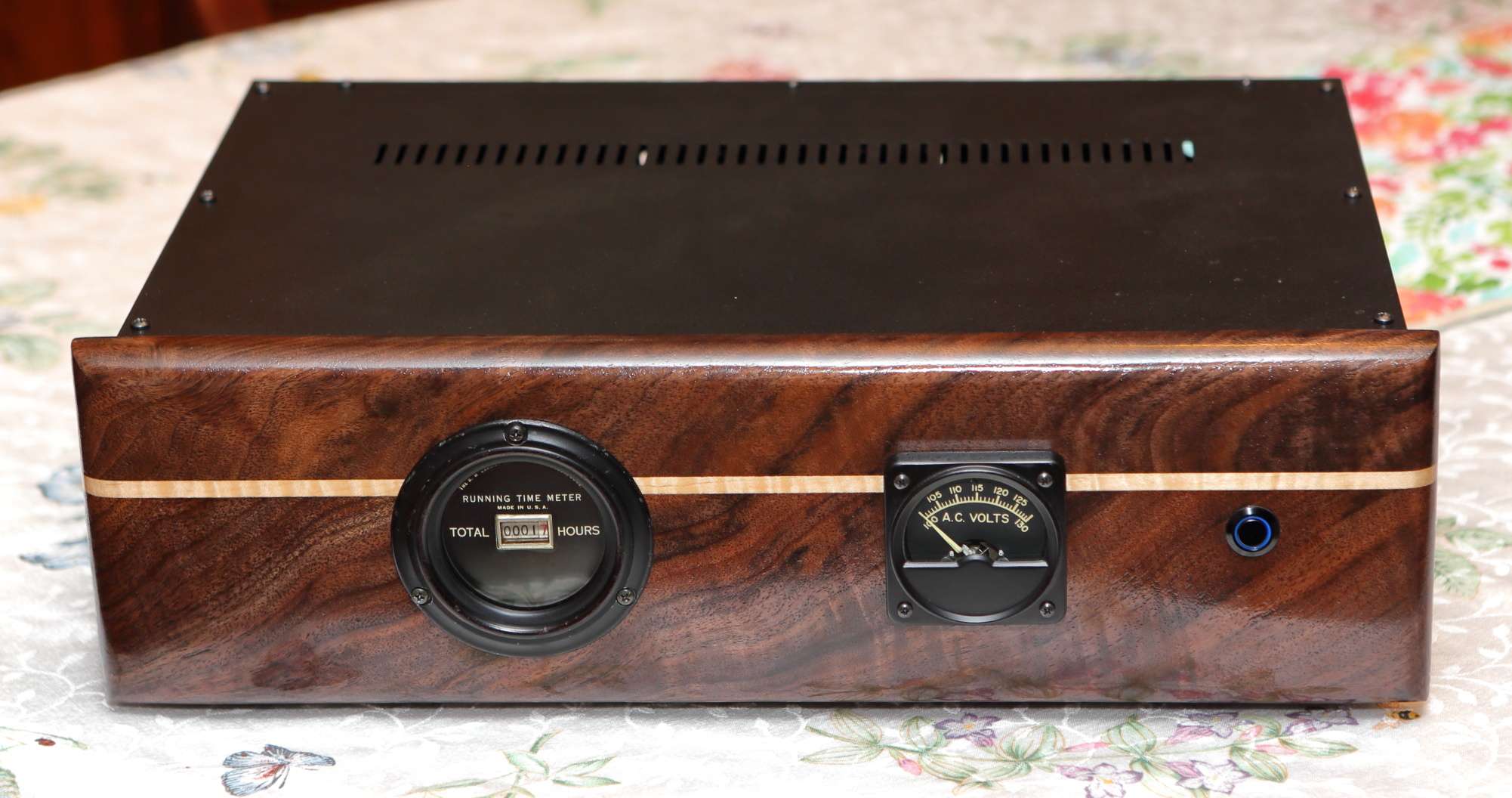

After a bit of work, here is the final product. I built one box that has the outboard supply for my turntable, Pearl II phono stage, and a step down bucking transformer to provide 115vAC to my 300B amps. The box matches my tube amps.
Thanks again for the help with the circuit for the meter, Elvee. It works great! I found a nice vintage hours meter to keep track of tube life, but it makes a bit more mechanical noise that I'd like. I might switch it out for a digital meter that fits in the same hole.
