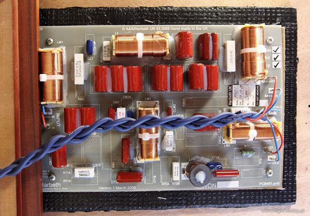

Lynn Olson is of the opinion that a low DC resistance on the tweeter coil is a good thing to reduce IM distortion arising from low frequencies getting through. Otherwise, it is questionable if you need to spend huge amounts on crossover components.
Alan Shaw of Harbeth is happy with wirewounds and smallish polyesters (MKT) on his top model. He also thinks that removeable panels are a GOOD THING! 😀

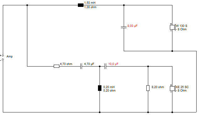

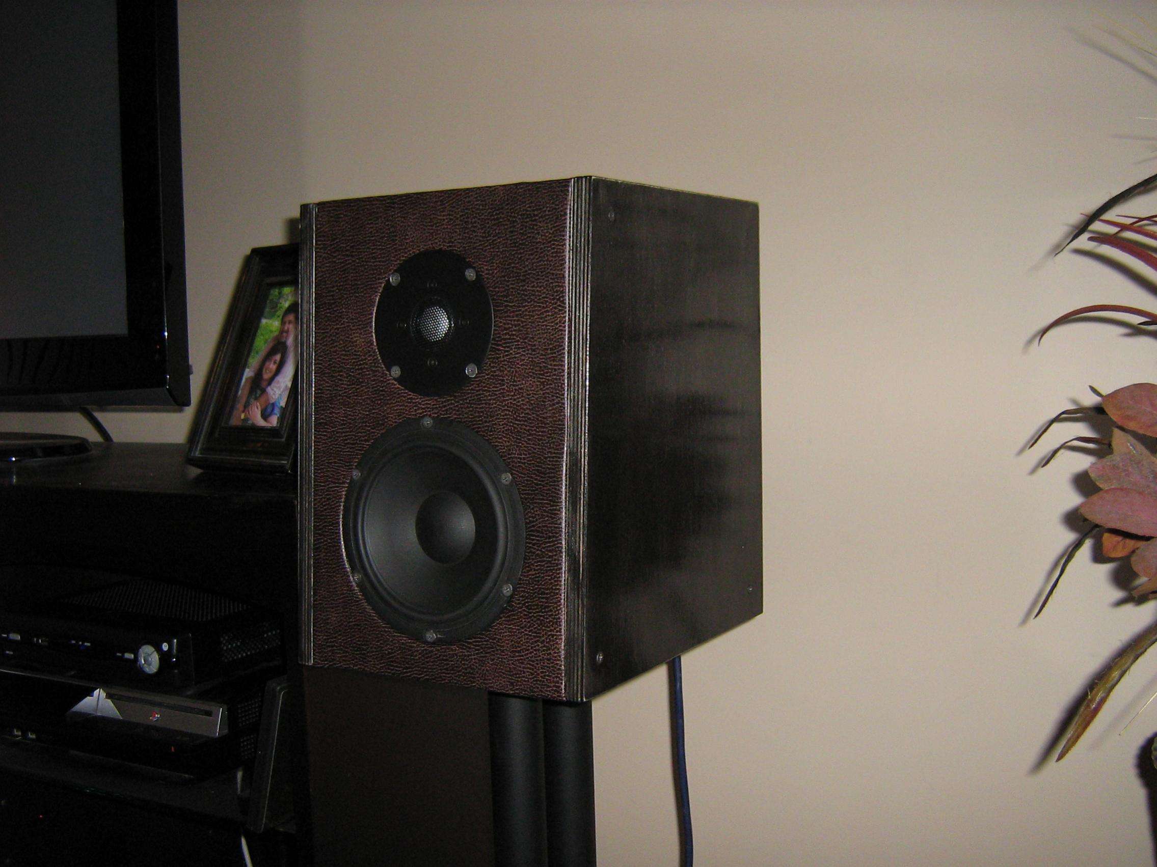

Update:
A couple of weeks ago I added the caps as shown in the 2nd version of the xover...put the tweeter back into phase with the woofer...much added improvement!!
Steve...been enjoying this build greatly!!!
Not sure if there is any more tweaks but give yourself a pat on the back...your xover was fab 😀

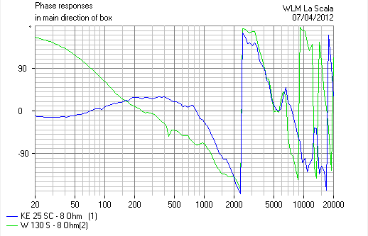

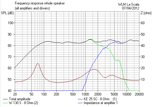

Thankyou, sideways (Dave)...😀
It wasn't rocket science. 😱
Lynn Olson is my guide:
When working with rigid-cone drivers, there are some hard choices to make: if you lower the crossover frequency to minimize driver coloration, tweeter IM distortion skyrockets, resulting in raspy, distorted high frequencies at mid-to-high listening levels.
If you raise the crossover frequency to improve the sound of the tweeter, the rigid-driver breakup creeps in, resulting in a forward, aggressive sound at moderate listening levels, and complete breakup at high levels. (Unlike paper cones, Kevlar, metal, and carbon fibers do not go into gradual breakup.)

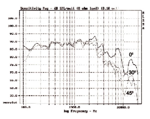

With the drivers we have today, the best all-around compromise is a 2nd, 3rd, or 4th-order (12-24dB/Oct.) crossover with an additional NOTCH filter tuned to remove the most significant HF resonance of the midbass driver.

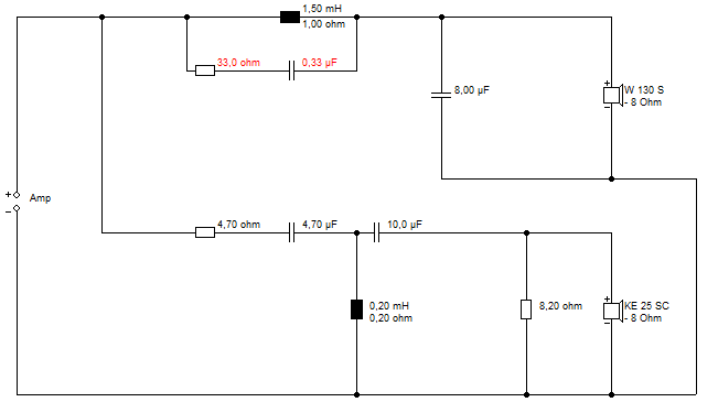

It MIGHT be worth trying a 7kHz tank/notch on the Morel HU_621 6" bass driver to straighten out the phase. After that, I'm out of ideas. THIS IS AS GOOD AS IT GETS. That is, until NFL kicks off again. 🙂
