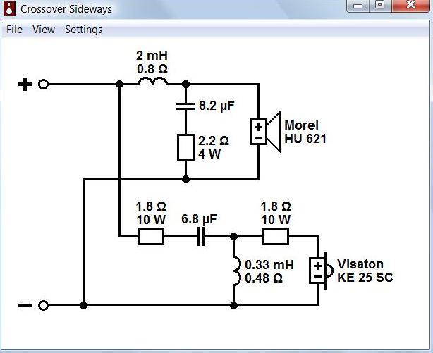

with your words, it tames the impedance rise
inductors gets more effective(bigger) with lower impedance
and, gets smaller with higher impedance
the result of rising impedance is a less effective inductor
tho your 2mH is quite big
you might want a smaller zobel, to be only effective at higher frequency, in the upper midrange passband
in any case, in this kind of simple filter, the zobel have positive effect in regards of phase
but needs to be very finely adjusted to do this
Actually the inductor on the tweeter is .2mH...quite small...and the tweeter has a built in LCR network in it already...I think that's what Steve was counting on...
Yesterday though, I reversed the polarity and had really good results...tamed that midband energy...so that means the series RC network is running on the negative side of the tweeter...
In Steve's xover, the tweeter is reversed already...I'll keep it like that for this trial and report back...

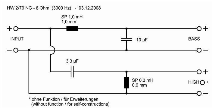

paralel inductor on tweeter cuts the lowest frequencies from the tweeter
in paralel its function is the opposite as to being in series
the same goes for caps
as for the tweeter 0.2mH being quite small, yes
means it cuts early
Dissi's 0.3mH looks more right, or normal
there is no standard one size fits all, ofcourse not
but with this filter some components and values are often very similar
but ofcourse always a little different

I'd like to know how Dissi arrived at that 2nd order crossover really. It could be very good, but I wonder what sort of data it was based and what considerations came into it. sideways wanted something low order initially but I thought the tweeter looked awkward on first order and overlapped with the bass badly, hence the second order treble. The bass might be good on a single coil because it has little cone breakup. 🙂
This is all guesswork really since Morel don't make it easy. The Visaton tweeter is an unusual beast with built in LCR correction of Fs resonance, but it also has an odd frequency response when you filter it as a result. You probably wouldn't go far wrong with the generic Visaton 3kHz crossover and a bit of padding, but time will tell.

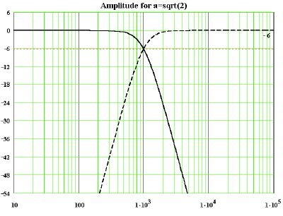

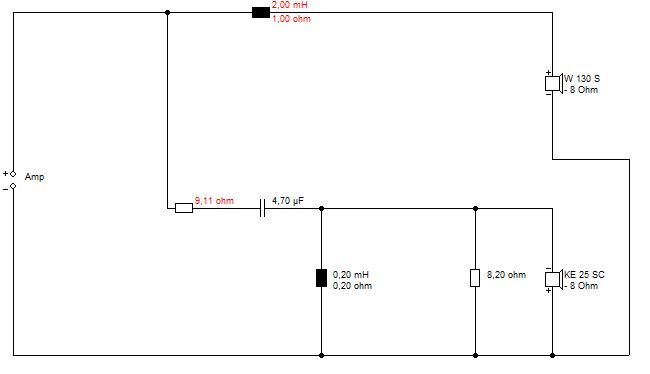

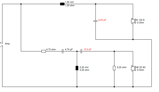

Ok...finally got in some parts...yeah!!!
Built the xover based on what Steve suggested...subsituting a 1.5mH on the Morel...and using a 4.7ohm resistor inline on the tweeter side...tweeter is wired as the diagram suggests...out of phase...which is supposed to put it back in phase witht he woofer I'm assuming??
Sound is really nice at the moment...it's changed a few times but I can see that with new parts...it's starting to have a more pinpoint soundstage...
Voicing and tone are very nice...nothing is exaggerated...so far LOL!!!
Bass is nice and as tight as I would want it...it still has that warm touch to it...great on jazz!!
So Steve...what is the actual xover point now of this design??
Thanks again for all your help!!
Dave

the 8R2 tweeter paralel res lowers impedance
means your 4.7uf series cap cuts higher
and together with the quite large 2mH woofer inductor cutting low.....?
try placing tweeter series res on the other side of cap, getting impedance up again
being able to use smaller cap is one of the nice advantages of a series res att
I would expect tweeter polarity should remain reversed
unless other weird things are happening
maybe also try to tilt the hole speaker

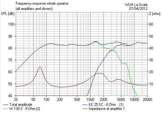

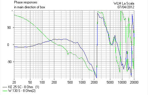

I modelled the tweeter fairly carefully, as it goes, Tinitus:
http://www.diyaudio.com/forums/multi-way/222388-need-help-xover-please-2.html#post3219603
1.5mH and 4.7R at the input to the tweeter filter should all be doing the right things here. It's a 3kHz crossover, low order as requested.

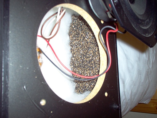

Dave, this all sounds excellent. Lining the top, bottom and sides of a bass reflex with stuck-on damping material is my current wheeze for the smooth sound. You'll want a bit of fluffy wadding at the back panel too. Not enough to mess up the airflow for the vent though.
http://www.diyaudio.com/forums/multi-way/221923-upgrading-mordaunt-short-ms15-bookshelves-2.html#post3210112
IF you want to experiment further to remove any residual cone breakup harshness from the woofer, you can shunt a 8uF across the bass and swap the tweeter phase. An additional 10uF on the tweeter gets its response and phase better too. You see, I was thinking ahead here. 😎

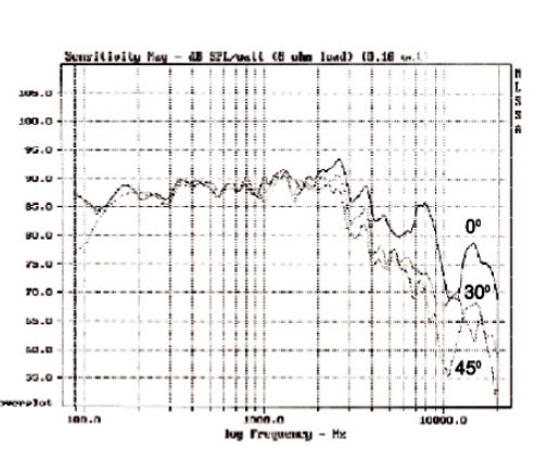

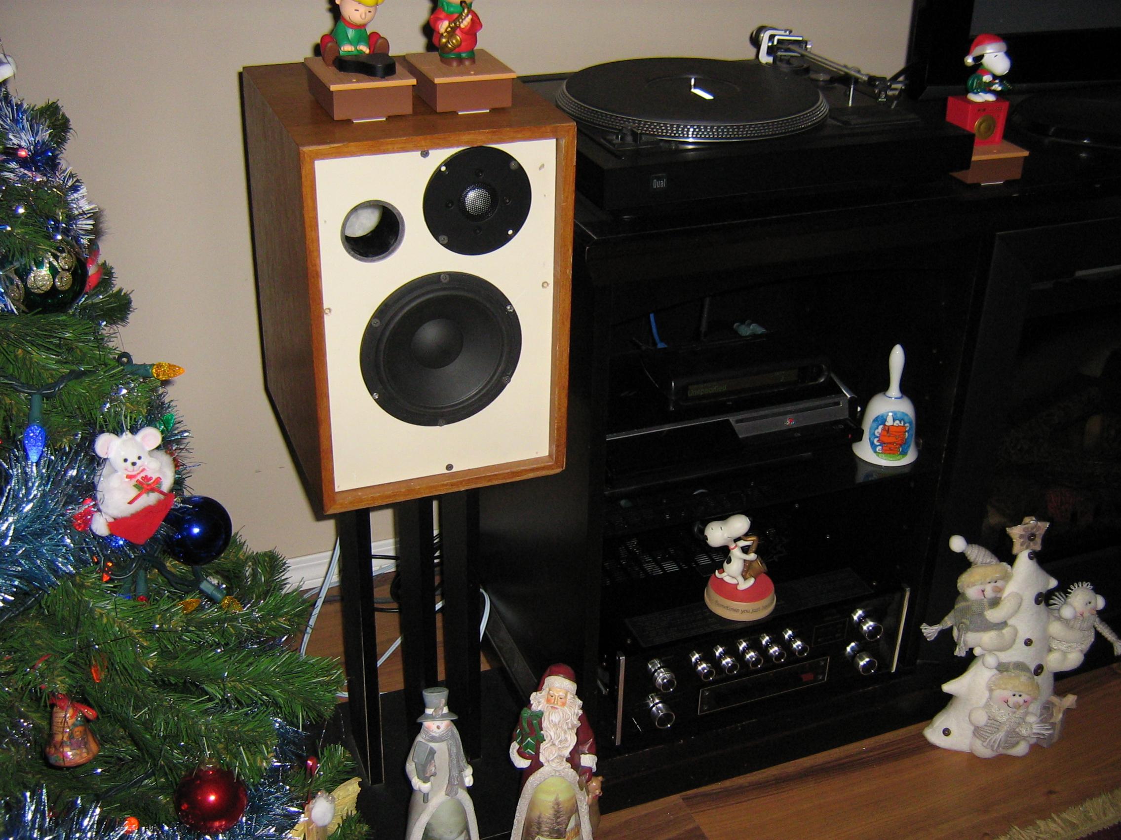

Are we going to get some pictures?
Pictures?? ROFL!!
They are in ugly cabinets that I reused with a different front baffle...leftover from a set of broken Tangent TM3's!!
K...you asked for it 🙂
These are what I've been using to "test" out drivers...lots of different baffles have been put on LOL!!!
Right now...xovers are just laying nicely on the bottom of the box...

Very nice indeed. Seriously. A box is a box. 🙂
You have to be the judge of when you are happy with the final result. First order bass polycone and second order tweeter is a classic setup used on the original KEF Celeste. Going higher order raises problems like the dreaded 1kHz midrange shout with polycones.
