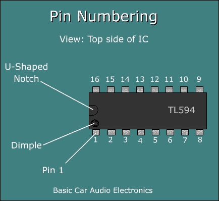

Pull the power supply transistors and post the DC voltage on all 16 pins of the TL494. Place the black meter probe on the amplifier's ground terminal. Place the red meter probe on the point where you need to measure the voltage.

Pin 1: .06
Pin 2: 4.54
Pin 3: .06
Pin 4: .01
Pin 5: 1.51
Pin 6: 3.54
Pin 7: 0.00
Pin 8: 13.68
Pin 9: 5.12
Pin 10: 5.13
Pin 11: 13.68
Pin 12: 13.23
Pin 13: 4.99
Pin 14: 4.98
Pin 15: 4.98
Pin 16: .03
