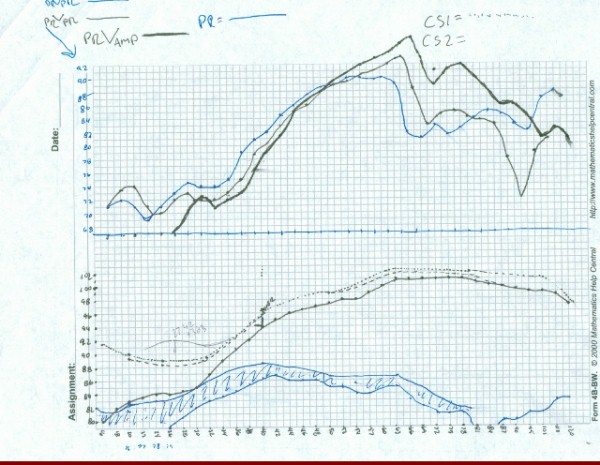

Well thank you for imparting wisdom anyways. here is a scanned pic of the freq response i have taken thus far. the graph on top is taken in the backyard from 3 different angles at about 6 feet away, 2 feet off the floor. the bottom graph is a close mic of the subwoofer and the PR. any dotted lines or shaded areas are measurements with radioshack corrections added. on the top graph there is a major dip in response at about 63hz, like 13db or so of a dip. The close mic of the sub has no such dips. any one able to translate this graph?

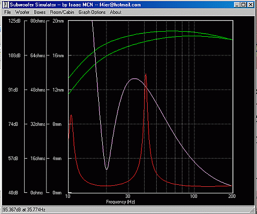

Here is a simulation of the Parts Express #295-190 in a 120 liter, (4.3 Ft³), box with two Drone Cones tuned to 20 Hz.
The drive voltage is 32 volts, which into 4 ohms is 256 watts-about what a good subwoofer amp puts out.
The lower green line is the whole system output into half space-the way most speaker programs graph it.
The upper green line is the output using average room gain.
The purple line is the speaker's cone excursion at 256 watts.
The red line is the impedance curve. Not how the box tuning is the lowest point between two peakes. That is how it is in a Passive Radiator or vented box.
The simulation program is Subwoofer Simulator by our own member, F4ier. This freeware program simulates many, many curves. These are just a few of them. The file to make room gain shown was done by Serow, another member here.
Pretty good output for a single subwoofer. At 20 Hz, without room gain you are at 108 dB at 256 watts. With room gain you are at 114 dB.

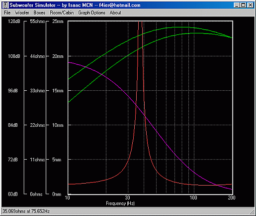

And here is the output with the Passive Radiators tuned down to 10 Hz.
Upper green line = response with room gain
Lower green = response in half space
Purple = Cone excursion
Red = Impedance
256 Watts power.
As yu can see, bass output goes down slightly.

I had to measure the TS parameters myself because i couldn't find them anywhere on the net and the mtx folks weren't too helpful.
Re: 7.1 ohms
Rmax: 29 ohms
Fs: 24.5 hz
Rx: 14.349 ohms
F1: 17 hz
F2: 36 hz
Qms: 2.606
Qes: .8448
Qts: .638032
Cms: .000704207
Vas: 972.42 Liters!
+30 grams Fs2: 20 hz

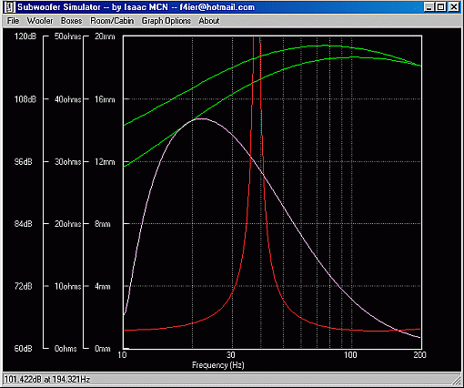

Okay, I am just going to punch in the sealed box graph then take a look at things tomorrow.
Here is the graph for a closed box, 120 liters
Upper green line = response in room
Lower green line = response with typical room gain
Red line = impedance
Purple line = cone excursion
As you can see, the sealed box offers slightly less output than either ported box.

So your output at 30 Hz is about 20 dB down from 63 Hz ?
Was this measured on the ground out in the open, or on the ground against a wall?
One speaker writer simply measured his sub from 4 feet away, with the sub on the driveway against his garage door-which was closed, of course.

By the way, a quick calculation with Subwoofer simulator says that two Passive Radiators like that require 1.4 kilograms to tune them to 20 hz in a 120 Liter box. That includes the mass on the cone already before adding anything-whic is probably about 125 grams each or 250 grams totoal.
So 1 kilogram total for the two PRs was pretty good bet for this box.

Yeah it appears that way, maybe it is the "PR's" i am using, i saw some stryke audio 15" PR's for 70 bucks, they have the needed excursion (like 30mm), these mtx's probly have like 7mm. Xmas idea for the wifey maybe?
I measured these on the ground about 6 feet from the speaker in an enlosed backyard with no roof, about 9 feet by 17 feet. my sub was on the ground and the spl meter was 2 feet off the ground. tomorrow i will probably drag it out on the front lawn with an extension cord.
