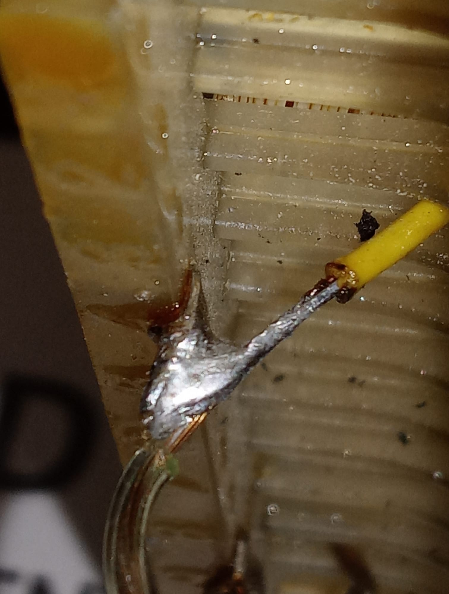

Strangely - it was a cold solder joint at one transformer. Maybe varnish caused the problem or maybe it was being submerged in water. At any rate I soldered the transformer wire to the post and it was back working. As I was sorting this out I contacted Ben Peters and he was checking with the company that made the transformer. They were willing to make me a replacement but I didn’t end up needed one.
