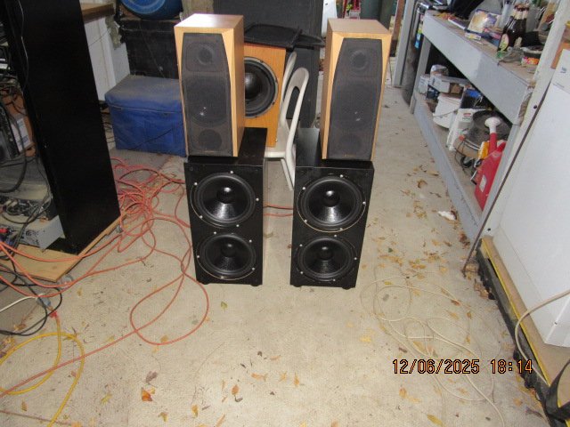

Often used to give more bass to a 2-Way speaker but can be used to do the same with a 3-Way speaker. I suggested using a pair of [2 * 12"] so that there would be a 4R load which could utilise a smaller value of inductor because sometimes 2 budget woofers can be cheaper than one good quality 4R woofer and high value inductors are very expensive and around here used 12" seem to be cheaper and more of them around, also a box high enough for a 12" raises the older box to the right height many times
An alternative is getting a cheap electronic crossover such as the Behringer CX2310 (cheap second hand if possible) and a separate small second hand power amp, I do this as being cheaper than a pair of powered subs
.5woofer I guess you mean a 5" woofer for extremely low frequencies? to add on the actual system with a separate amplifier?
can you show me a photo of a 2*12" to have a idea?
Do yo suggest a pair of 2*12" in parallel giving 4ohms impudence ? how would I wire this on the system?
