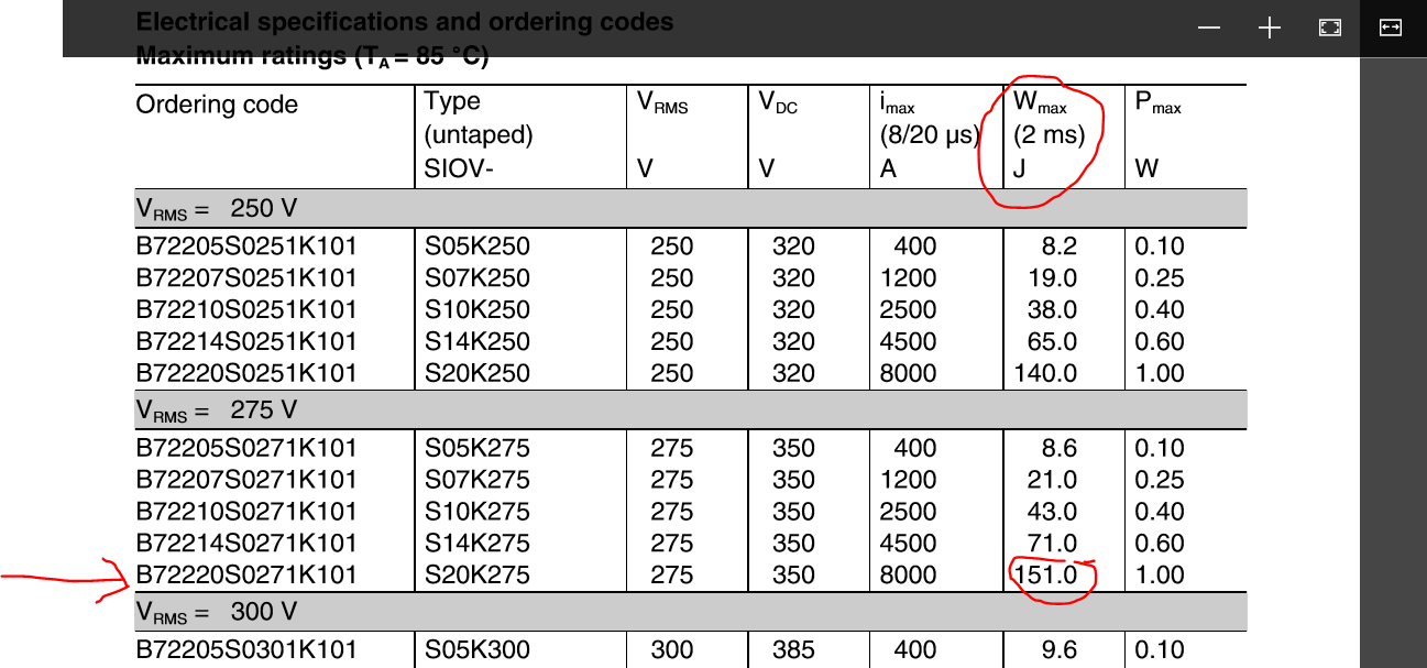

That's why I use an MOV across the transformer primary windings. Even just this part will extend the life of power switches quite a lot. It eliminates the turn-off arc.

Hi Andrew,
Normally it doesn't conduct, so its out of circuit. Only when you have a voltage surge will it operate. So make sure the MOV you select isn't too close to the operating mains voltage. I used to use a 130 VAC MOV here. Now that is very close to the operating voltages in North America. When I was installing them the AC voltage was running about 117 volts (measured). I think the next firing voltage would be 150 VDC for me. You're lucky that the 240 VAC customers have dropped to 230 VAC. I wonder if people who were at 220 VAC had any problems once 230 VAC was standardized?
Anyway Andrew, I think you'll like having the MOV in there if you have any equipment that goes "snap" at turnoff. I do know that customers that got the MOV early in my career didn't require new power switches when a lot of the equipment did (Marantz).
-Chris
For UK mains you need a 275 vac device of 'high Joules' rating. These things are cheap to, around £0.50
This is from the Epcos range.
