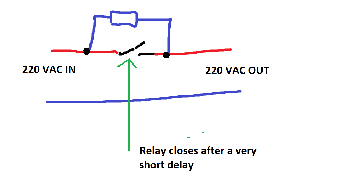

Bought this from ebay and I'm a bit curious as to how exactly it's supposed to work, because if I measure the output, it goes to 220v pretty much instantaneously when power is applied, even before the led goes on and the relay click.
Is it working? Is a soft start supposed to work like that?

So, you bought this "soft start" thingy and you don't understand how it is supposed to work? Google is your friend, but I will summarize:
The soft start circuit (the thingy) is intended to be placed between the mains supply and the transformer of a power supply, usually only when the transformer is about 300VA or greater. High VA transformers, when not powered (e.g. disconnected and measured for DC resistance) have very low primary winding resistance, close to a short circuit from the standpoint of your mains supply. So, when you switch on the power, current rushes in to the very minimal load in the first instant. This can trip breakers and blow fuses. Very annoying! But after 100 msec or so, the current flowing though the primary winding creates a magnetic field that resists the current flow and this persists as long as the primary is powered. Now the current flow is determined by the load on the secondary (ignoring losses, etc.).
If you could only prevent that first inrush of current, everything would be fine! Well that is what the soft start is for. One simple approach to this task is to insert either a thermistor (temperature dependent resistance element) or a resistor bank inline for only the first few hundred milliseconds before the magnetic field in the transformer core has developed, after which the resistance is removed from the circuit. This is what I suspect your board is doing.
Now, why do you measure instant-on of the mains voltage? Well you don't have anything connected after the resistors, on the output side. As soon as you power it up, current tries to flow but sees infinite resistance (the output is an open circuit) and without any inductance or other reactive component to slow current flow it immediately pushes up the voltage at the output to the input voltage. That's just electricity doing its thing.
Even with a transformer connected the relay will bypass the resistors in a very short time that you will not be able to measure unless you have an oscilloscope.

Please WAIT on that. We need to determine if that's the right way to hook it up.
When the relay closes, is the output DC or AC? I don't see a rectifier block.
So it's probably AC output. If the output is AC, it will blow up the capacitor.

It appears that your soft start circuit is intended to go BEFORE the power transformer.
DO NOT connect it directly to that board. The input voltage would be way too high,
causing an explosion, and there would be no isolation. Very dangerous.

Simple answer. Yes it is supposed to work like that when tested as you are doing.
It looks pretty straightforward to me and yet you seem to have a lot of misleading replies amongst all that.
The board is self contained and simply places a resistance in line with the mains feed. After a very short delay a relay 'shorts out' the resistor allowing full current to be delivered to the load connected to the output.
The voltage at the output with no load attached will equal the input voltage in just the same way that measuring a battery voltage will give similar results even if you place a series resistor in line with the meter.
It is the impedance or resistance of the load that will determine how much of a voltage drop the circuit causes.
The four diodes and other bits and bobs on the board form a power supply for the timer (a watt-less dropper... Google it ) which means that all the circuitry on that board is live at all times.

It will last a long time, even starting a big transformer.
The bigger problem is switching off an inductive load. It's the back emf of the OFF event that burns/welds the contacts.
The resistor is a current limiter.
At start up the resistor is in circuit and the current pulse into the "off" transformer is limited to a lowish value. This resistive start current does not pass through the bypass relay.
Once the delay has expired the transformer is "online" and the bypass contacts will see a current load that results from the transformer switching from a resistor fed supply to a direct on line supply. This small pulse is an easy load for a closing switch. There may be <5Vac (~7Vpk) across the switch when the delay bypasses and the main Inductive loading has passed.
When one comes to switch off, the bypass relay is still closed. The inductive load is seen by the main ON/OFF switch. This is the contact that sees the big inductive pulse and suffers burning during the switch off event.
The bypass will open after the transformers back emf has stopped ringing into that main ON/OFF switch, this ringing probably lasts for <<1ms. The bypass relay does not switch off the transformer.
