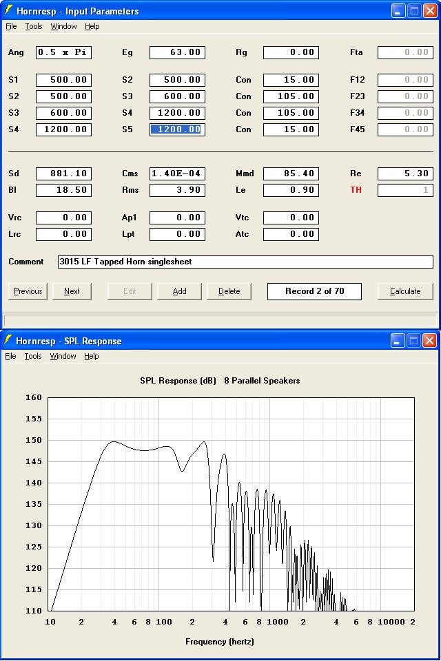

these posts are awesome!! the knowledge is good.. regardless of hearing loss I am building this system.. I am not sure if I can go 4 double 15's or 18's because i don't want my house to look ridiculous when i have guests in the living room but here is what i will give up for space 7ft wide 7 feet tall and 3 feet deep.. What is the loudest I can get with that type of box space.. Oh by the way this is a corner area behind my 65" tv which is on a stand i can post picture if anyone needs.. currently you can't see my two TH 3015LF's which are behind the TV and stand 44" tall..
With that much space you can choose any cabinet that floats your boat... including the one you currently have. Just lay them on their side mouths together in your corner. You can use kappa pro 15lf2's to keep the cost down. (since 3015lf's are expensive these days)
Build as many as you think you need. Personally I would go for just short of your goal, and build 4 additional for a total of 6.
http://www.diyaudio.com/forums/subwoofers/185836-3015lf-th-35-40hz-but-only-20-deep-help-3.html Although 8 should fit in the space you have.
This is just an up/back TH. start at 4"x16" go up to 6"x16" and back at 12"x16"...

If you have a big screen TV in the room to play movies and are willing to give up that kind of space for a subwoofer, (I estimated an internal enclosure volume of 112.7 cubic feet deducting for 1.5 inch enclosure walls and also 10% for bracing and vents), then I think you are making a mistake stopping at only 40 Hz or even 30 Hz.
As long as you are going to go this big, you should be able to get outrageous output down to 16 Hz and yes-you will feel the difference. There's a whole sonic world down there below 40 Hz-and most commercial subwoofers are too small to really access it.

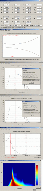

so currently for build options i am seeing 6 of my Th's or the othorn thing .. anyone else have any designs for boxes ?? that work within the given space.. I kind of would be interested in the down to 30hz option if someone has a box for that .. and i could do down to 30hz at say 130db .. that should make some people sick literally ha
Surface area,Surface area,Surface area, is your best bet.
I am not trying to push dipoles by any means but you can get alot of displacement in a much smaller area then the box method and you should have a much lower THD figure as well for a much cleaner BOOM !
