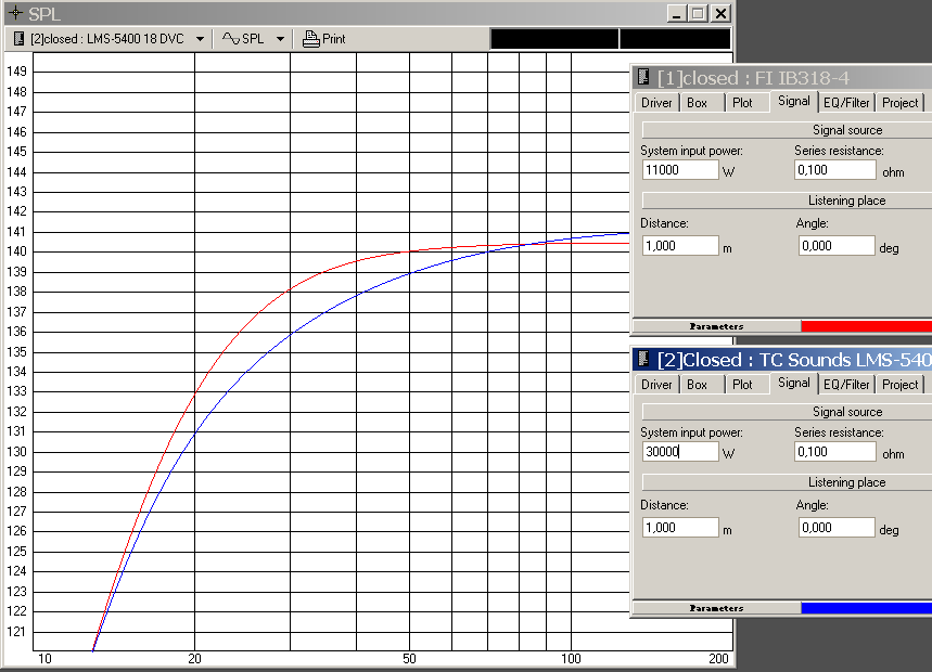

If you need to go also low, IB installation using attic as backspace is one option. Then you need just 8 LMS-5400 with 30kW or 12 FI IB318 with 11 kW.😀
Simulation have 4'th order high pass at 15Hz to get more output without bottoming drivers below 20Hz. Room should add few db to low end.

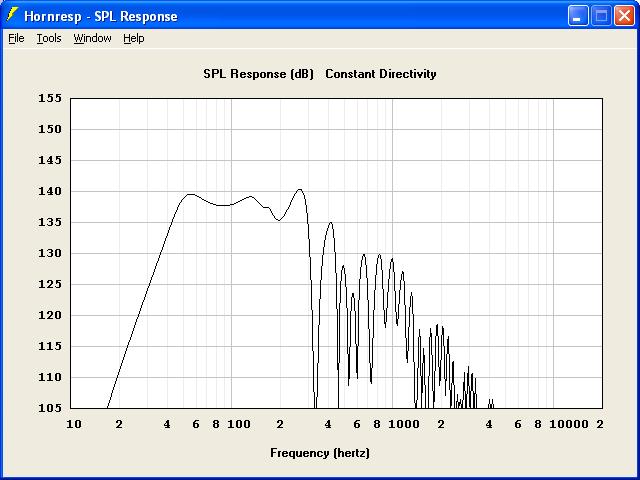

This the the link to the spreadsheet I used to come up with my numbers.
In the past I have compared it's figures against other speaker design programs and is at least within 10% and/or better with the figures from winlsd.
So,Anyway, I trust it.
Yes you can get 140db at 50hz fairly easy,But as you go lower your displacement requirements go up drasticaly.
justint, Had specified 40hz so I was going for a lower frequency's of 25hz to 35hz as this would help to compensate for the extreme excursion and thus lowering the THD at 40hz at that level.
Although you may not hear the difference in the room, But, If the system was outside you would.
