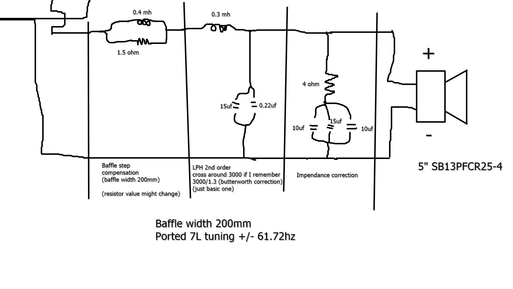

I can make something if its just a single full range speaker (basic, ported or sealed + a capacitor & then simulate it on WinISD + some plywood). but crossover for 2-3 ways is where I'm stuck because I can barely understand anything or how to connect them.
I always lurk in this site to learn as much as I can.

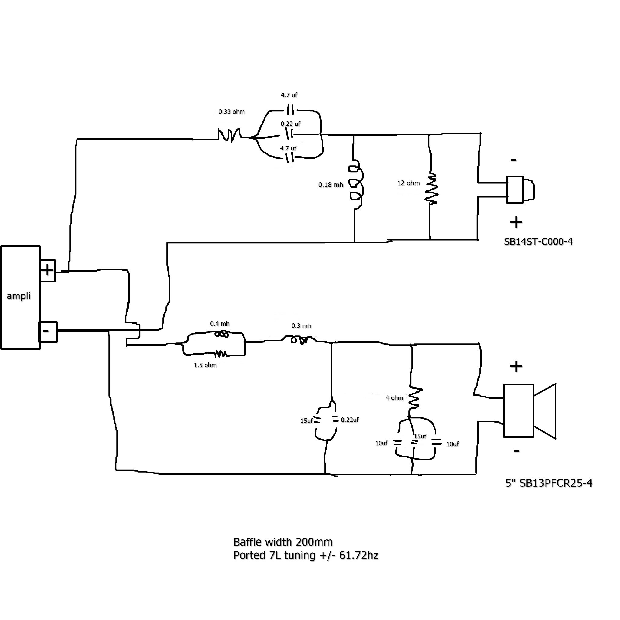

lets say I wanna use these 2 as speaker.
https://sbacoustics.com/product/sb14st-c000-4/
https://sbacoustics.com/product/5-sb13pfcr25-4-paper/
is this crossover close enough? (picture attached)
p.s. I tried the simulator but still can't get the hang of it, not using that for now (at least until I can learn on using it). plus I don't have any means to measure. so atm I'm just hoping from the online specs & do a bunch of calculation (head hurts)
result might be bad & gonna start all over again calculating stuff, but ah well gotta start somewhere for learn stuff

Without modelling it you will not know approximately how well it works. The once built you will have to fine tune by ear, not easy.
Is it a local published circuit, some of the elements need their function explaining in more detail. I.e. why is there two inductors with one modified with a resistor and also in the bass leg, the impedance compensation of 35uF seems high.
In terms of achieving something that works correctly, doesn't the SB Acoustics Micro with downloadable drawings and crossover design already documented seem like a sensible choice for a first time build. Possibly the micro C if you have extra funds available.
See here https://sbacoustics.com/product/micro/
Your chosen drivers are fine, but they need correct cabinet and crossover to make them sing. Difficult to do this without good measurements in the first place.

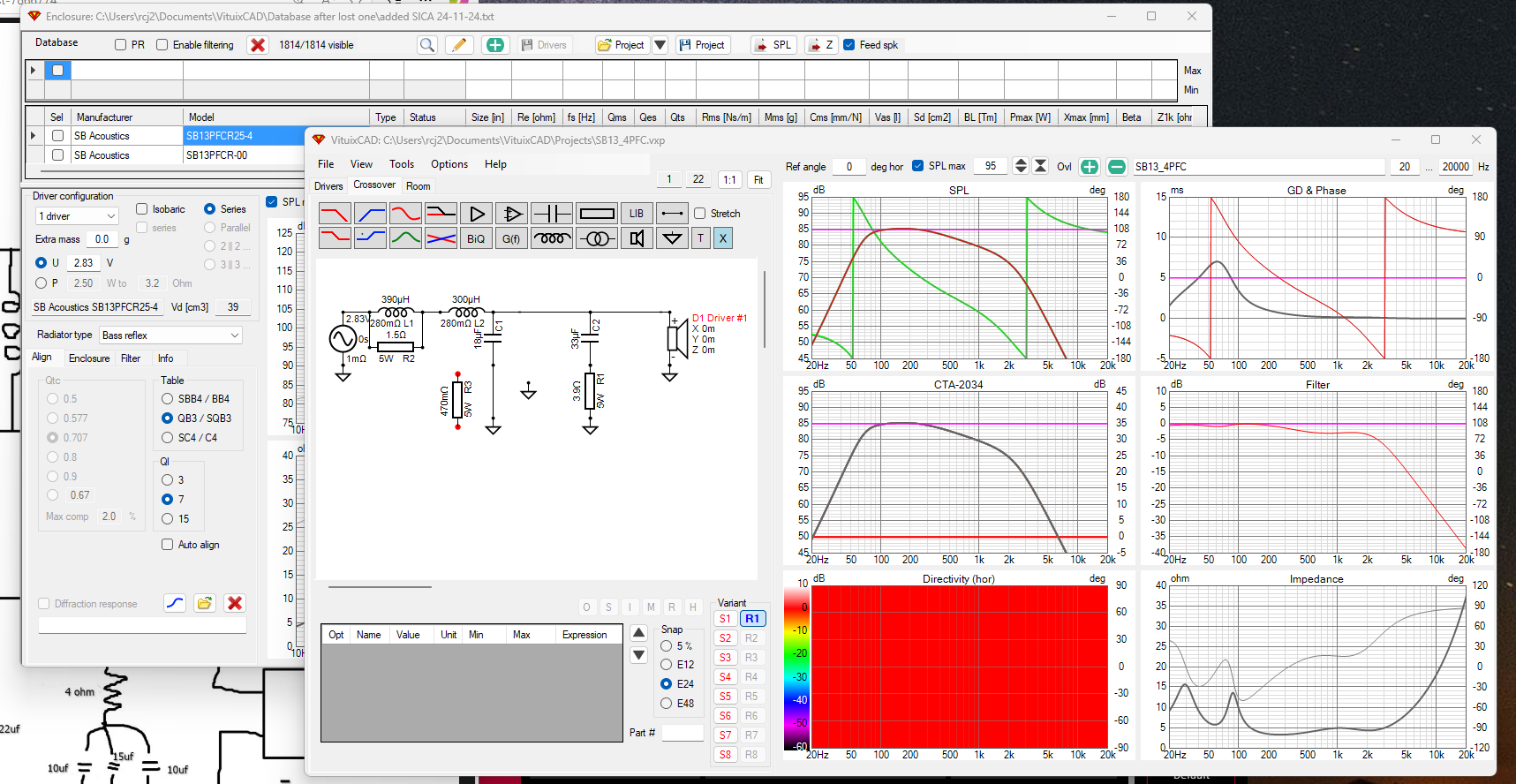

I had a quick look using the electro-mechanical properties of the 4 ohm 13cm PFC driver included in the VituixCad database. Approx 7 Litre cabinet. The impedance correction and inductors provide the indicated Xover slope.
This is not a full representation of what the frequency response will look like. It indicates Xover function based on the electro mechanical properties of the driver. It is useful to see Xover function, group delay, Phase and Impedance.
A powerful check of the basics in terms of the Low frequency leg of your Xover.

thank you very much for the suggestion. I was looking at ur graph so that is what those zobel & baffle step correction circuit do. do note that the value of capacitor and inductor is basically what is available in my country (at least the film one for the caps, not electrolytic bp)
