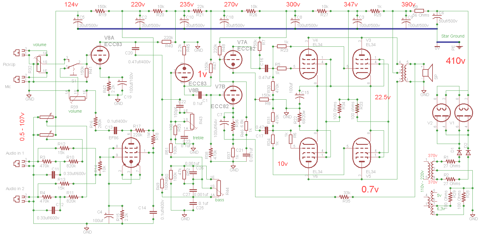

The volume control is connected at pin 6 of EL86 and then can be switched to pin 3 of ECC83. There is a pot to inject some DC voltage to source 1 and 2, maybe to elevate the input signal. That´s what I do not understand.

If the output is suposed to be 800 ohm then you get 240V~ there at 70W.In that case a feedback resistor of 330k is very possible.
To get the ~voltages I put in, the feedback resistor is 240k.
As I mentioned the inputs of the EF86 has a phantomsupply.That is the input carry a positive voltage (adjustable with the two trimpots),don't connect something whatever.Probably for mikes that consist of a capacitor changing with air pressure (sound vibrations),they need a voltage across them.
Since I wrote down the sensitivity on several points in the amp.choose an apropriate entrance to put a vol.control there.

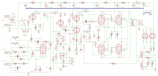

I re-drew the schematic in a more conventional manner, to make it a bit easier to follow. It looks like a pretty straight forward PA amplifier, if you want to convert it for hi-fi, you should bypass the tone controls and the input switching/phantom supply. You may not even need the EF86 if you are driving it with a CDP. Of course, as Ketje suggested, the feedback network needs to be changed to accomodate the new OPT, especially if you are going to wire the output tubes for UL operation. When all is done, you are going to end up with a pair of very cool vintage monoblocks, congrats!

The drawing is much better. Which software did you use? It 's much better to understand.😉

I"m guessing that the value of the cathode bypass caps on the middle two triodes sould be 47uf, not 0.47uf.

Glad you like it, this is the program that I use.

Downloaded. I found it very nice to draw schematic. Eagle is good to PCB, but not so good to draw only wire/components .... I will try to learn and use next time.

Which one? I didn't find 0.47uf capacitor. Do you the number of it?
I guess something is wrong with feedback loop. The OT is 5k/8. I will have to buy a new one to fit the power amp. The rest seems good. The input on EF86 varies from 0.5v to 107v.

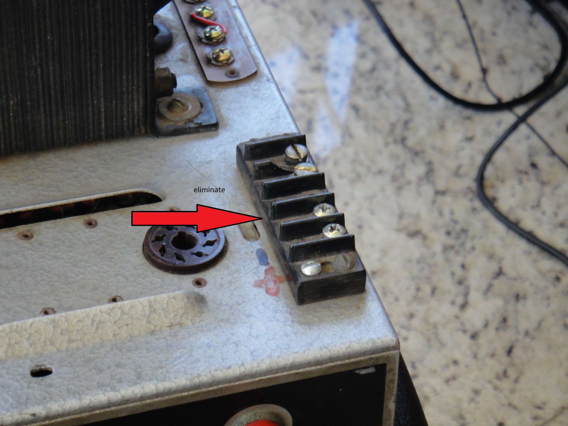

For safety reasons, I'm thinking removing AC and the speaker connectors from top to back as show in the pictures. My heart is suffering with this ....

This is a good idea.For safety reasons, I'm thinking removing AC and the speaker connectors from top to back as show in the pictures. My heart is suffering with this ....
