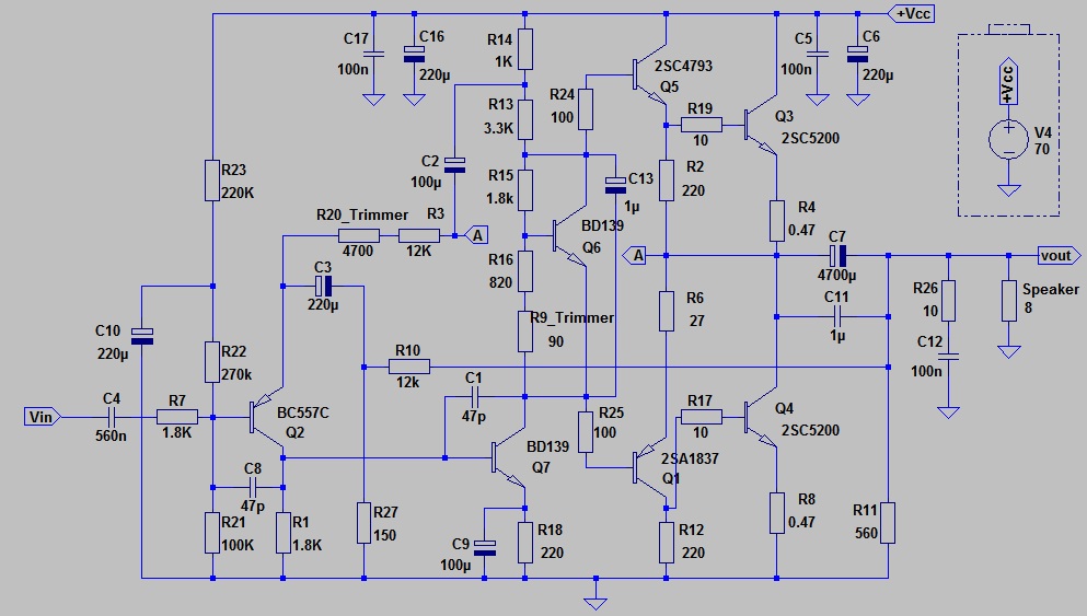

Need help in finding stability margins/loop stability in LTspice for my amp
..................................... That is why the passive input filter, C2/R21, should be selected to define the bandwidth of the amplifier.
Andrew,for passive input filter you mean C4 and R21 ? A ll the other part values (C2,C3,C4,C7) are ok? so what i have to change?
OOPs, yes, C4 & R21 is the input filter.
You have shown an RC value of 2u2F with 1k8 + 100k giving 224ms.
That RC value should be the lowest of all the other filters.
224ms is equivalent to ~0.7Hz
Either make this a higher frequency, or lower all the others to below 0.7Hz.
KSC3503-D has a Hfe classification of 60-120 whereas KSC3503-E has a Hfe classification of 100-200. I have KSC3503-D at the moment as well as BD139,2SD669A (marked as H669A) which i dont know if they are genuine or not. KSC3503-D is original Fairchild. i will test one of them for the time being until i order new parts..
Yes, you are right. In such a case the mid-power transistor should be used. I recommended you KSC2690 since I have some of them (Y-grade I think) and I know their Hfe are 220-240. The other choice could be 2SC4793 or 2SC5171 which can have relatively high betas too.
Coming back to a previous concern about the single pole roll-off filters that are created by C2, C3, C4 C7 and C9. AndrewT stated that the RC value of input filter C4*R21 should be the lowest of all the other filters. How are the other filter mathematically expressed?? The filter created by C3 is expressed as C3*R27.What about the others?

Thanks Andrew.I am trying to apply what you said about input RC value C4*R21 that should be quite smaller of all the others in the circuit so as to define the corner frequency of the amplifier.For the values shown:
C2*(R13//R14) = 76ms
C4*R21= 56ms
C3*R27 = 33ms (C3 has to be raised from 220uF to 680uF or 1000uF for 102ms or 150ms to comply with our rule)
What about capacitors C7 and C9? The load seen by C9 is R18 and that of C7 is R11//R speaker?
