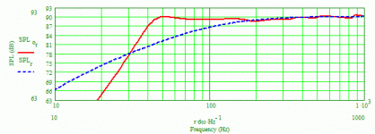

A possibility (ML-TL)
Okay, I came up with something for you to consider. It's an ML-TL that I modeled for ONE driver. The cabinet could be separated in the middle of its depth by a solid divider. The internal dimensions for one line would be 8.5"W x 6"D x 38"H. For the front line, the center of the 7k415 would be located 8" below the inside of the top of the ML-TL enclosure. The center of the mass-loading port would be located 3" above the inside of the bottom, with the port having a diameter of 2.5" and a length of 3.75". The stuffing density would be 0.5 lb/ft3, requiring a total of 5.5 to 6 ounces of polyester-type fill in the top 24" of this line enclosure. For the back, identical line, since that 7k415 would be only for bass, you could turn the line upside down with the driver close to the floor if you wanted, or you could orient it exactly the same as the front line. Since the TB midrange/tweeter will need a separate cavity, that could be created and placed on top of the two line enclosures, separated by a solid divider. If the solid divider that separates the two lines is 3/4" thick, then the total internal depth would end up at 12.75". If a 6" height above the two lines and their divider allows adequate volume for the TB driver, total internal height would end up at ~46". I've attached a graph of the modeled response of the TL. Others may be able to come up with something better.
Paul
Paul

If you want a pretty smooth/flat overall response from the knee in the curve on up, then choosing the optimum overall tuning frequency is critical, and that depends quite heavily on the driver's Qts and Fs. According to the specs for this Focal 7k415 driver that the OP listed, Fs is 32.5 Hz and Qts is 0.26. Those two facts indicate an optimum tuning more than a little bit higher than Fs would be needed. The model I posted had an overall tuning frequency at ~41 Hz. A tuning frequency of 48 Hz for this driver, however, would be unnecessarily high, IMO, likely causing the low end response from 100 Hz down to the knee in the curve to be tilted up, ending up with possibly an unnaturally heavy bass sound (some may like it that way, of course). That's the problem with not being able to model what you design; you can't see the likely response.
In case anyone is interested, the response graph I posted was for an input of 2.83 volts, and I arbitrarily modeled with 0.5 ohms added in series with the driver. I also modeled with Le=zero since that value was not listed.
Paul
Paul
Paul
Was that response from MJKs sheets?
What I've read so far would suggest that a Qts of .26 is too low? And would result in a tuning freq of about 136 Hz. (Maybe I need to hone my methods so far, or read something else?) But I have no idea how that would model or what the roll off would be.
I do like the look of your response though
Yes, I modeled this with Martin's worksheet and posted the resulting system bass response. IME, drivers having a low Qts are always more difficult to work with for a TL, but there's more to it than just Qts, so sometimes reasonably good results do occur. I don't know how you arrived at a tuning frequency of 136 Hz. In a non-folded ML-TL like this, the internal height of the cabinet is the line's length and that length's 1/4-wavelength resonant frequency provides some of the overall system tuning, with the rest of the tuning provided by the mass-loading port's dimensions. In a more conventional line that is longer or longer and tapered, the line's length, as affected by its taper, if any, contributes all of the system tuning. In an ML-TL, being able to model the exact location of the port relative to the driver and line length allows one to maximize smoothness, too. The overall system tuning frequency primarily determines the overall response shape, and the volume contained within the line primarily determines how low F3 ends up.
Paul
