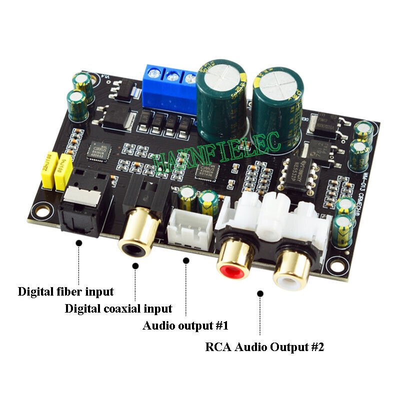

Hi, I discovered that this little board has another problem, that is the board doesn’t automatically switch the input between COAX and OPTICAL as a function of the applied signal; in particular if signals are applied at the same time to both the inputs (COAX and OPT), the analog outputs are ****.
So I decided to use another kind of board, this one
https://www.ebay.it/itm/174332972341?hash=item28970e0d35:g:0zwAAOSwMdVf~WW2
in conjunction with a four input selector (two COAX and two OPT inputs) using reed relays controlled by a rotary switch.
I’m very happy with the result.
