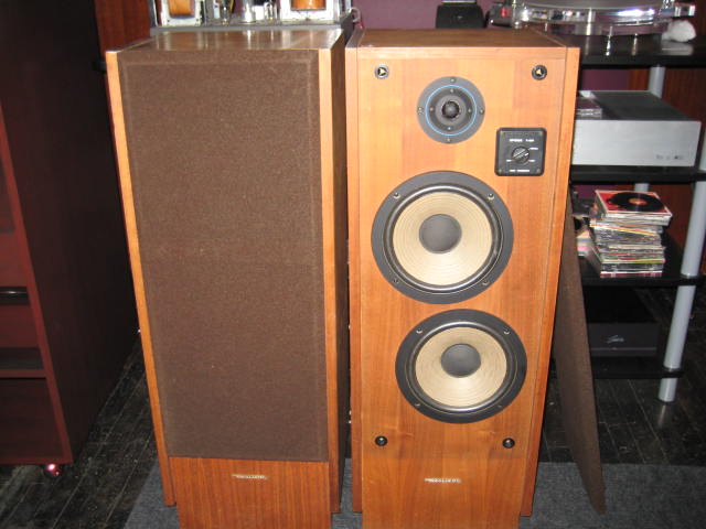

Hello. I have 2 pairs of empty cabinets that i need to finish up. My goal here is to be CHEAP. I like the look of orignal wood cabinets. I understand i could get original drivers but I would like to use modern drivers. The first set is a realistic T-100 cabinet. It originally had 2 8" woofers, a tweeter and an l-pad. These cabinets are mint shape but completely empty. What would be a good setup here? I would need drivers and x-over here. I am not against opening up some of the holes if needed. . I know nothing about thiel parameters and such so i am useless in that area.

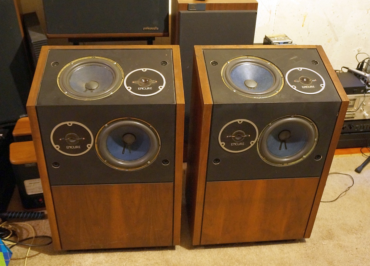

The other cabinets are EPI m201. These use 2 8" and 2 3" tweeters (originally inverted domes). These ones have the original crossovers in them. I have looked at the humansound site and see that he sells an upgraded x-over for these. Looks simple enough to build my own. Again, sourcing originals is probably going to cost more than the complete unit is worth.

Pictures and dimensions help a lot
Especially for those not familiar with the originals, so please measure both the cabinets internal and hole size and post the results.
Bear in mind that a cheap solution may not be possible
the t100 cabinets are 11.5"w x 10"d x 34.5"h. here is the picture.
the other is the epi..
Some info on the original t100 specs
Power Input: 75 Watts max
Frequency Response: 55 Hz to 18 kHz
Impedance: 8 Ohms
System Resonance: 55 Hz
Cross-over Point: 3.5 kHz
Enclosure Type: Oiled walnut veneer sealed for extended bass response
Control Type: Tweeter level control
Enclosure Size (HWD): 36" x 13" x 12 1/2"
914.40 x 330.20 x 311.15 mm
Woofer Size: 8"
Woofer Type: Acoustic-suspension with brass voice coil
Woofer Magnet Size: 10.1 ounces
Tweeter Type: Extended range high compliance
A cheap but still decent sounding sytem would be a Visaton based one.
2 of WS20E-8 and a TW 70 cone tweeter in a 2.5 way closed box
would fit well in Optimus T100 enclosure. The drivers are available
in Visaton Boxsim software for the enthusiastic individuals to work on
their XO filter.
I guess GRS brand of PE store should also be considered a first
choice for a cheap system, but without any measurements available,
remains cloudy.
