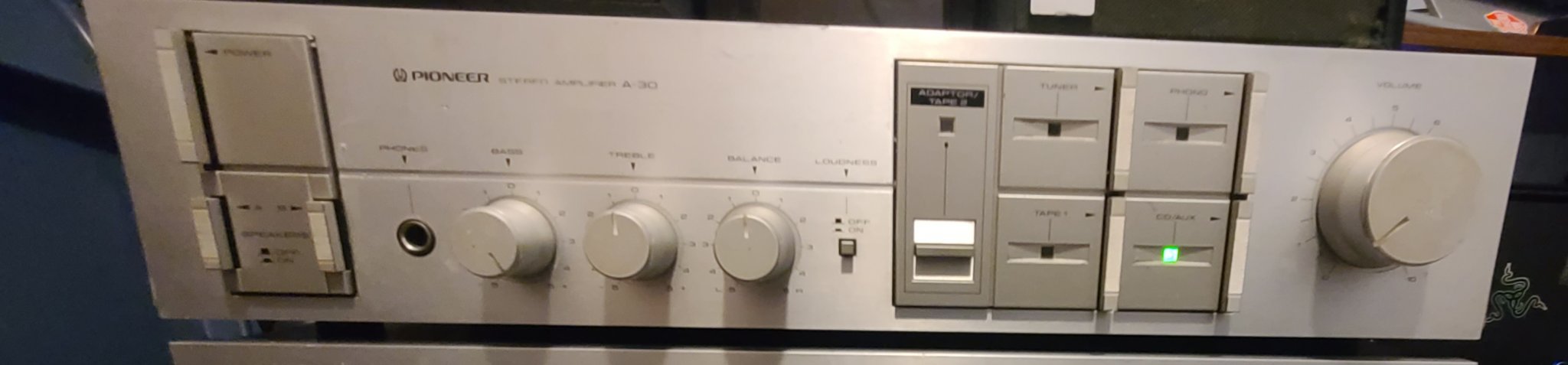

Need help finding a replacement potentiometer for a Pioneer stereo amplifier A-30
I don't know where to find one it does need to have a loudness Tap the potentiometer has the writing ACT-171-0-100KB1X2 411N on it any help would be appreciated ive been looking for a few weeks now 🙁

A mention once of what model amp this is turns up several Pioneer "A-30" versions, making diagnosis confusing.
Perhaps a clear photo of the whole front panel to determine exactly what this unit is, might be helpful.

That model A-30 is identical to the SA-740, service manual here. https://elektrotanya.com/pioneer_sa-740_audio_amplifier.pdf/download.html
But you still haven't explained why you think the potentiometer is defective and needing replacement.
If it's just scratchy or intermittent, a quick spray of Deoxit contact cleaner usually cures that problem.
Please explain your needing to go through replacement.
