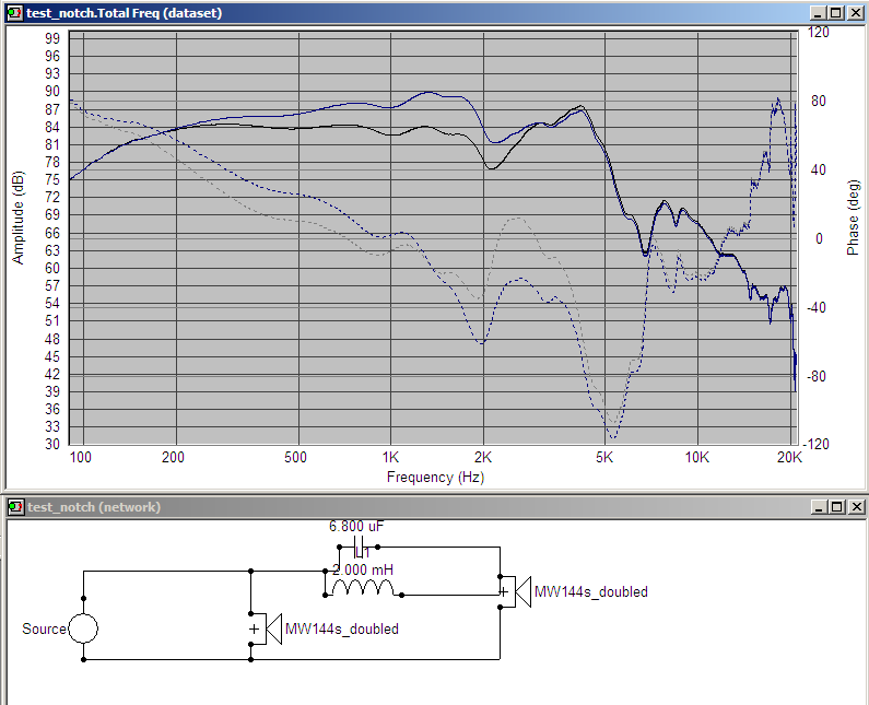

I found the network interesting so I decided to model it using my MW144's response (which have a peak around 4Khz). The attached shows two mw144's in parallel with no crossover components, and the blue is with just a 6.8uF cap and a 250 micro henry coil as per the schematic. The coil value was chosen at random, which makes the result even more suprising!
The notch is effectively taking out the peak. It is interesting because I have a notch in my crossover, but it is in series with Both the drivers, and has quite different values (actually this is probably because I didn't scale the impedance, the "driver" I used originally is actually both in parallel, so what I have just modeled has 1/2 the impedance to what it would in reality..

That is interesting. Try it with a coil around 2MH please ? That's just my guess as to about how big the coil is in the DCM crossover.

Interesting! I doubled the impedance of my drivers so that it was closer to reality and the result is that it pretty much eliminates the baffle step. So my guess would be that it is being used as Baffle Step Compensation in your speakers (the sim result is only valid for my actual speakers which is all the more bizarre) but whatever value your coil actually is is no doubt tuned to your speakers 🙂 for what it's worth my baffle is 201mm wide.
Attached is the comparison between raw drivers and with the notch using 2mH. I used a DCR of 0.345 ohms (14 gauge).

Why did you double the impedance of your MW144's ? Aren't they 8 ohm drivers ? The woofers in the DCM speakers are 8 ohms each, run in parallel for 4 ohms net.

Reason I doubled it was because the the impedance measurement I have is for both drivers in parallel. and the modeling I did for my own crossover treated them as a single driver 🙂
Yes they are nominally 8 ohms so doubling the value brought it back to square.

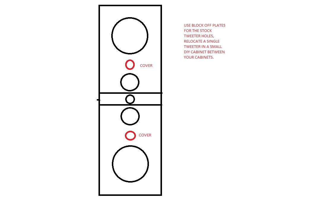

So where did this end up Blake if you don't mind my asking?
I have 4 KX12's and curiously thinking about modifying them into 212's...
The KX-12 cabinets have more cabinet volume per driver than the KX212's have (which is good), but the line length is shorter, so they are tuned a bit higher.
My suggestion is to do the mods I listed above, but stack your cabinets like this. The main issue you are going to have is that the KX-12 woofers are 4 ohms, unless you have the Series 2 set which are supposed to be 8 ohms. You will want to look and see what the drivers are, as I have seen Series 2 woofers that are actually the same 4 ohm drivers as used in the Series I set.
