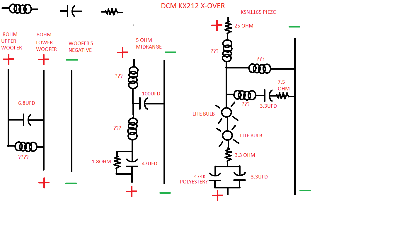

Look again at the woofer crossover portion. I'm still somewhat confused by it.
The one woofer is directly connected to the input terminals, but has a capacitor and a coil connected to (and supplying the input for) the second woofer.
The only way I see the first woofer having any high frequency attenuation is via the 6.8ufd cap , but in order for it so have any high frequency shunting effect , it first has to go through the coil of the second woofer to get to ground. So in effect the first woofer has a low pass consisting of a LC circuit shunting to ground, with the "L" of the LC circuit being the second woofers VC.
If that is the case , then the first woofer's high frequency response is barely attenuated at all, correct ?

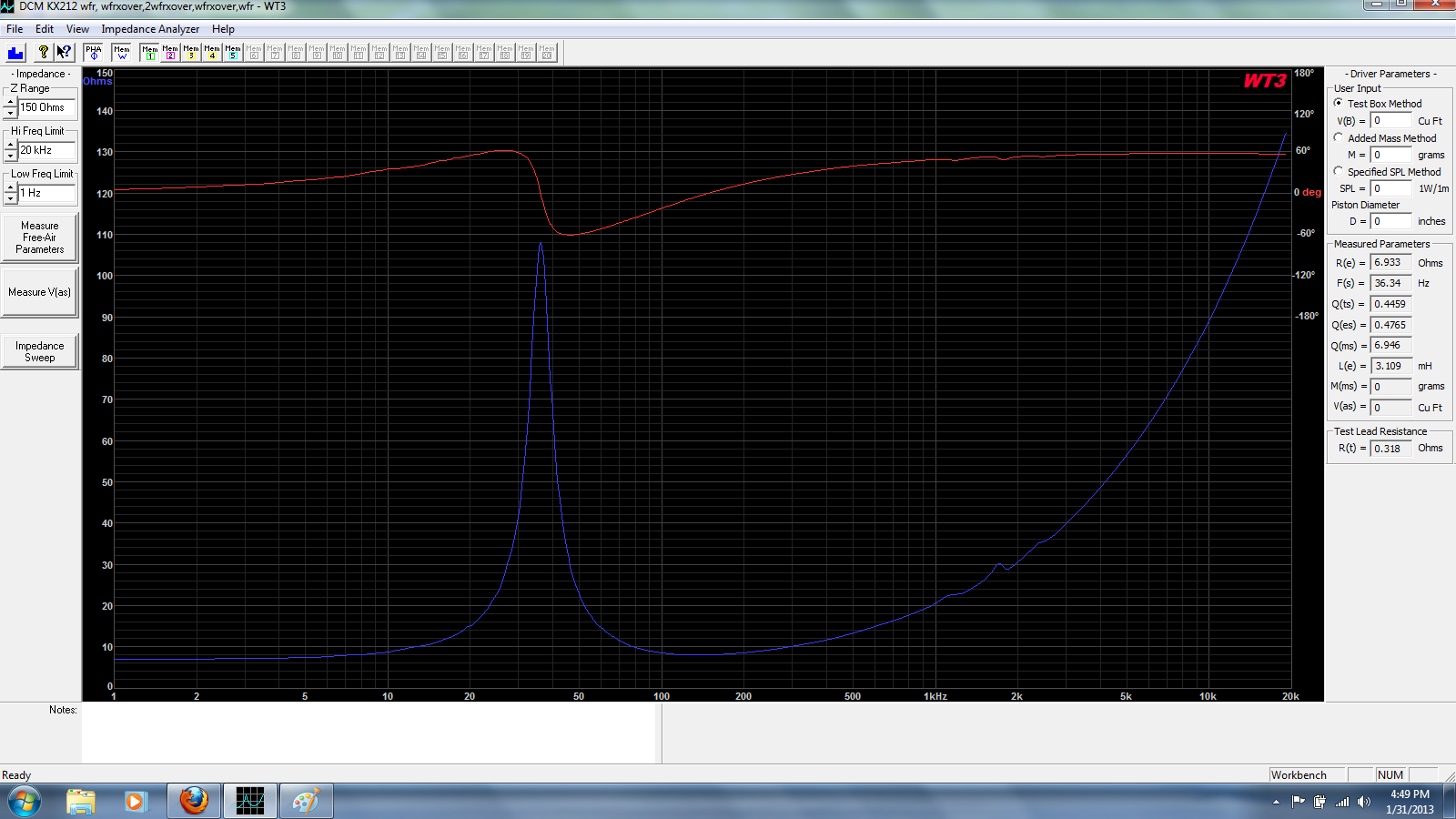

Here are the impedance traces of the drivers.
The tweeter has two sets of traces , the red and blue traces are just the raw piezo, and the lavender traces are with the crossover connected.
Again, thanks for any help understanding the woofer circuit better.
.............................Blake
I would expect the second woofer to be driven pretty much full range. I hope it has very low Q breakup very high. The woofers Le would be dominant.

Really, as we don't know the inductor size, we have no way to guess if this is a notch filter or a bandpass filter. I would really suspect this is a 3.5 way design and this is the bandpass for the second woofer.

You suspect what is the bandpass for the second woofer ? The 6.8ufd cap connected across the two woofers + leads ?
I don't understand how it could be a bandpass filter. AFAIK, a bandpass limits the low frequencies and the high frequencies , leaving the pass band/band pass.
You think they are limiting the low frequency response of one of the woofers ?

The L-C has basically no effect on the second woofer. It is going to be a notch acting on only the one.
200mH is about 135 Hz, 2mH is about 1500 if the woofers are anywhere near 8 Ohms. So says Spice.
The L is a lowpass for the one woofer, while the C is connected to both woofers + terminals. How could the L be a notch filter ? How could the cap not affect the direct coupled woofer (not the inductor coupled woofer) , it is going to do something to both woofers .

The L and C work together as a resonant circuit. Basically at some frequency, all the energy gets passed between them instead of being passed to the first woofer. Above that frequency all the energy goes through cap, below through the inductor.
Cover up the second woofer and look at it that way. That may help visualize. Again, I recommend downloading one of the Spice circuit simulators and play with it there.

If above a certain frequency, all the energy goes through the cap, where does it go ? The only thing the cap is connected to is the woofers. It's not like it is shunting to ground. The only path to ground is through the woofers voice coils.
I understand that at a certain frequency, the cap is a low resistance path, lower than the resistance/impedance of the voice coil, but if the path only leads to another voice coil, then what is gained ?

After thinking about what you said, I think I may have an idea.
Woofer"A" is wired full range, and always runs that way. Period.
Woofer "B" gets it bass frequencies through the inductor, up to the crossover point of the coil. Lets just make up a frequency here and say 200hz. So, up to 200hz, the coil offers a low resistance path to woofer "B". At 200hz, the response rolls off at 6db an octave. So at 600hz, we are -15db(2 1/2 octaves). Once we reach the frequency where the cap is tuned, lets say 600hz, it starts conducting , so at 1200hz the output of the cap is even , not plus or minus.
So woofer "A" gets bass help from woofer "B" , woofer "B" gets choked out for a while and then starts helping again above the crossover frequency of the cap.
Is that how you understand it ?

You are getting close. The L and C don't work independently, they are a tuned resonant circuit. It is a little hard to visualize. That's why it is easier to learn basic circuits in a lab course. Next best thing is a simulator. Of course, they did not have them when I went to school. Stick with it, you are doing what so many here won't. Thinking.

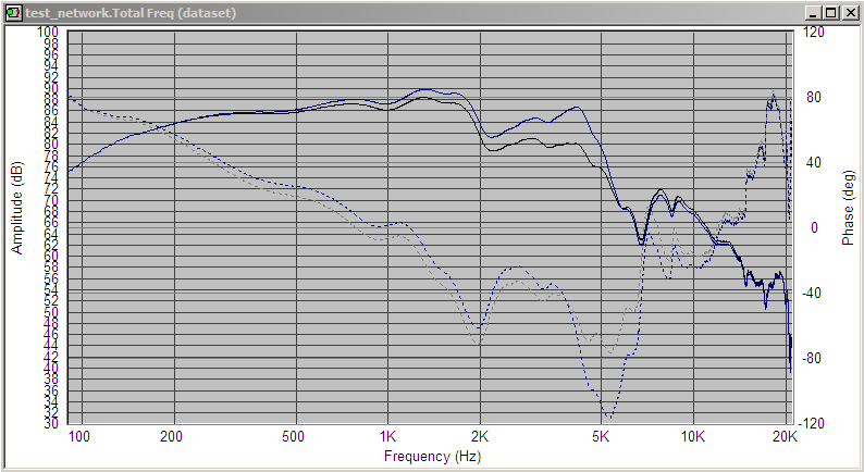

I found the network interesting so I decided to model it using my MW144's response (which have a peak around 4Khz). The attached shows two mw144's in parallel with no crossover components, and the blue is with just a 6.8uF cap and a 250 micro henry coil as per the schematic. The coil value was chosen at random, which makes the result even more suprising!
The notch is effectively taking out the peak. It is interesting because I have a notch in my crossover, but it is in series with Both the drivers, and has quite different values (actually this is probably because I didn't scale the impedance, the "driver" I used originally is actually both in parallel, so what I have just modeled has 1/2 the impedance to what it would in reality..
Tony.
Tony.
