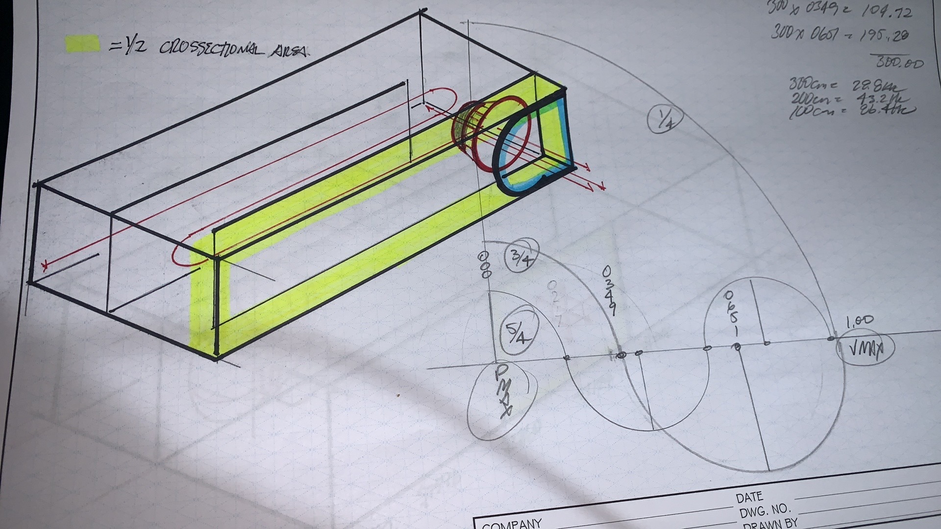

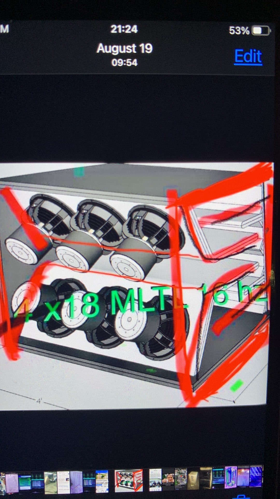

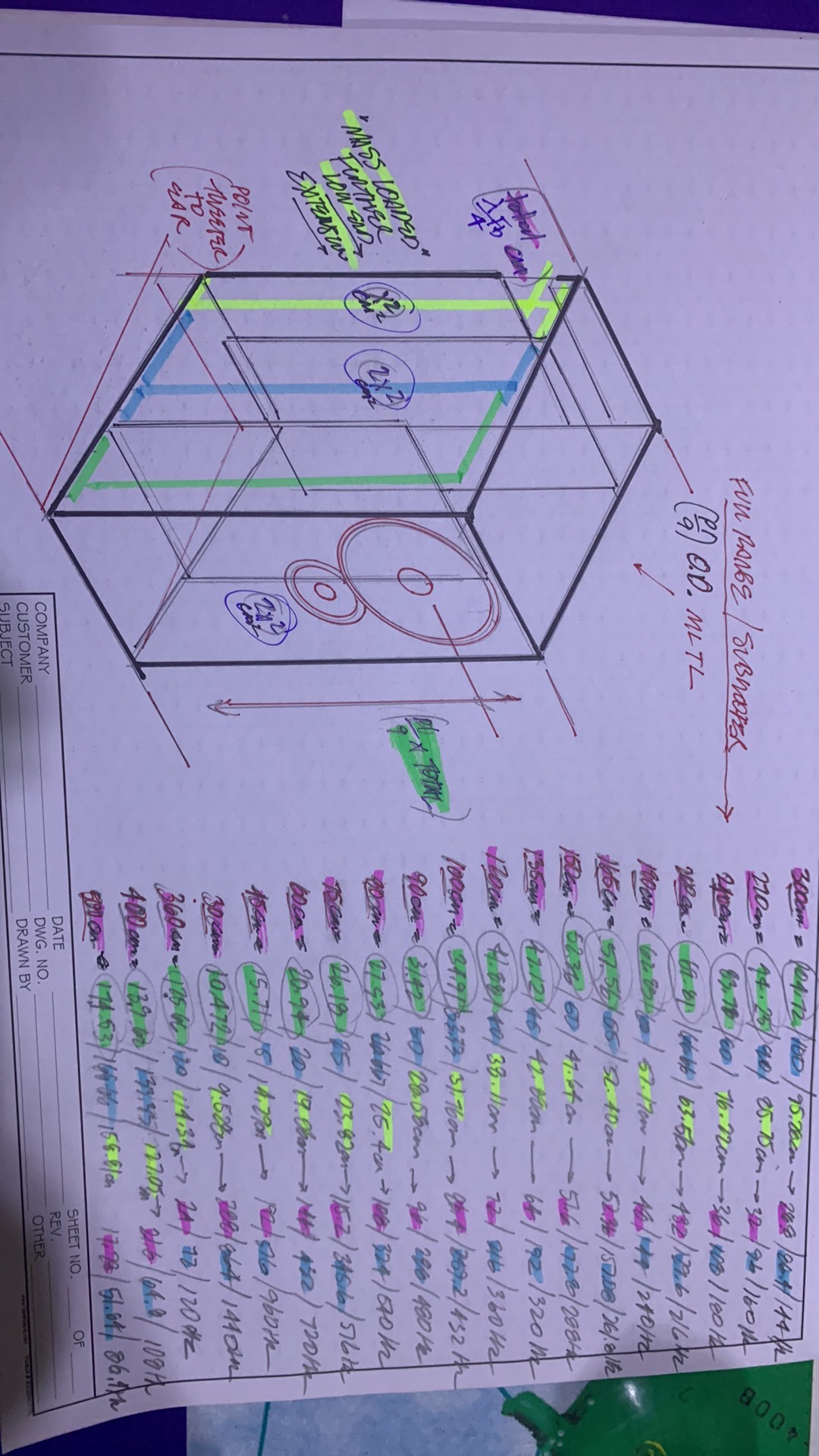

in the link below you can find 2 design options for a TL. I would also suggests to check the MLTL options too.
https://freeloudspeakerplan.rf.gd
If you don't know how to design, it's not a problem, just change the dimensions, export hornresp data and check the results. Everything is automated and focused on new users. Doing the loop twice, three, four times, you will start to understand how it works and people can help you to optimize the results.
You will need some woofer Thiele / Small parameter in order to run this process.

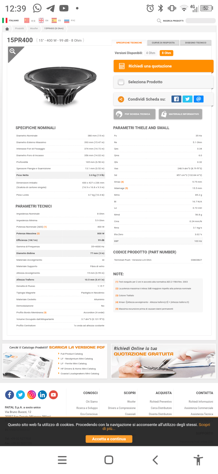

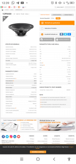

Can Go lower if not using large input voltages, but limited xmax @ ~6mm. A bit more pronounced ‘knee’ if you jump to 1500/750 cm2 as wellCan you calculate a TL box for this woofer? Thanks in advance.

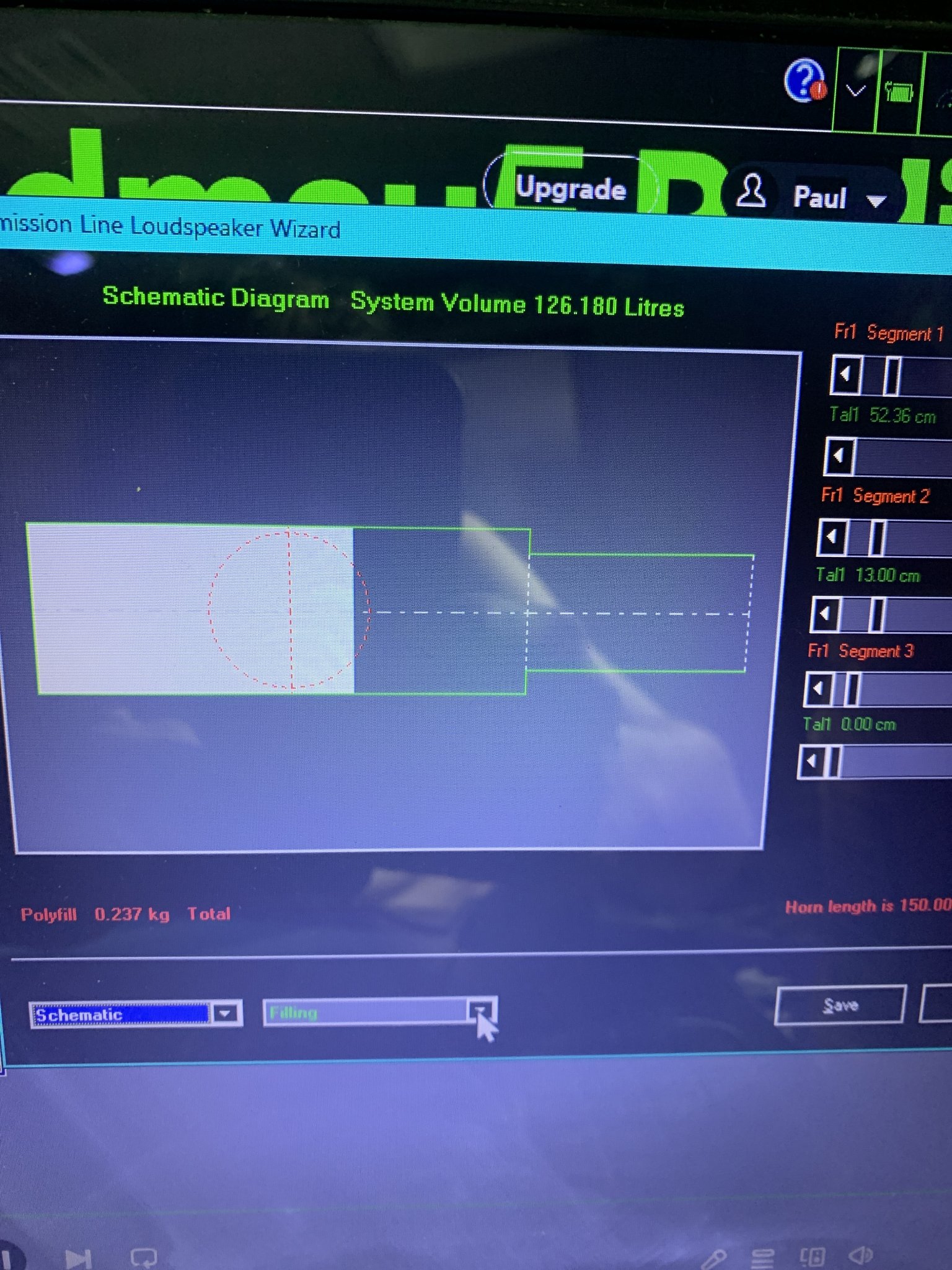

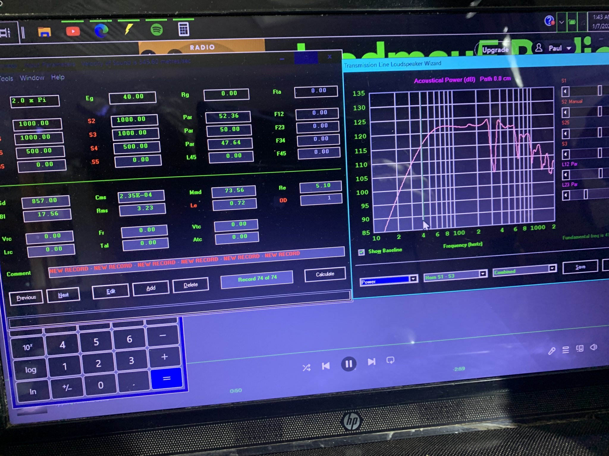

NEVER fails to deliver. Get it close to the 3 xFb freq in offset and stuff it a bit around the driver to avoid any hiccup
TLs output from both ends - so they are efficient in that sense. And so they can use smaller drivers and the whole cab becomes smaller. And being loud you have the freedom to stuff more stuffing into the pipe and the more stuffing the better the sound.
