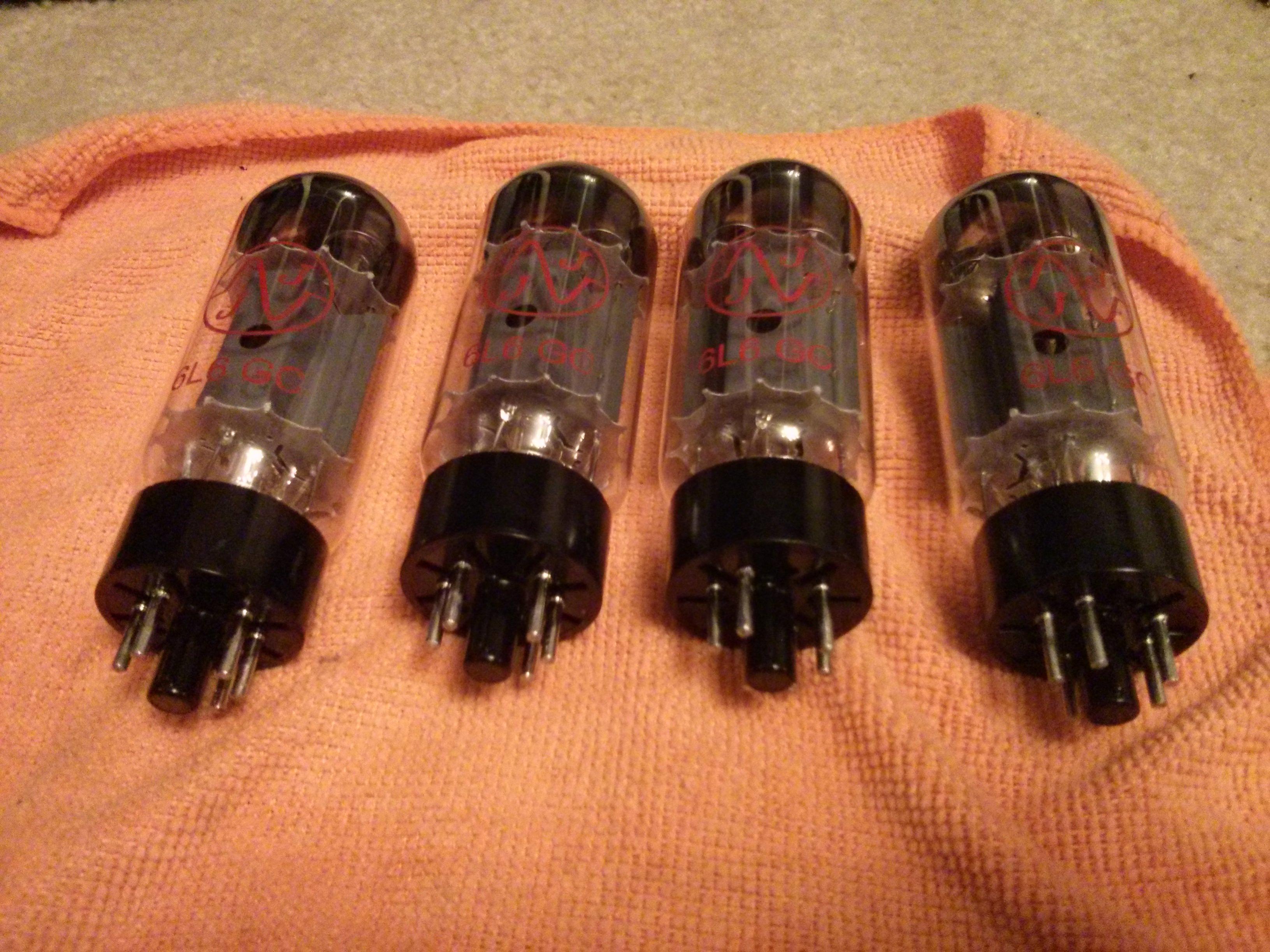

See attached photo of tubes. They look identical to my eye.
The identical thing was to see if one was cockeyed. If the posts are intact, then they were likely in correct. If I look at a row of tubes and see the innards all facing the same way except one, I can expect that one to be in the socket wrong usually. It wasn't that I expected the insides to actually look different, just looking like they faced different ways in site. In your photo, you have them lying there with pin 1 at top, and inside the tubes, all of them have the hole in the plate facing up. If I had seen four tubes with the hole facing me, I'd be happy, if I had seen four tubes with one facing its hole sideways, I'd suspect the tube was turned in its socket. Enough on that, it does not appear to be your issue here.

You can check the tubes at their pins with a meter, and it MAY show up a short, but some tube shorts only happen when the tube is hot.

Pulled power tubes and powered on with main board connected to power tube board. Bulb glows dimly. Reconnected all PT secondaries (still no power tubes in) and powered up again. Bulb flashes brightly, then settles to a dim glow. I measure ~5.2VAC across pins 2 and 7 of the power tubes. I assume this 1.1 VAC drop is due to the bulb limiter.
Looks like I have at least one bad power tube. Should I insert them one at a time to find which one causes the short condition? If only one is bad, can I replace it by itself, or do I need a matched set? I assume I'll have to rebias regardless, correct?

You COULD find the bad tube, and replace only it, but really, it is probably best to put a fresh set in there. A matched set is not required, they are not manufactured with matched sets. The amp will not care. I buy matched sets because the cost is at most a dollar more a tube, and often is no different. Matched tubes will better cancel ripple in the power stage.

Installed new power tube set: bulb stays lit after power up, power tubes don't light up.
