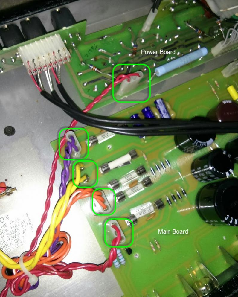

The only setup differences (apart from the signal generator vs guitar + cord) since the problem started were disassembly of the head and a change of power outlets.
I'll periodically perform the test again, but it's hard to troubleshoot if I can't reproduce the issue.

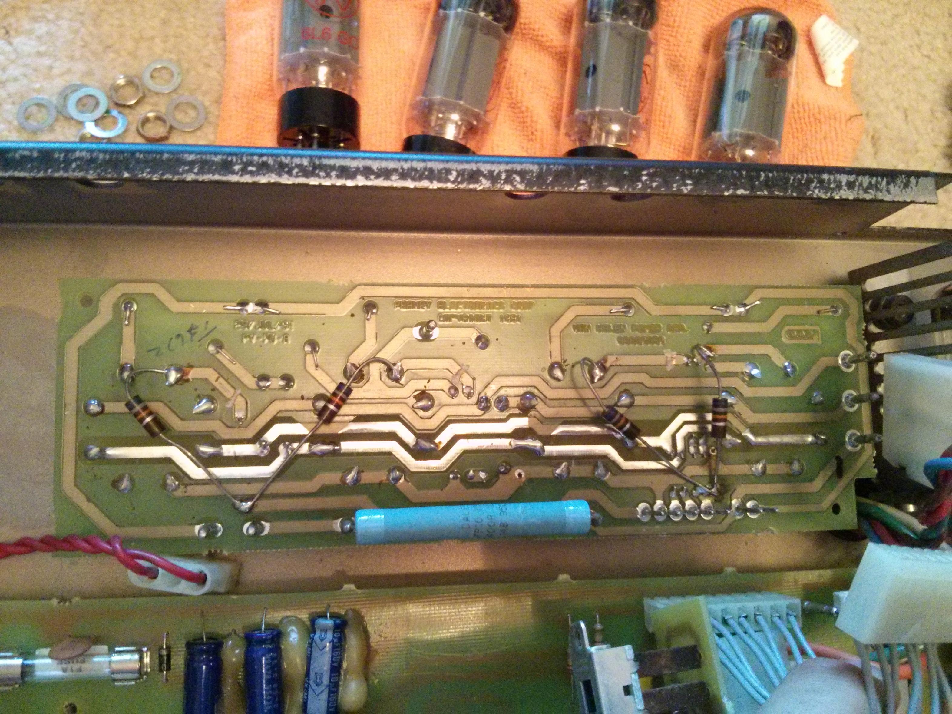

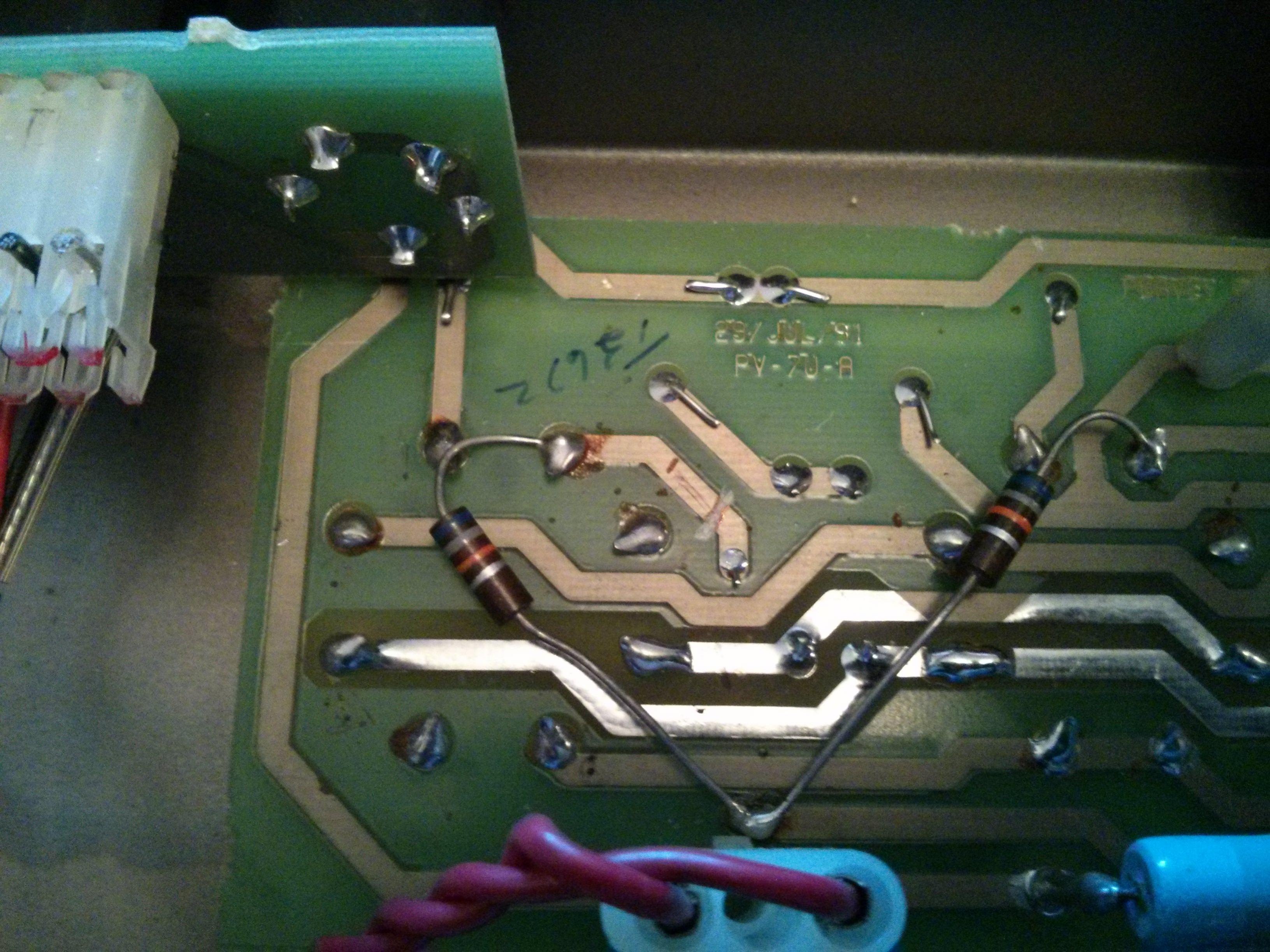

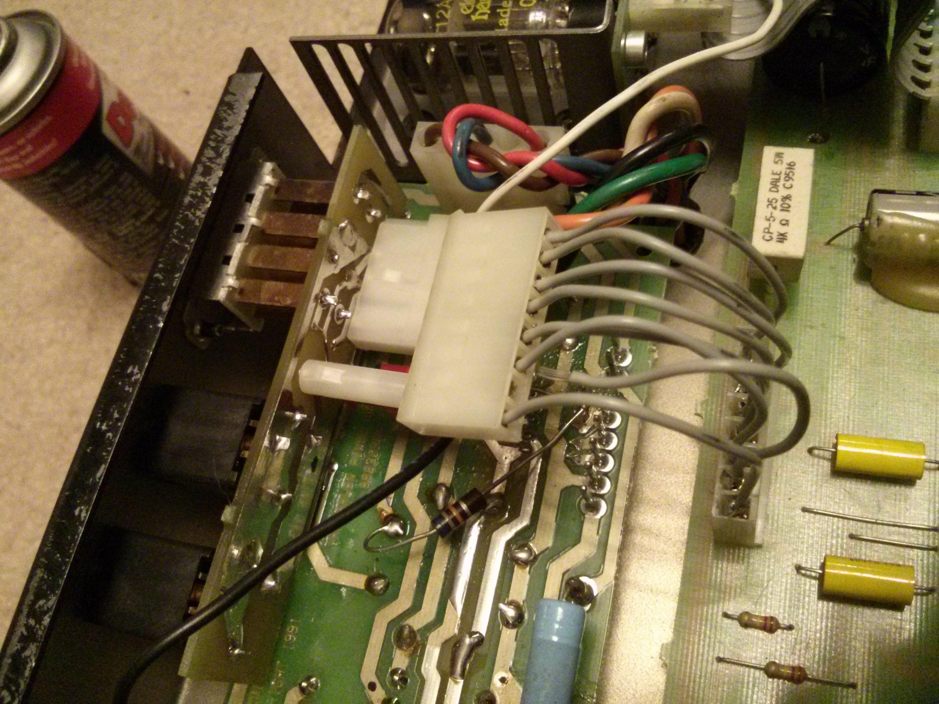

My next step is to reflow all solder joints on both boards, but I'm shooting in the dark now.
