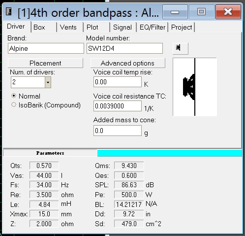

You can download a program called "WinISD" by Linearteam. Its awesome for free software. It will allow you to add your speaker ts parameters and help you design an enclosure. Its a handy lil tool I refer to from time to time. If you have any questions about the software. lmk

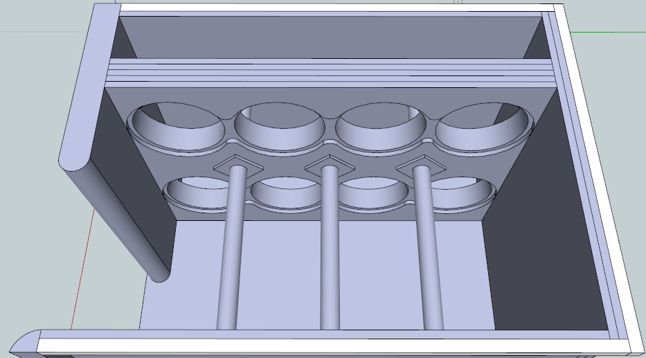

Usually for a 4th order your looking for around a 3:1 or greater ratio. This is the 4th order I'm building into my Safari for this year.

I did try using this software in the past but it was kind of technical for me, I do have most parameters from Alpine but was still confused as far as the entries I had to put on the program, I will give it a try again and see where I get stuck and come back to you.
My Alpine driver is not on the database so I went ahead and started writing my subs info, I have entered most fields but not sure how to go about entering under Re that is a dual voice coil sub 3.5ohm+3.5ohm, do I just enter 3.5? then I don't know what goes under Pe, BL, Dia and Sd? Thought you could help since you might be familiar with the program.
You might have to just save what it'll let you then go back in an change them after selecting the driver. Turn off Auto fill and be sure to change # of coils to 2 and coil config to parallel. It looks like BP4 is your best bet.
Thank you for the info, I am still so lost, I went ahead and entered all the parameters from the spec sheet that came with the subs an entered the others you provided on the table you posted, but for some reason my tabs and menus dont seem to be the same, I dont even see AUTO FILL or how to change coils to parallel, I am soo lost
