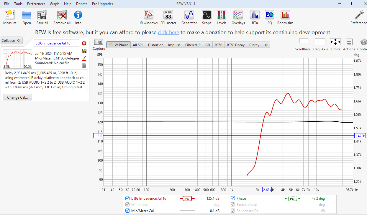

Need help again … this time with this HiVi planar tweeter
I've got just about everything else figured out now. Thanks to everyone who has been helping me so far.
I have this HIVI planar tweeter whose frequency response is just nutzo. I have seen this when attempting to use planars with traced data and thats why I usually avoid them. This time I took a chance because it seemed people like these a lot.
https://www.parts-express.com/HiVi-...mXZCI_35z_JCkaqh9T4PSTB3WzmOOd2xoCWmwQAvD_BwE
I'll attach the raw REW measurement data
Basically I have this huge peak at 9k. I guess I could try to take care of it with a gigantic notch filter but I have other peaks and valleys. This is pretty far from a flat response. Its also wayyyyy more sensitive than the other two drivers. I'm going to need a beefy lpad to tame this beast.
Is there something wrong with my measurement or is this just what it is?
PS. I just started the crossover like 5 minutes ago so thats why nothing is even close to right at the moment

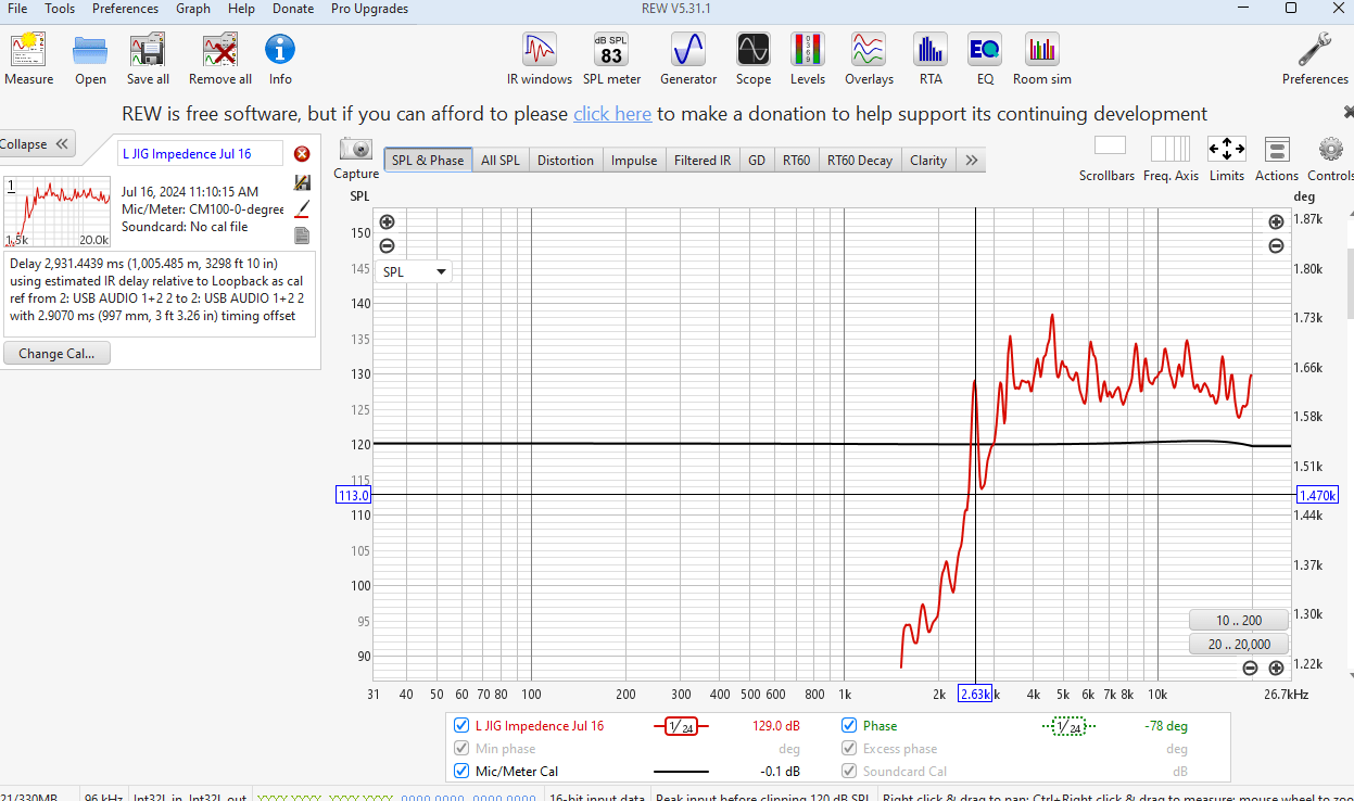

I did adjust gating

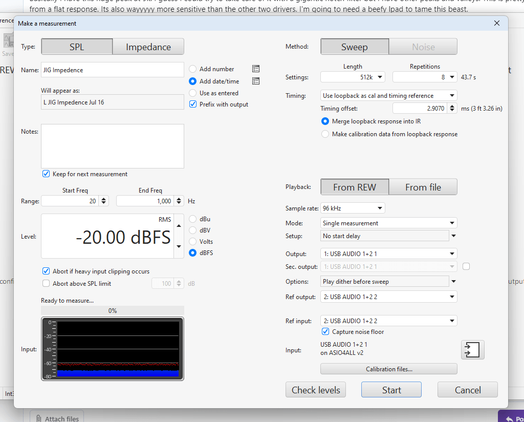

There should a timing offset of 2.9070 ms. All of my far field should have this baked in. I see the delay now. It is different for every measurement. Is this set up incorrectly? Its very possible I didn't have it set correctly. I'll add a screenshot of what the measuring parameters should have looked like. I'll add some more Mdat files. These were all taken with the same parameters without moving the mic at all
I don't use REW, so don't know if this applies to your situation, but I did notice this excerpt in the manual when we were discussion nearfield measurements in the other thread:
https://www.roomeqwizard.com/help/help_en-GB/html/makingmeasurements.html
"Warning: some interfaces do not maintain sample synchronisation between the successive sweeps which produces a corrupt measurement that has multiple, closely-spaced peaks of approximately the same level in its impulse response, 1 peak for each sweep. This can also happen if the input and output are on separate devices. If the frequency response with multiple sweeps is significantly different from the response with a single sweep, stick with single sweeps"

Small peaks and dips are pretty common in planar drivers. Most manufacturer data has quite a bit of smoothing applied to even that stuff out.
Moving the microphone slightly often changes those, which is why Stereophile's measurement method includes this: "anechoic response on tweeter axis at 50", averaged across 30° horizontal window." The spatial averaging helps even out location-specific artifacts that aren't representative of the speaker's overall balance.
If you can't get averaging to work properly, just ignoring some of this stuff is OK too. That's one of the reasons the smoothing options are in measurement software. Very narrow peaks/dips are often inaudible, but make the response hard to judge. If you have something that shows up in a 1/3 octave smoothed response, that's more of an issue.
Your smoothed response does seem to have some periodicity, which makes me wonder if there is a reflection or diffraction effect causing some of it. Another reason to move the microphone around a bit and see if that changes.
Another thing of note is that your level appears quite high in the last graphs. Most measurement microphones start having issues around 120 dB (can be more or less, so staying below 115 dB is typically a good idea). If your dB axis is correct, you're beyond that.

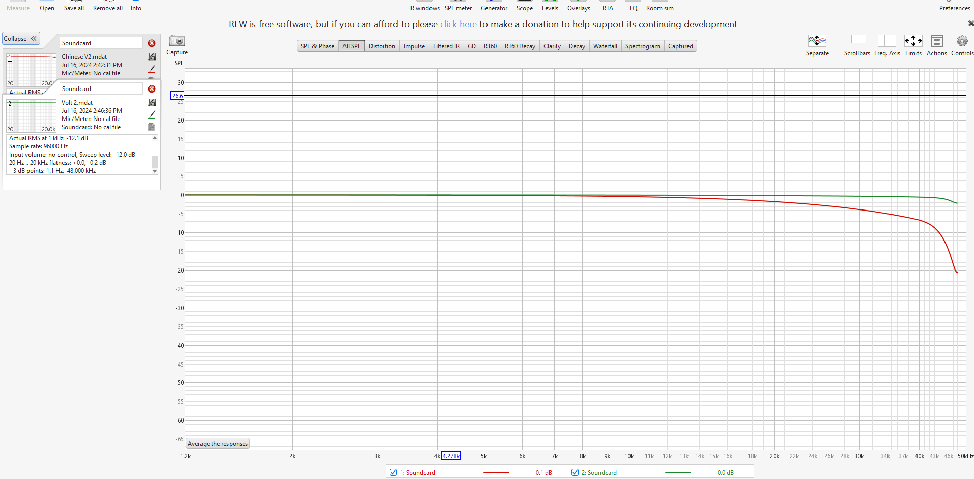

What is your measurement set up? Which microphone and interface? I used a behringer measurement microphone for a long time and always had excessive top end. When I bought an earthworks the measurements were much better and matched the manufacturers stuff almost perfectly.
I think I figured it out. I had a high end audio interface sitting around that has proper ASIO drivers so I tried that out. I still get a little bit of a peaky response but with some smoothing I am getting exactly more of what I expected.
If you take a look at the top end of the cal files for both of these audio interfaces you'll see the cheaper one i was using drops off around 8khz. The high end one stay flat until about 40 khz.
This cheaper interface (still $130) was interfering causing those big peaks.
Lesson learned
