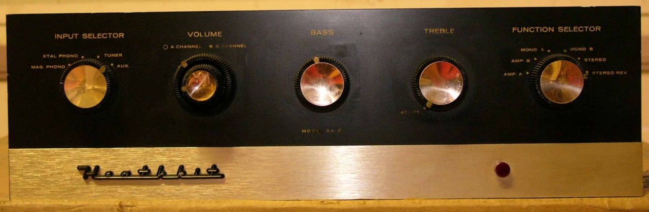

Hi all.......I need to address issues with a newly aquired sa-2 4xel84 integrated and while I'm getting in over my head and should have a tech do it, I am seriously unemployed and can't afford to and the bill would be several times what I paid for the amp to boot....so any help would be fantastic. I've got several issues and will list them from most pressing to least since I suspect I won't be able to get enough info for every last one. But i'm hopeful !
1. I seem to have some kind of 'runaway bias' maybe or some other problem with one of the el84's 'going red'. It doesn't happen all the time, but just comes on all of a sudden. I do know one of the 3 el84's doesn't match the other in terms of what it pulls and haven't forked over the $ for a new mateched quad yet, but just wanted to address any caps that may be associated with bias to see if that helps. The one in the pic here directly to the el84 pin has already been swapped for new and problem still exists....Is this the bias cap? or not? or are there others?
2. I'd like to change the 'sweep' or frequencies the bass and treble knobs affect. Specifically, I'd like them each to affect further on 'below' (bass) and 'up (treble) than they do now so they don't affect the mids and vocals. I am guessing/hoping, it's a simple matter of altering the values of the caps and/or resistors coming up to the pots as seen in pics below......but I know it's usually not that simple ! just hoping again....

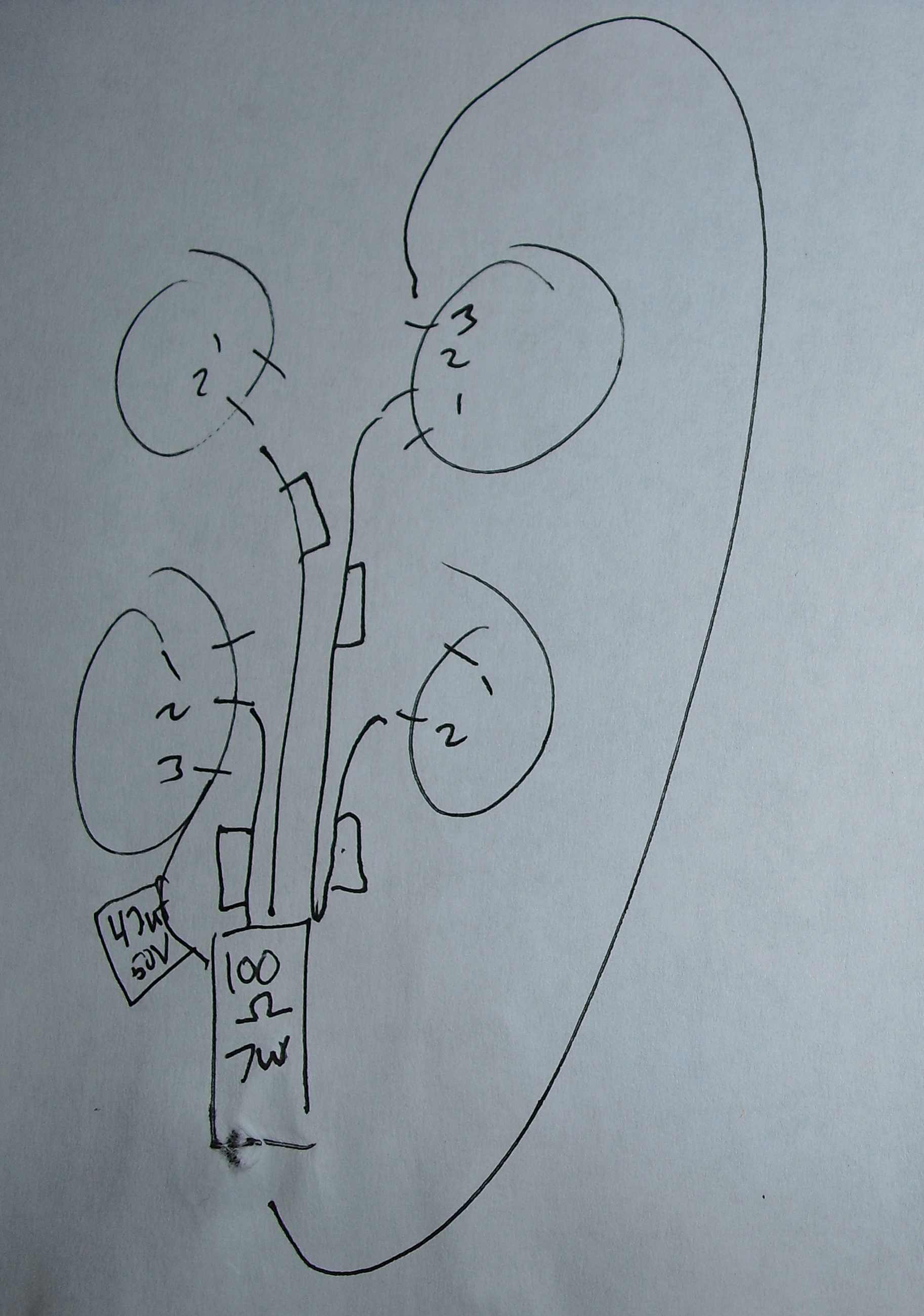

C20 and R33 form a bias network shared by all 4 O/P tubes. That requires all 4 EL84s to be closely matched. Switch to separate bias networks in each channel, which eases the matching criteria to pairs, instead of a quad. A 150 μF./50 WVDC cap. and 200 Ω/5 W. resistor in each network will do nicely enough. Part of your bass woes may be related to too small a cap. in the bias network.

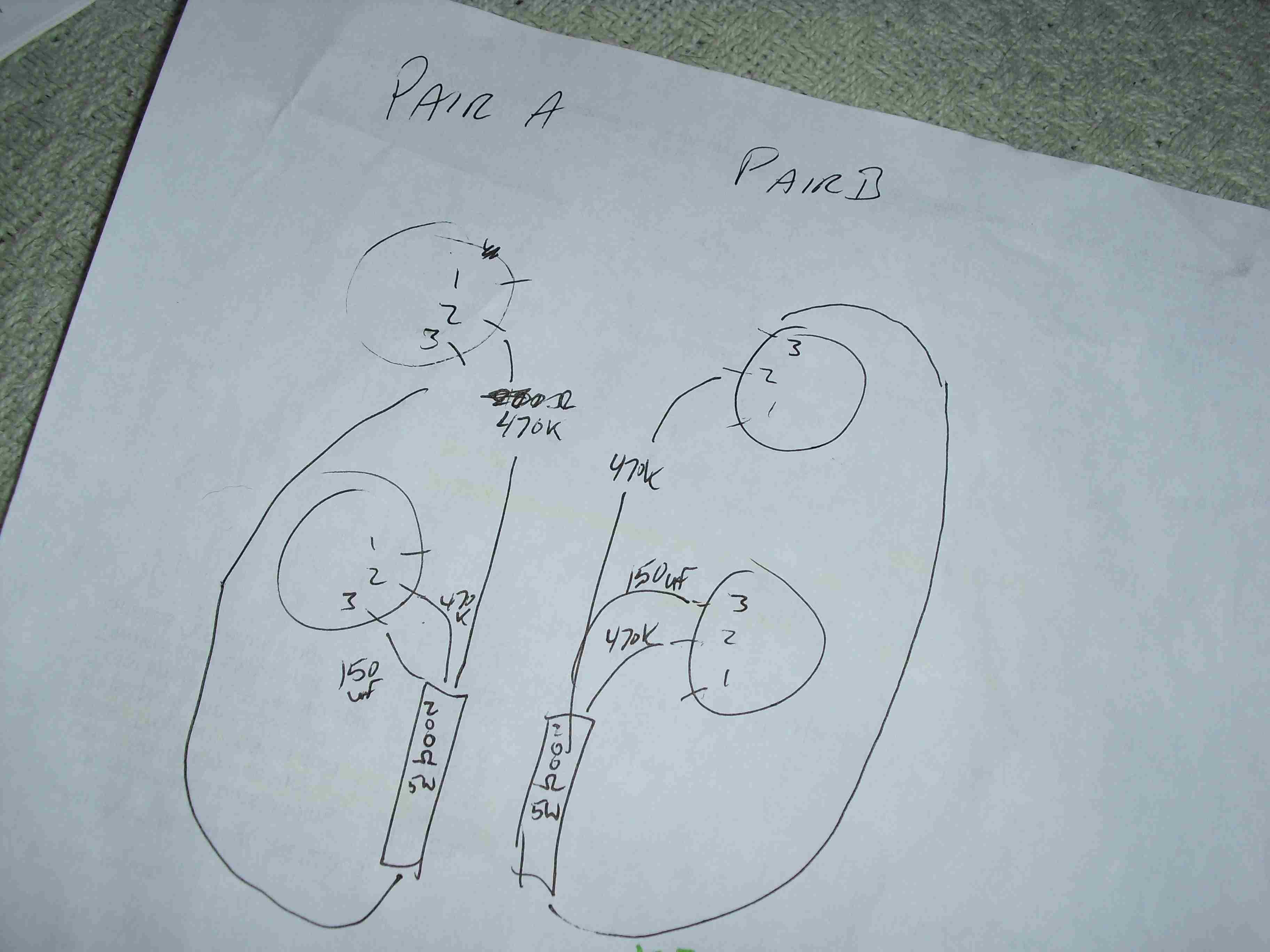

2. regarding separating the bias section into 2 parts. I like the idea.
the makeshift diagram below, is what is there now (4 x 470k coming from each pin2 and 1 x 47uf from a pin 3, all going to one end of a 100ohm/7W and returning out the other end to a pin 3 of opposite el34 pair......Not sure how I'd separate the pair with your suggested 150uf/50v and 200 ohm/5w
Would each pair get that setup sounds like?
Not sure how to go about that?? the 2nd diagram?
Look at the schematic again. Discard the wire between the 2nd set of EL84s and the existing bias network. Replace the existing bias network with 1 set of parts of the new values. Install another bias network of the new values at the 2nd set of EL84s between the junction of the 2X pin #3 and the junction of the 2X 470 KOhm resistors. The 2 channels look alike.

I wasn't able to understand and figure how to separate into 2, so I assume the above values still are appropiate in the 'all 4 tubes biased the same' scenario.
Using a seperate bias network for each tube has its advocates. IMO, that overlooks the fact that well matched tubes have slight differences, which are likely to increase over time. Having each PP pair share a bias network compensates for the minor differences between tubes.
Let's see if I can narrate what is necessary. For each PP pair, a wire connects between pin 3 of each socket. Connect the + terminal of the 150 μF. 'lytic to 1 of the pair's pin 3. Connect the - terminal of the cap. to the signal ground bus. Connect the 200 Ω resistor between the pair's 2nd pin 3 and the signal ground bus. Both of the PP pair's 470 KOhm resistors connect to the signal ground bus too.
Speaking of those 470 KOhm resistors, they should be replaced by 1% tolerance metal film parts. Noise is reduced and accuracy of the high pass pole "corner" freq. is increased.
