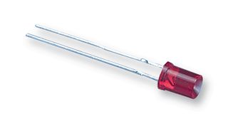

Hi TheGimp,
The image I used is a fair representation of the leds I have in my goody box. If it's not a fair representation of what's in other peoples goody boxes then it follows that my advice is of limited value.
I do tend to buy leds made by Kingbright from farnell which might make my goody box unrepresentative. ( I like cheap stuff 😀 )
Brgds Bill

Sooner - Well you blow the theory that the larger flag inside the LED is always the negative. In that square LED its the POSITIVE! Wow. Something to keep a mental note of when one cuts the leads.

From the photo the longer lead goes to the larger flag. Not that way in real life?
I have to agree that the photo looks like the longer lead goes to the larger flag.
This photo is from Farnell, I don't have this led to check it's polarity.
It only takes one manufacturer to do things differently and always suddenly becomes sometimes 🙄
